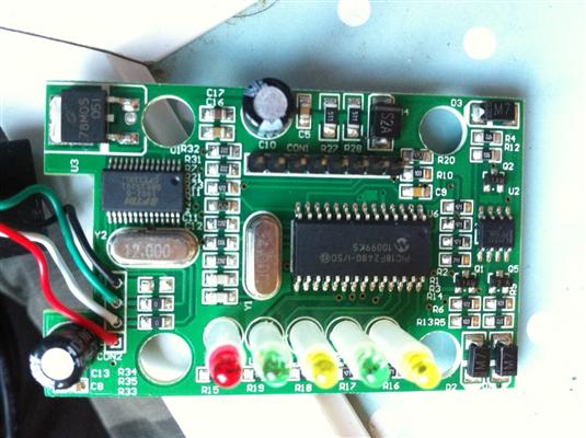

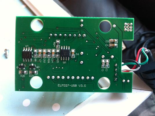

So did anyone come up with a solution to make the 'ELM327-USB V3.0' Work yet?
Soldering and removing R04 does not work with this layout?
photo(5) (Custom).JPG (31.53 KiB) Viewed 12218 times
photo(4) (Custom).JPG (44.17 KiB) Viewed 12218 times

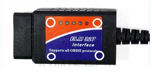

Hi, I have just hit this problem. Just wondering if I'm missing something, tried all sorts with my cable to get it open, but I can't.. What's the procedure for getting the casing open so I can see the chipset?
Thanks in advance, really hope I can get the cable working properly.
fewleh wrote:Hi, I have just hit this problem. Just wondering if I'm missing something, tried all sorts with my cable to get it open, but I can't.. What's the procedure for getting the casing open so I can see the chipset?
Take off the label (on the label is written ELM327 interface - Supports all OBDII protocols) and under it you will find 4 holes with 4 screws...
Just unscrew them and that is it... ;) See the photo...
ELM 327.jpg (32.61 KiB) Viewed 12128 times

EXCELLENT :) Thanks... if only I knew it was that easy, before I smashed it all up :D

Alba_Skye wrote:So did anyone come up with a solution to make the 'ELM327-USB V3.0' Work yet?
I have the same problem, please help

Hello, I just wanted to thank you, i bought a Chinese-made ELM327 Bluetooth v1.5, had the same problem, only connected to ECU, now i desoldered R04 and all CAN systems work perfectly...
Thanks again, if it wasn't for you probably i'd have bought another interface...
