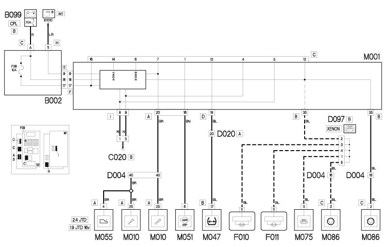

CAN network in power steering is used to send many parameters for steering ECU (actual speed, rotation angle of steering wheel on version with ESP) and CAN is located on pins #6 and #14 (Lo and Hi). Diagnostic K-line goes from power steering ECU to interface to pin #12. Try to solder pin #7 in your plug with pin #12 and then test it. Check the schematics attached and give me a feedback.
M010 = engine, pin #7
M047 = ABS+ESP, pin #1
M086 = power steering, pin #12 and also CAN network (look below)

Thanks Gibom2000,
I already checked the plug of the pump and everything was ok.
The symptoms of the malfunction are from time to time the steering gets stuck for fractions of second and after goes normal again. One of the time the MILF of the steering went on that is why I want to see what DTC is now stored.
I am going to modify the plug and after I will post the results.
Regards,
Alfiat

It is confirmed.
As gibom2000 mentioned the pin to connect TRW steering in Croma is 12.
So it is necessary to make the modification on ELM connecting the 12 with for instance 7.
I did the modification and connected perfectly with steering.
Yani,
Change in the supported vehicles in Croma from TRW stering ELM9 to ELM12.
Regards,
Alfiat

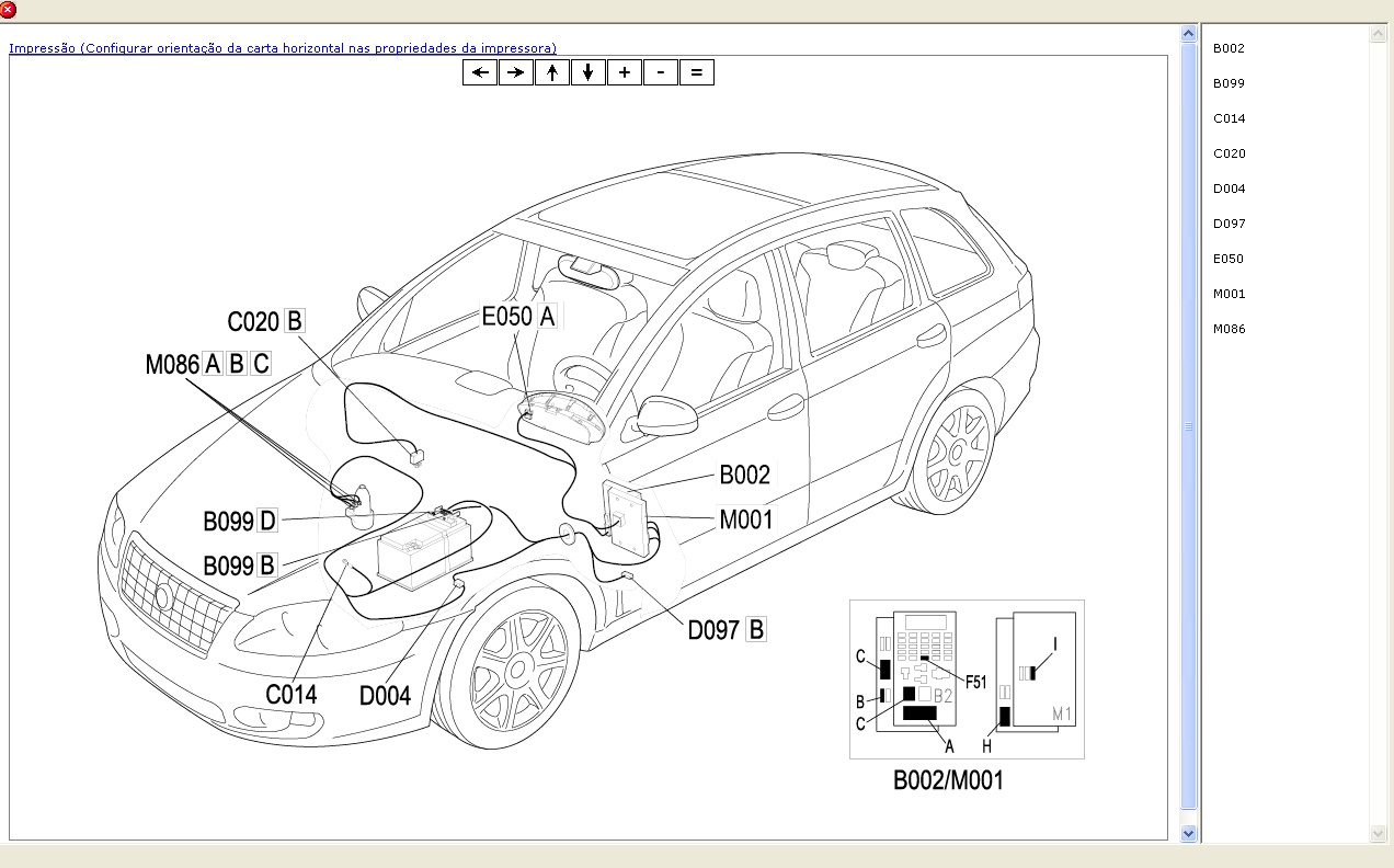

Just to confirm yours suspicious in CROMA the TRW steering ECU is placed on the hydraulic pump inside engine bay as you can see in the photo.
Best regards,
Alfiat
