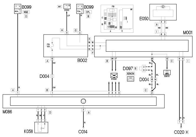

Recently I have a problem with power steering in my Fiat Croma 2006. I wanted to connect to power steering pump through K-line using FES but it doesn't support my car. I have pin 1, 3, 7 connected together in VAG plug and I tried to do it by using Fiat Idea settings (as I remember...) but nothing happened - no connection.
I also checked electric schematics in eLearn program and I noticed that in Croma power steering K-line goes from connector C to main computer M001and there can be diagnosed on pin #12. I also tried that but nothing happened...
Or my power pump is completely dead (I have no power steering at all, sometimes red sign of steering wheel blinks) or I do something wrong with hard/software?
Can you help how to connect to power steering? I upload attachments with some schematics.

- Power steering electric schema Fiat Croma (194)
- Clipboard02.jpg (33.78 KiB) Viewed 11626 times

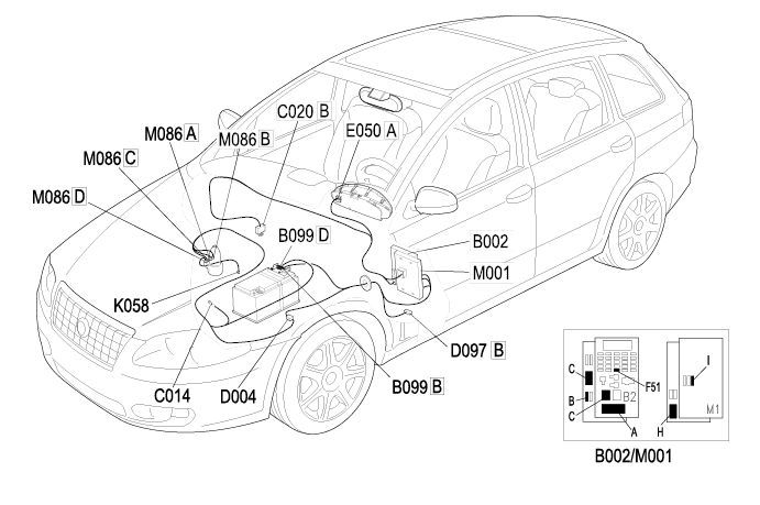

- Locations of elements
- Clipboard01.jpg (51.25 KiB) Viewed 11626 times

As I can remember you have to solder a short wire between pins 1-7-9 of your interface's OBD connector in order to connect to ABS and Power steering ECUs NOT a pins 1-3-7!!!gibon2000 wrote:... I have pin 1, 3, 7 connected together in VAG plug and I tried to do it by using Fiat Idea settings (as I remember...) but nothing happened - no connection...

Small mistake: connected pins are 1-7-9. I didn't connect with pin #3 (airbags). But still no answer from ECU (when #12 is connected to #7 - also).
