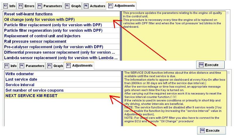

Re: FIAT PUNTO EVO - 2011
OK! Here is solution.
When you are trying to reset OIL service light on ALL Italian diesel MJET cars you have to do next:
- select Engine > then "type of engine" > than F7 (settings) > then select "oil change version with DPF" > click F10 (execute);
- select service > than "service interval" > than F7 (settings) > then select "next service KM reset" > click F10 (execute).
You have to reset service message always on 2 separate ECUs. See photo.
MJET oil RESET.JPG (89.31 KiB) Viewed 10717 times
