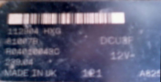

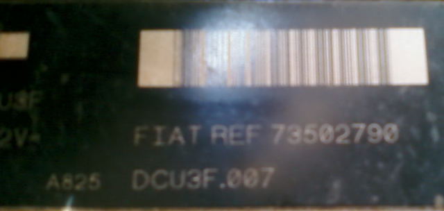

I have been able to take photos of the Palio 1.9D ECU in my car. It is 2003 model and there are lots of numbers written on it. Please find the enclosed photos and tell me the ECU Model.
I'm working on finding the model of the ABS and only Bosch is written on it, I will revert ASAP.
Please let me know if you need any other details.
Regards
Rahul Dev

Re: Palio 1.9D
the ECU modle number is
LUCAS DCU3F EEPROM 25/95080

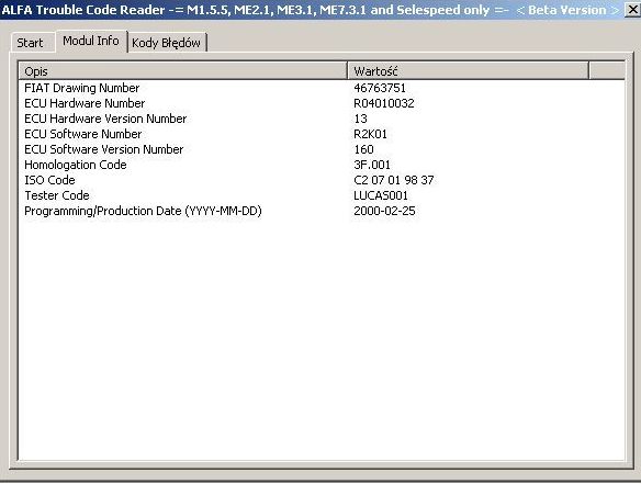

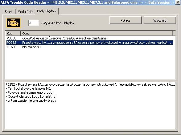

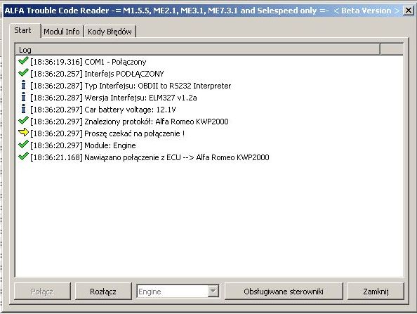

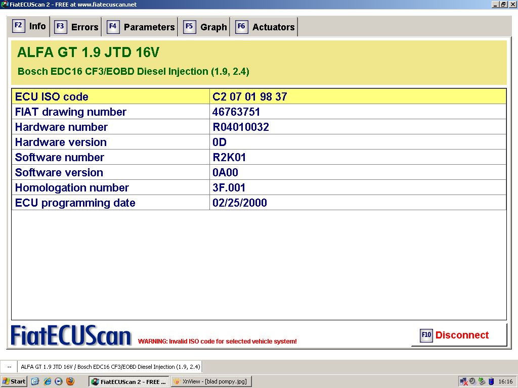

I was able to connect to the ECU punto 1.9D. It works with cable LM327. You can erase mistakes. You can see part of the parameters. However, the scale is inappropriate. Actuators do not work. Please support this Lucas ECU. The following screenshots.
Here is some documentation for Lucas EPIC dynamic parameters, errors and other things. It may be helpful? Pump out is identical.
