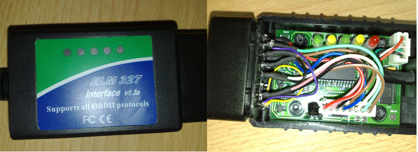

Today i received my fourth elm327 1.3 and can line not work.I dont know what is the problem.I use registered version of fiatecu.

When i plug in car Blue interface, lamp for petrol is blinking.Maybe the wires in interface not corectly soldered.

Today i received my 5-th elm327 with original 1.4 ic from skpang.Only this work perfect with can line.Other 4 elm327 1.3a from china is defected or bad clone. :?

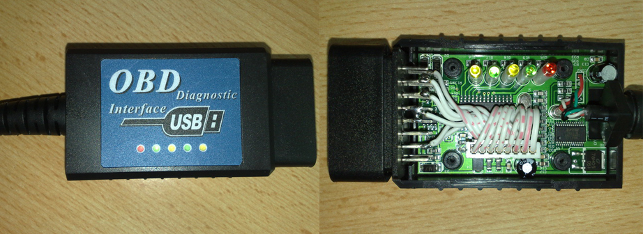

I opened up my interface and I looked.
I have the bottom blue one.
The soldering are the same like your.

Mine is also the same as the bottom one... works OK.

Yes from ebay and china.Only original elm327 from skpang works fine.Today i solder elm327 1.4 ic on interface from Serbia and k-line and can line works fine.
