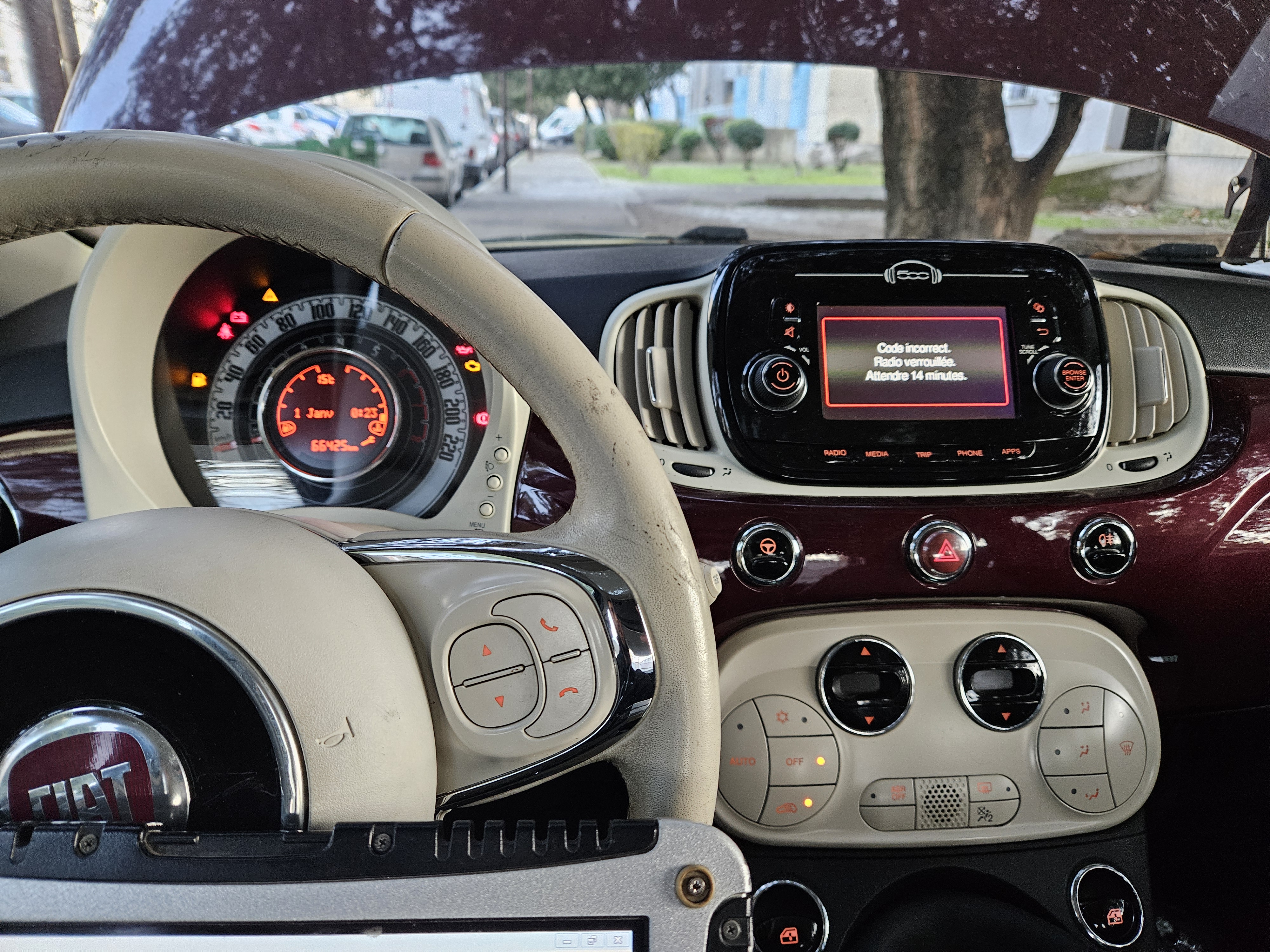

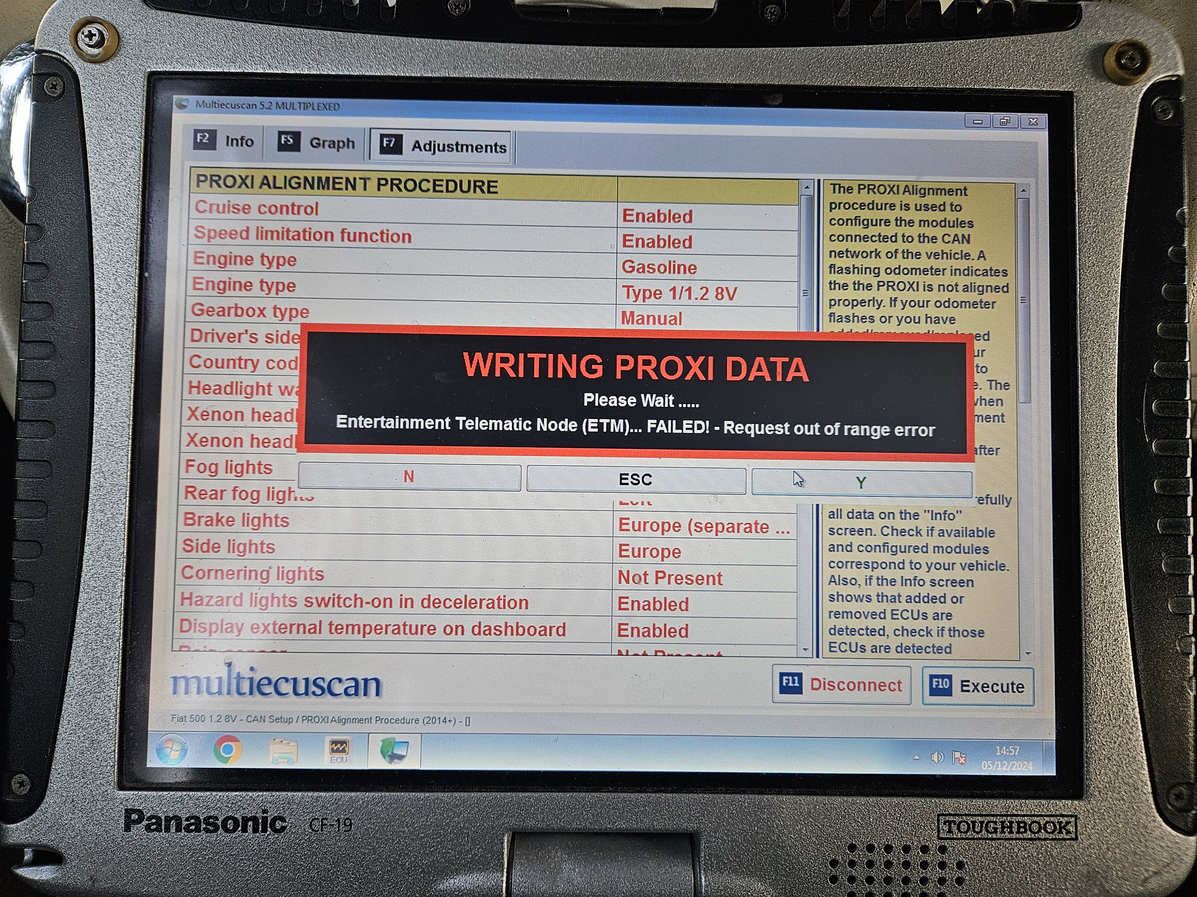

Problem solved, an massa broken in car.
It's back from thief. So we have changed the BCM with second hand because original is missing.
I have virgin ECU motor, adapter to car.
Now i have mil blinking in dashboard due to proxy aligment. I have do it but i have always error on the ETM (entertainment telematic node).
How can i do to make working?
Regards,
Regards,

Re: Fiat 500 2018 with ecu 9gf. Car start and cut after few seconds
You can obtain the original radio code via the interweb, quite a few websites who do radio codes.
Can you upload the current proxy?
I have pin code of the radio.
I have changed the bsi.
This is the log and hex proxi backup.
Only error with ETM when doing allignment?
And any fault codes in ETM?
Thanks for all help.
Car startnow.
I have make some reset on ecu.
About proxy bytes. I have copy an proxy bytes from a thread on forum and now all work good now.
Car startnow.
