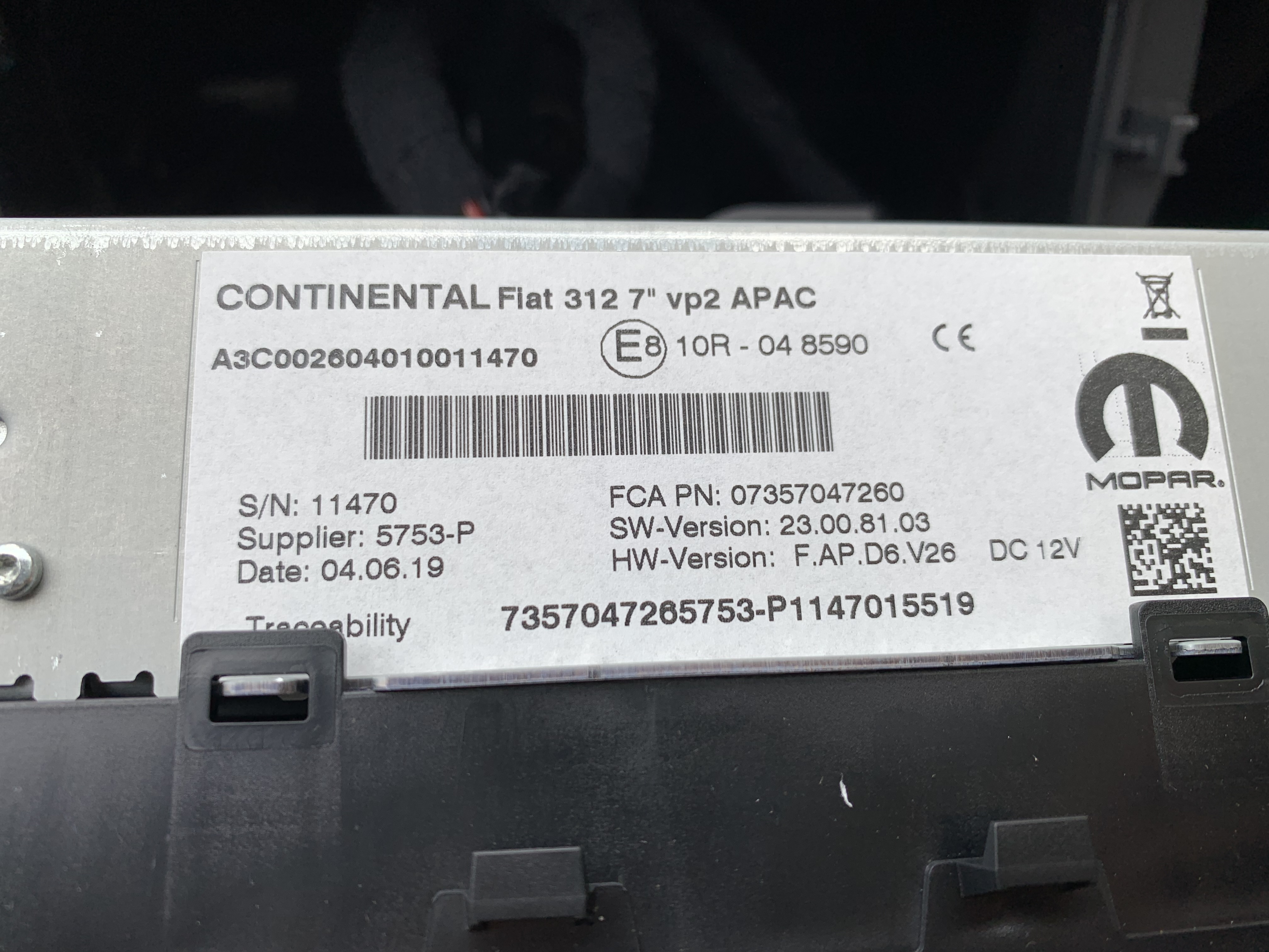

UCONNECT7 itself was a car play compatible product.
- IMG_5679.JPG (1.91 MiB) Viewed 6329 times
- IMG_5695.JPG (2.21 MiB) Viewed 6329 times

Are you sure that uconnect have carplay?? same 7 inch versions dont have that function

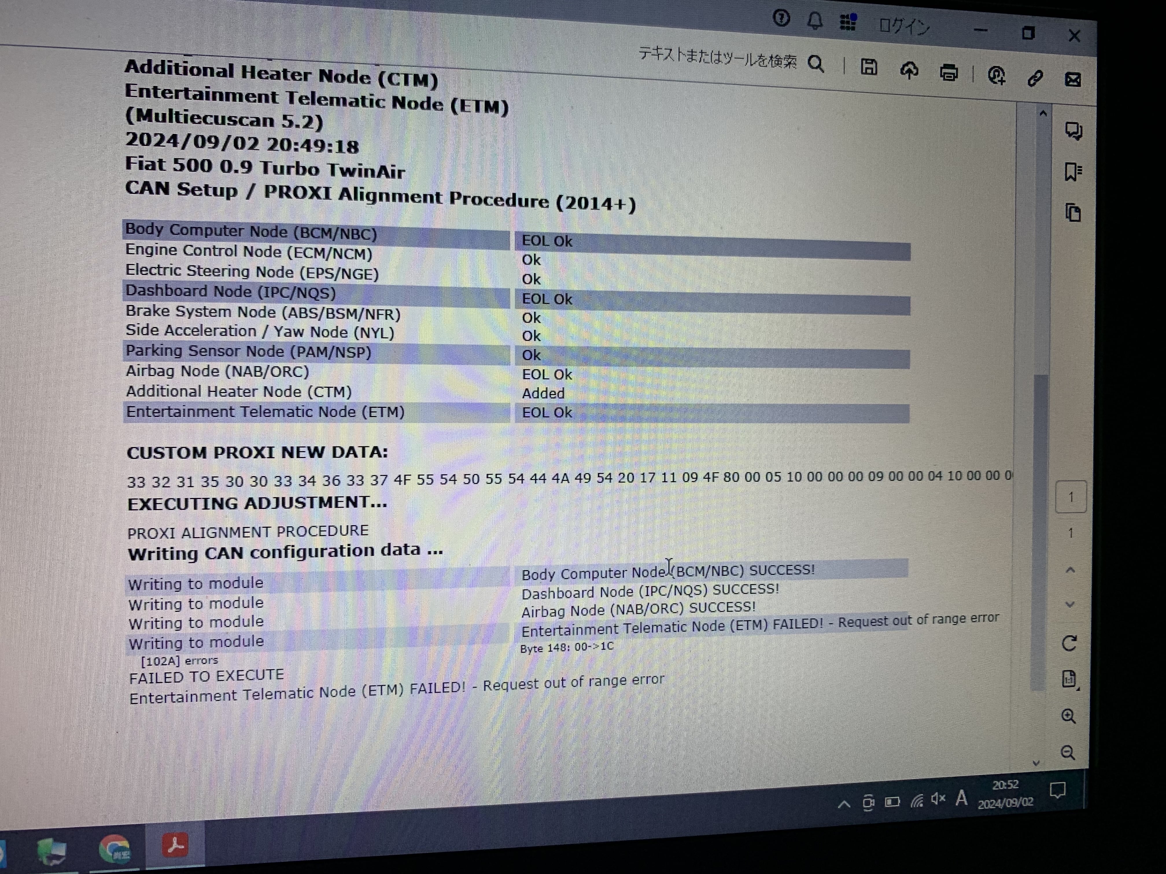

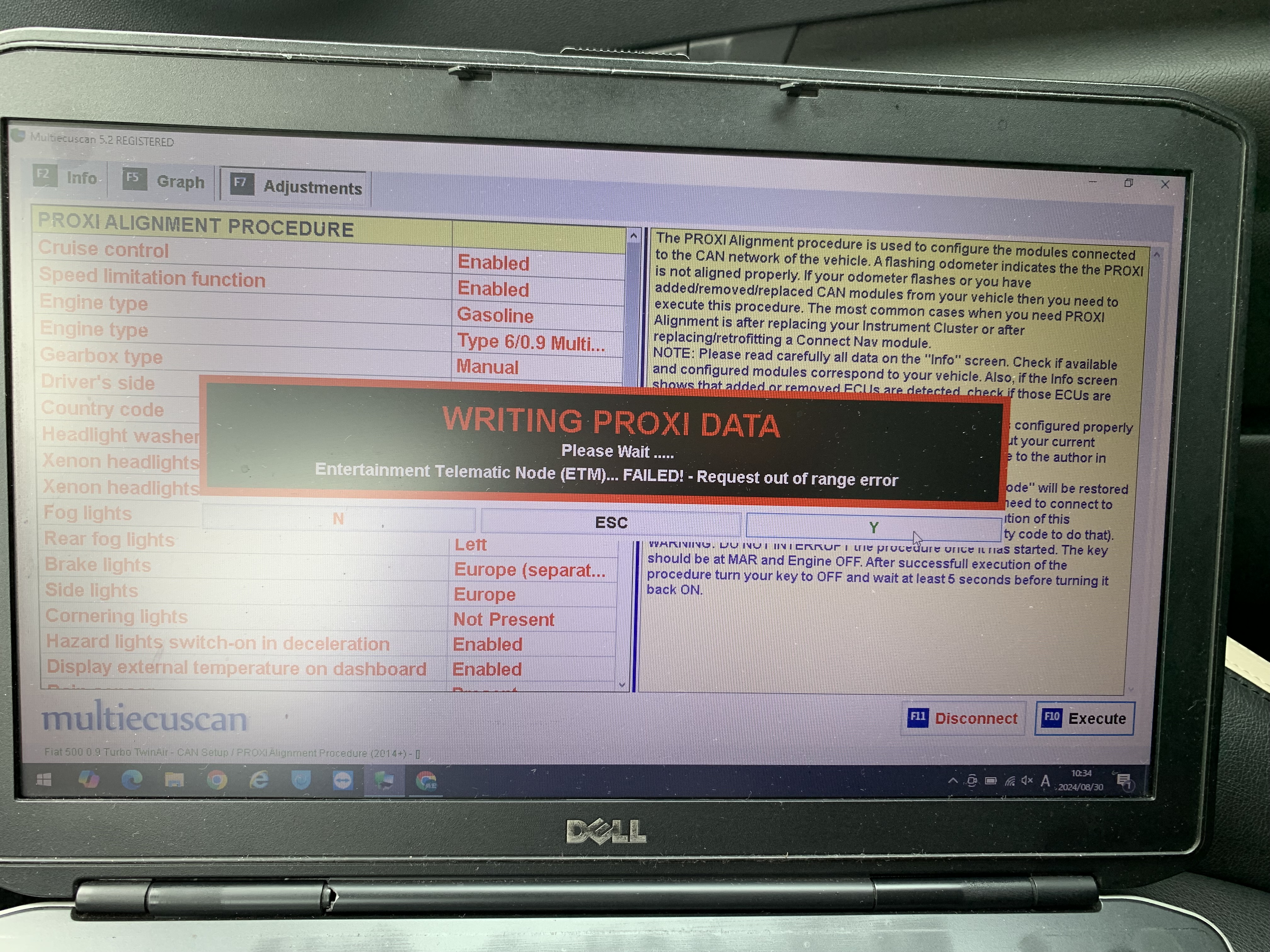

First, I set it to JAPAN, then changed from 5 inch to 7 inch UCONNECT.
Of the three proxies I received, 200byte, 201byt, and 187byte all resulted in ETM errors.
There are also corrections.
Please check the image.
Please tell me about the new proxy. Is 148 bytes the display size? 157byte is car play? Is that so?
Even after setting, CARPLAY will not start.
Please help me

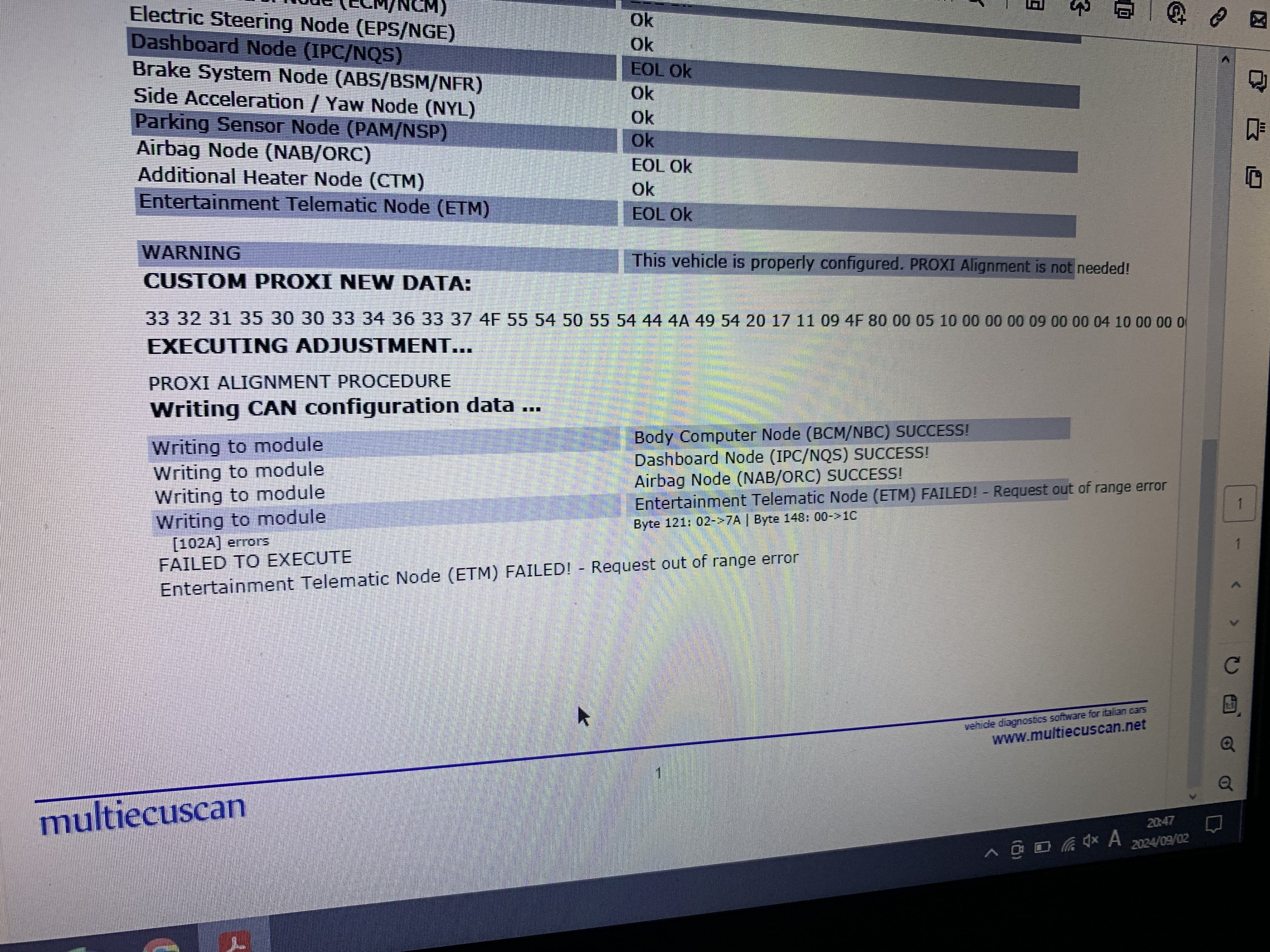

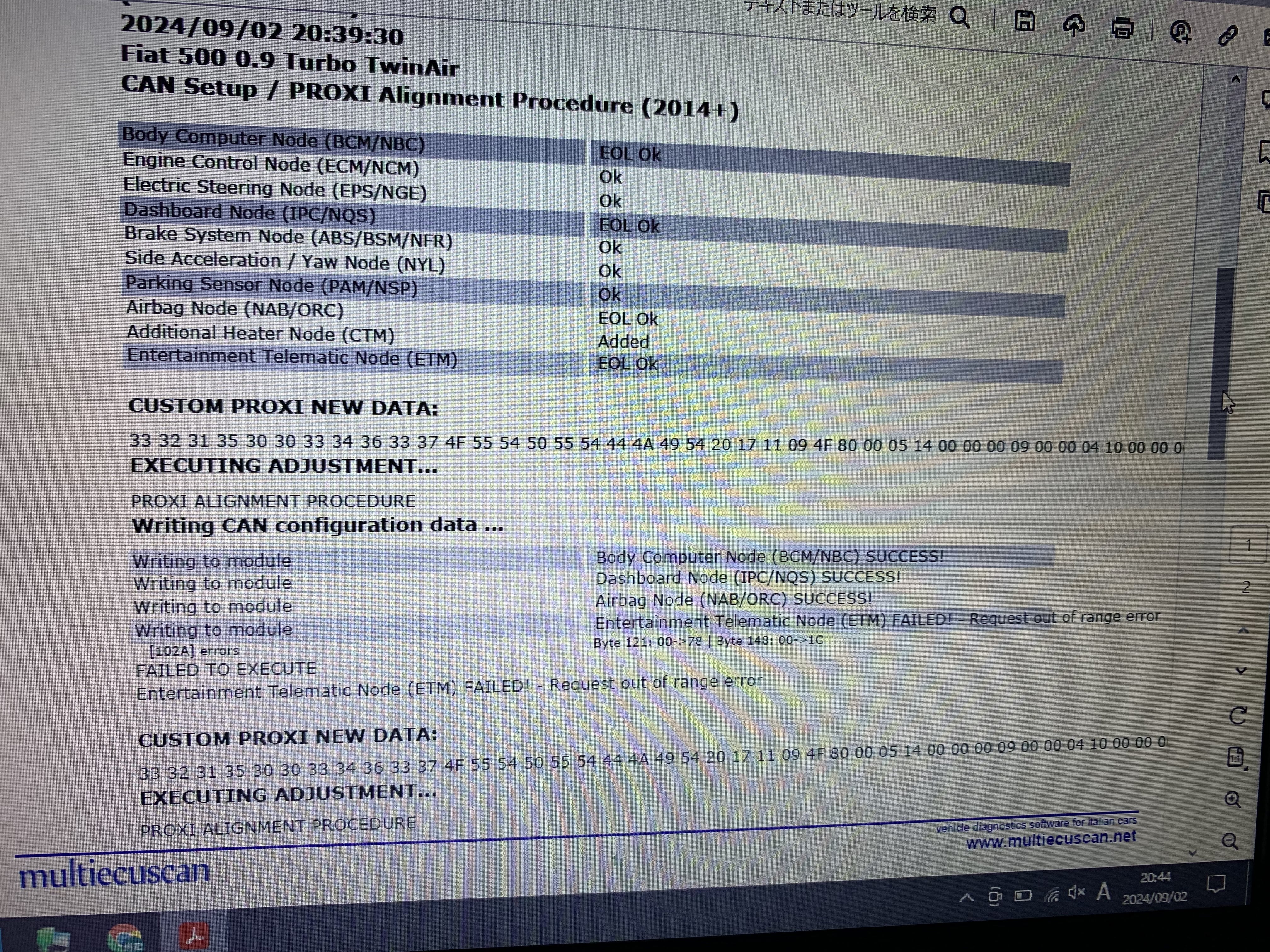

This is an image of the proxy I received.
Thank you.
Thank you.
- n3 187byt
- IMG_5775-min.JPG (2.89 MiB) Viewed 5981 times
- n2 201byt
- IMG_5773-min.JPG (3 MiB) Viewed 5981 times
- n1 200byt
- IMG_5770-min.JPG (3.35 MiB) Viewed 5981 times
Re: carplay doesn't start
I dont understand this part, all three the proxys I gave you are 193 bytes long. Are you sure you are pasting them correctly?
If the ETM allignment fails then the new configuration is not loaded and so the Carplay doesn't work. You need to get the SUCCESS message during the ETM allignment.
Anyway let's start over from your oroginal proxy, try this one:

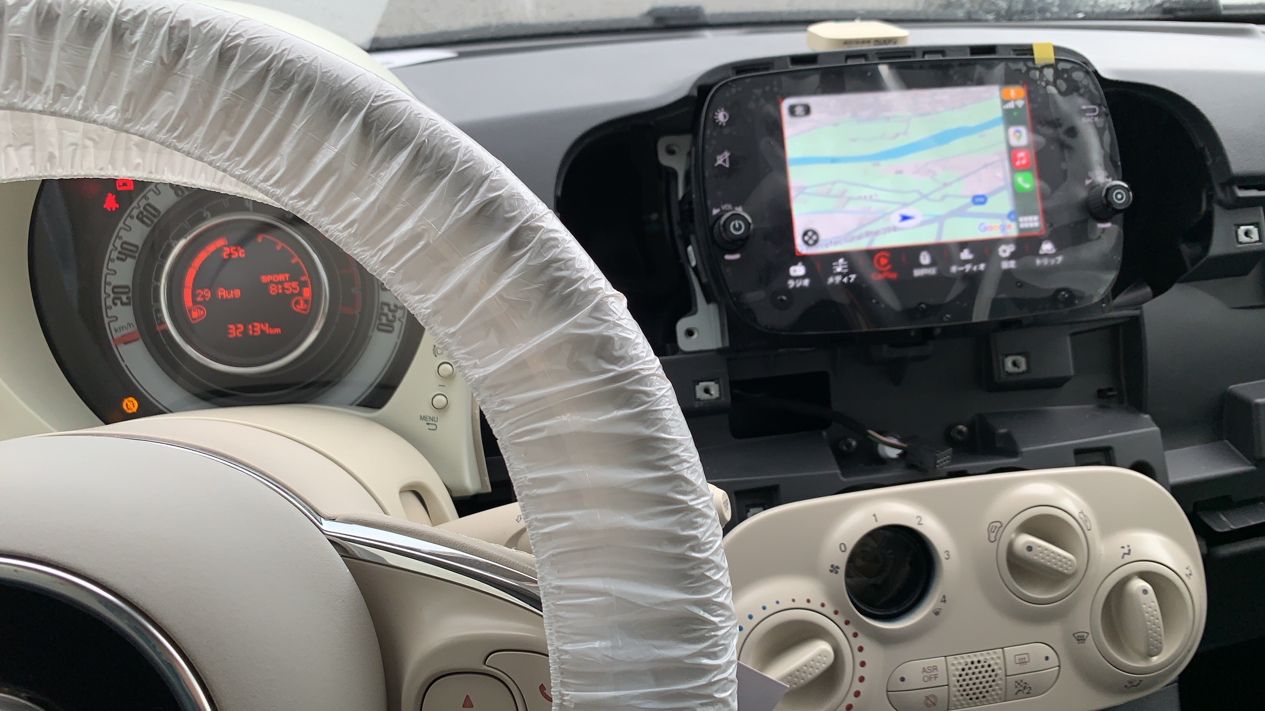

Thanks for the advice and useful information.
The above proxy worked fine this time as well.
Car play started on the n4 proxy, but the odometer flashed due to an error in the additional heater.
based on n8
byte148 08→05
byte123 15→11
byte130 05→01
Changed to.
The odometer turned on and the car play started.
thank you for your help
