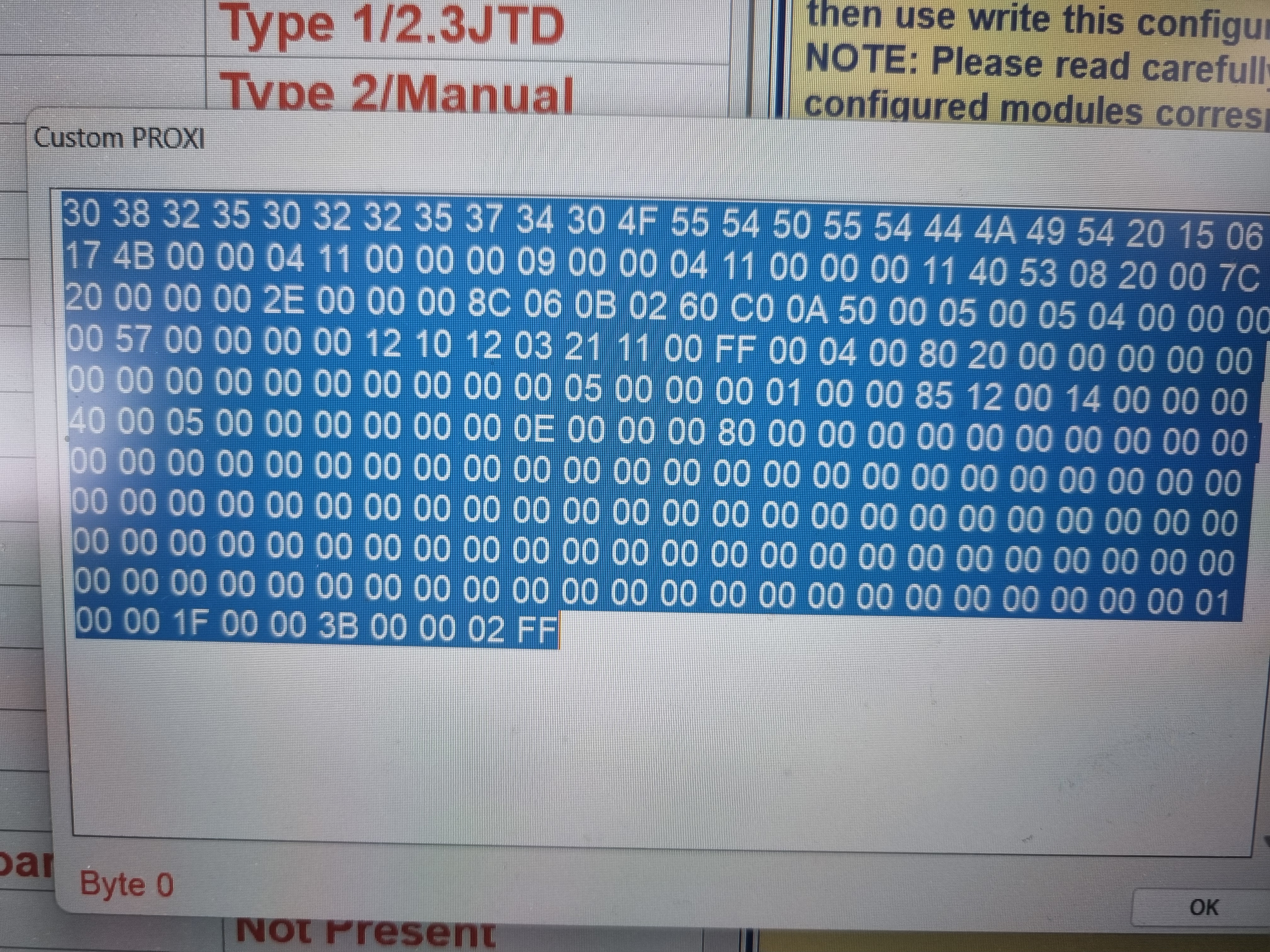

Hi, This is it

Can you copy paste the code please, it is much easier for everyone

30 38 32 35 30 32 32 35 37 34 30 4F 55 54 50 55 54 44 4A 49 54 20 15 06 17 4B 00 00 04 11 00 00 00 09 00 00 04 11 00 00 00 11 40 53 08 20 00 7C 20 00 00 00 2E 00 00 00 8C 06 0B 02 60 C0 0A 50 00 05 00 05 04 00 00 00 00 57 00 00 00 00 12 10 12 03 21 11 00 FF 00 04 00 80 20 00 00 00 00 00 00 00 00 00 00 00 00 00 00 00 05 00 00 00 01 00 00 85 12 00 14 00 00 00 44 00 00 00 00 00 00 00 00 0E 00 00 00 80 00 00 00 00 00 00 00 00 00 00 00 00 00 00 00 00 00 00 00 00 00 00 00 00 00 00 00 00 00 00 00 00 00 00 00 00 00 00 00 00 00 00 00 00 00 00 00 00 00 00 00 00 00 00 00 00 00 00 00 00 00 00 00 00 00 00 00 00 00 00 00 00 00 00 00 00 00 00 00 00 00 00 00 00 00 00 00 00 00 00 00 00 00 00 00 00 00 00 00 00 00 00 00 00 00 01 00 00 1F 00 00 3B 00 00 02 FF
Ah,got it now,hope this helps plz ;-) ;-)

Do you know how to run an proxy allignment? Try doing that with the existing code.

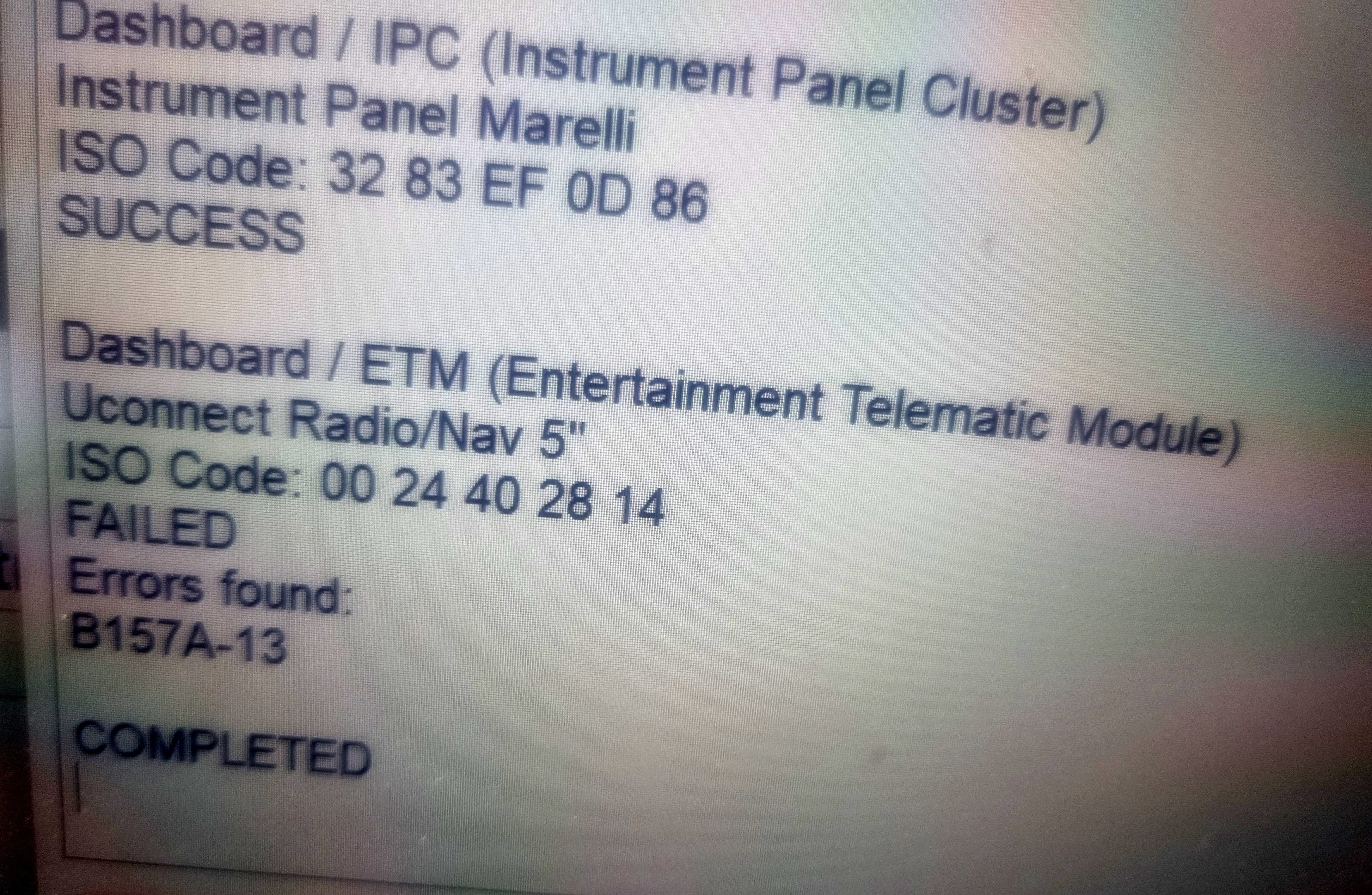

Hi tried that a few times,even if the radio is disconnected it fails.
Ive changed byte 121 to 44 from 40 as suggested.I`ll do it again tomoz and put the result on.

Hers what it says ;-)
radio faultmm.jpg (4.4 MiB) Viewed 31505 times

Try to change 123 in 05,
With or without change of 121.

My log seems to suggest that I need to change Byte 123 from F6 to F4 (Entertainment Telematic Node - Request out of range)
