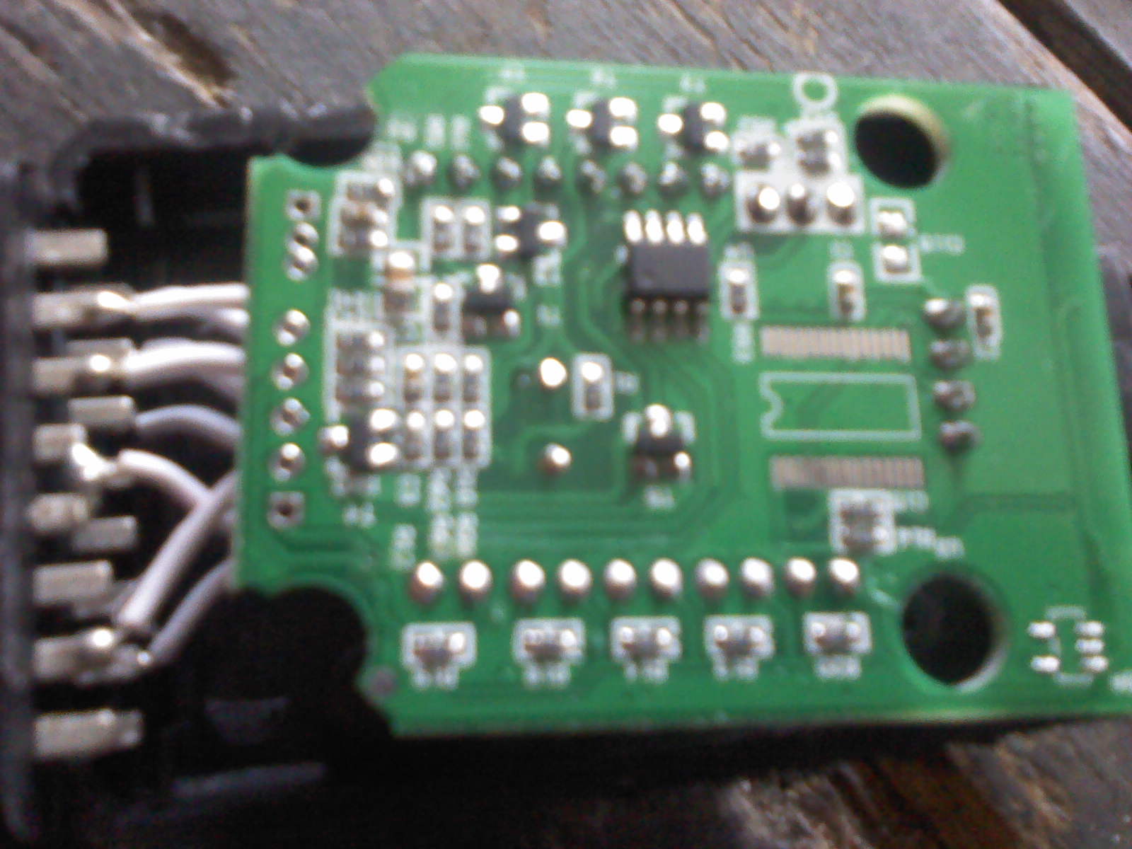

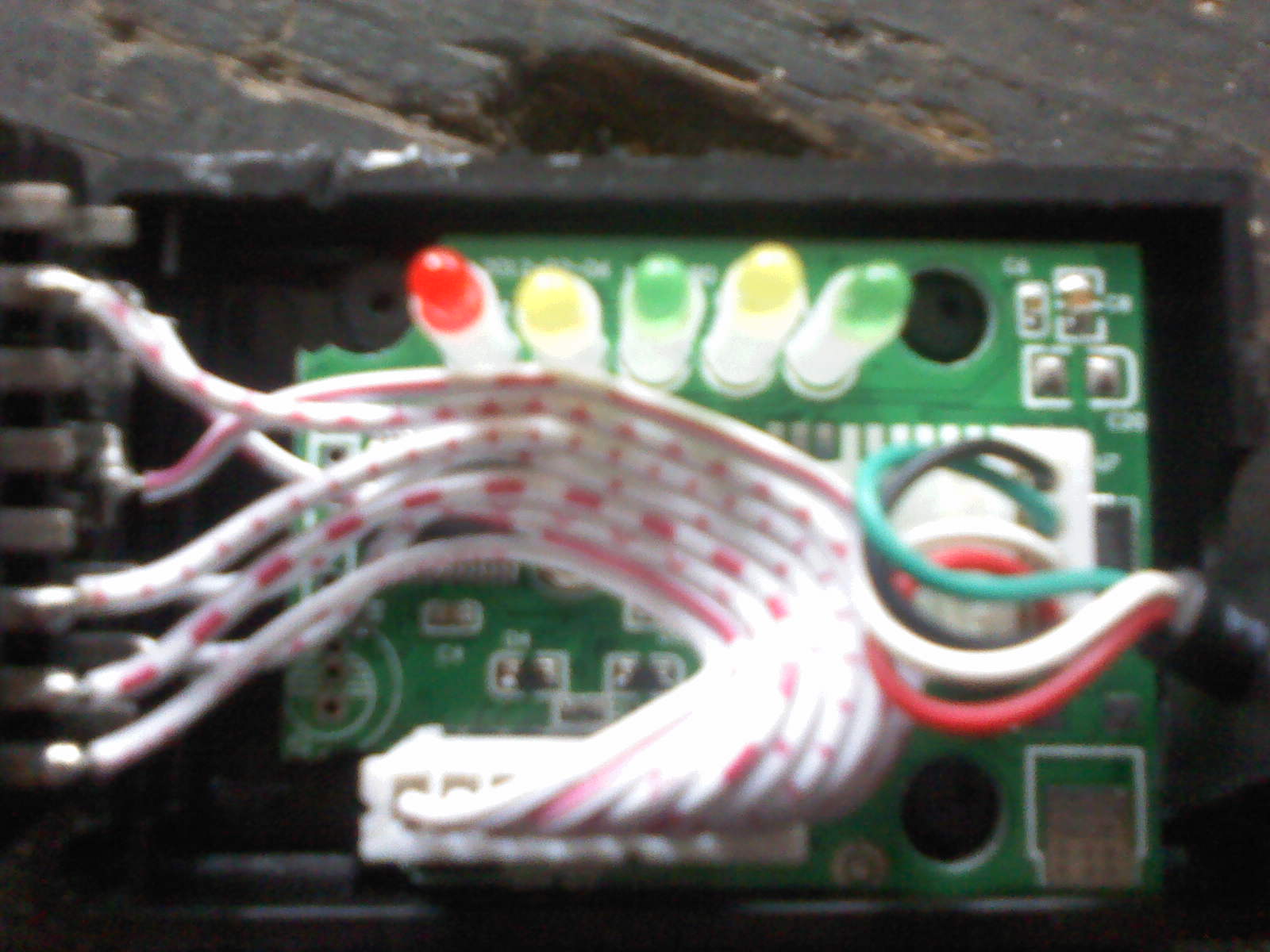

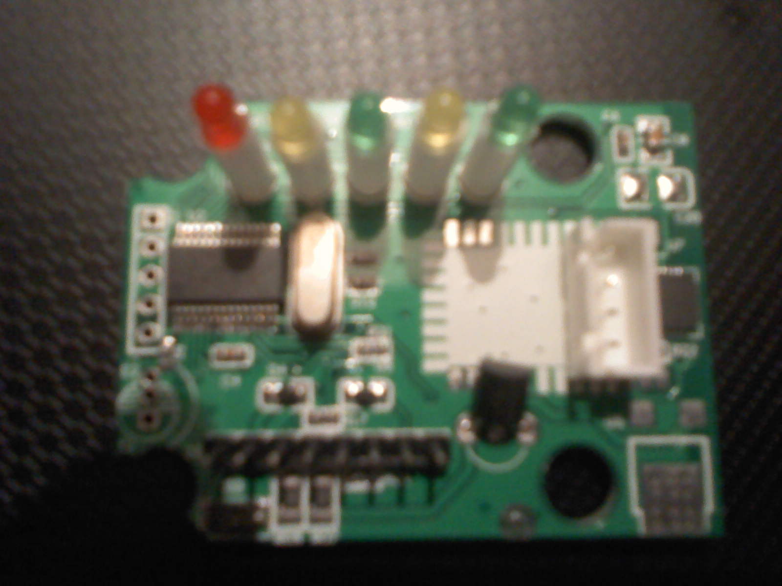

hi i have elm327 end i have problem don't connect on abs airbage dashboard but on engine works can you help my thaks
