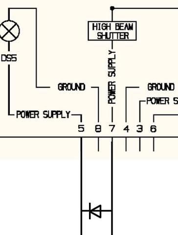

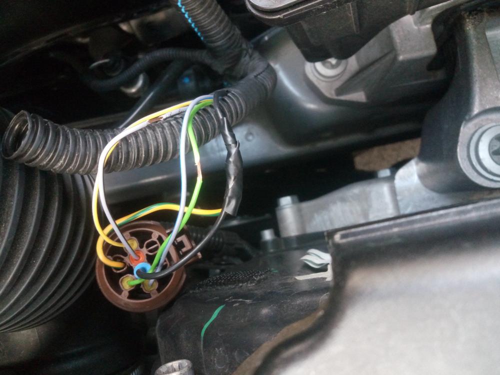

There is any modification to BC. Orginal Xenon lamps are plug&play to a car body and connector is the same. Only there is necessary to put diode STTH3002 between pin 5 and 7 according to following diagram
500x_Modifica_Xenon
500x_Modifica_Xenon
and put mass to pin 8 according to attached picture
