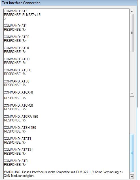

Re: ELM327 v2.1 support
This error does not refer only to the ELM 327 v2.1
the versions 1.5 are not compatible with MES
Here's a test of some of my many ELM 327 Interface
which are not always compatible
as you can see in the screen
In only Yani can provide information
ELM327 v1.5 Fehler.jpg (39.04 KiB) Viewed 8744 times
