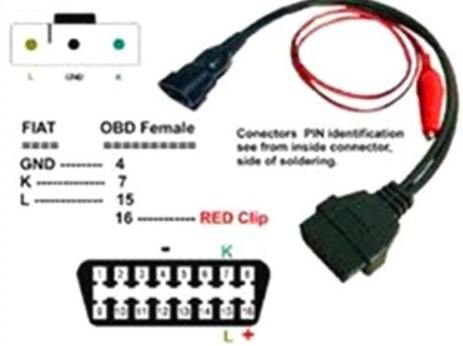

I use interface OBDkey 1.4 with 3pin adapter. Pinout to 16pin female such in attachment picture.

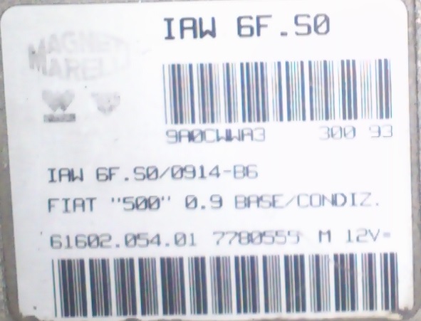

I send also the log files and the foto of engine electronic unit IAW 6F.S0.

Which year is Cinquecento?
Did you try to connect it with IAW scan?
Sometimes old ECUs are not supported.
For older Fiat and Alfa cars you need some other software.

The 3pin adapter that I use is homemaded by me and I putted no resistance at all within.
Is the 3pin adapter correct? ;)
Re: Fiat Cinquecento hanging up
Connection schematic for 3 pin connector is OK. No need to do any other modification
