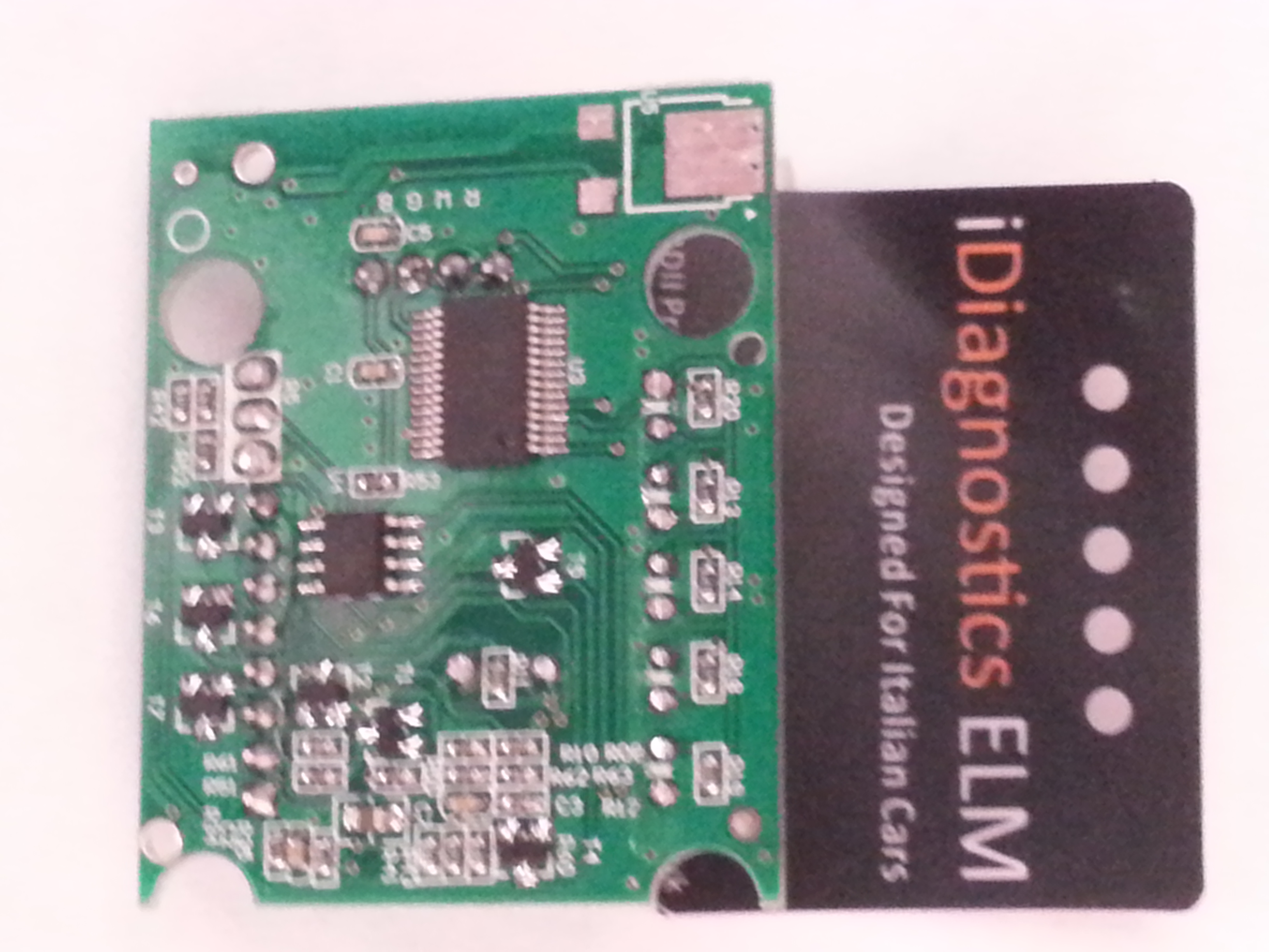

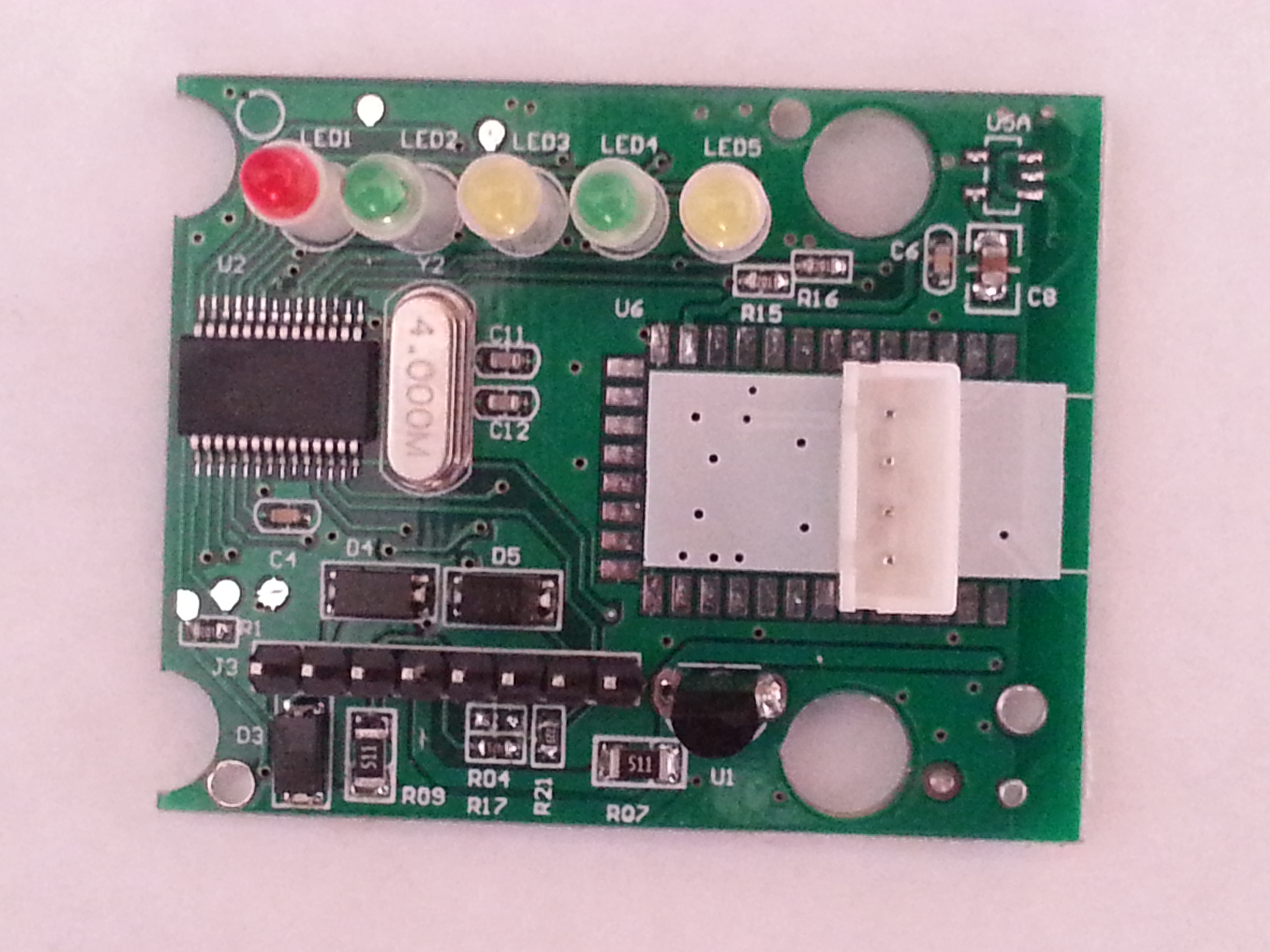

Hi, I have a Fiat Punto 2000 years, I changed the timing belt when I had the battery disconnected long time. after repair my airbag light still shines. I ordered on ebay diagnosis lines ELM yelow and green ecu is working perfectly but red is the problem cant connect . I watched the forum but I do not know what I do with that to make it work u can tell me what I should do .Thanks

Hi stefan76
To delete on your Punto `2000, the airbag light you need a KKL interface.
With an ELM you do not read to the airbag control unit.
Buy yourself another KKL interface (10 €) red adapter plug you've already
Then you can search for the error
