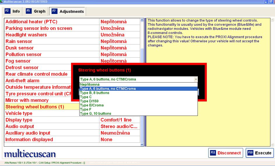

To activate the buttons on the steering wheel for the automatic transmission + and - how to do it?
Everything is connected and does not work well, what else must be done?

It is very easy.
Go to "CAN setup/ Proxy procedure" > then to "F7 Settings" > then to "Steering wheel buttons" > then select "F10 Execute > then select "Enable" > then "OK" > Then do the "PROXY procedure".

Re: Steering wheel and automatic trans AR159 1,9JTDm

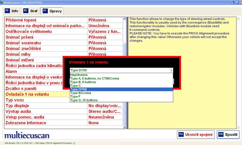

I of course tried, but it did not work. There is a choice of this, I tried to type B, 8 buttons; type C; type D / 159; type F; type E, 10 keys, of course, I gave each of the proximal delimitation and it does not work and what to do.alfa156sarajevo wrote:It is very easy.

- whells.JPG (102.97 KiB) Viewed 12092 times
sorry english
- whells.JPG (107.41 KiB) Viewed 12089 times
If you done Proxy procedure after the selecting the type then it should work.
I tried it once on Stilo and did worked! I did nor tried on Alfa 159. Did not had the chance...
Procedure is obviously the same just in case with 159 does not work.
Or it is a bug in MES or 159 are made a little bit complicated.
I know that with man had problems installing cruise control on 159 mjet.
At the end he reprogrammed with additional programmer the body electronic and cruise control did worked.
Proxy alignment every time and I did not really
The "Steering wheel buttons" function in PROXI settings is for the Radio/Blue&Me controls on the steering wheel.
It does not control the gearbox paddles on steering wheel.
Yani you are right.
I did not understand the question very well.
I understand that he changed steering wheel from normal one with the other one with buttons...
hmm, but it still does not solve my problem
