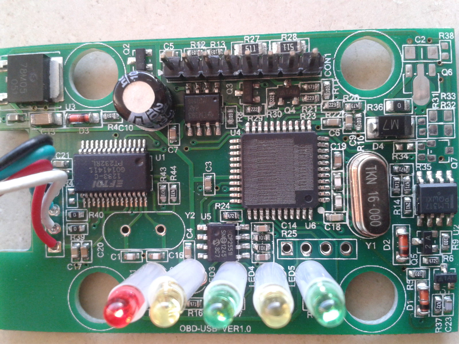

Re: multiecuscan 1.5
Good evening every body,this is my elm 327 1.5, where is the resistance to be removed?Many thancks.
- 2013-06-21 18.51.55.jpg (791.16 KiB) Viewed 6435 times
Hello Roby68
Your interface has no CAN bus disturbing resistor
Thus the CAN signal Multiecuscan should have no problems.
Check the settings again and the driver
