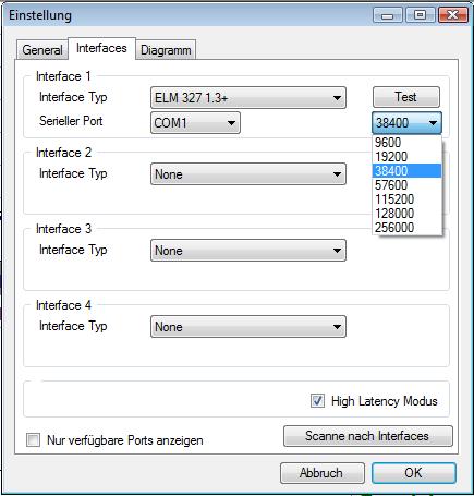

Re: Not connecting to dashborad node
Hmmmmm???
Strange thing trying some different speeds
instead of 38400
Or other ELM Interface
Otherwise, I do not continue, sorry
ELM Test.jpg (35.42 KiB) Viewed 5947 times
