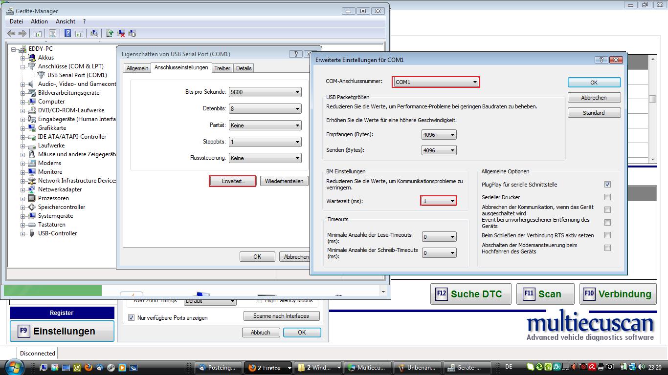

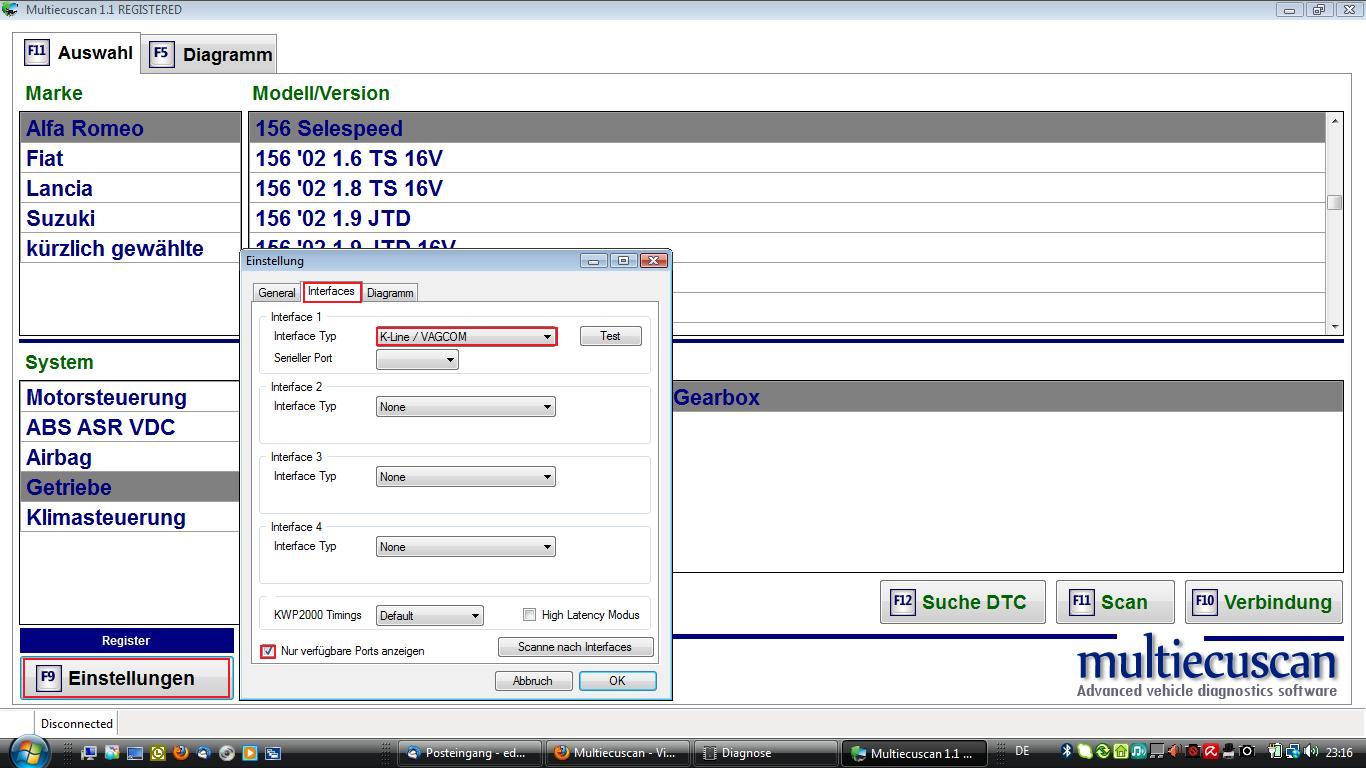

Re: Problem with reading ABS and Airbag
Hello Tim
Install this FTDI driver for your interface and Windows
And then make your settings are marked as in the pictures.
Einstellungen Systemsteuerung.jpg (173.8 KiB) Viewed 8992 times
