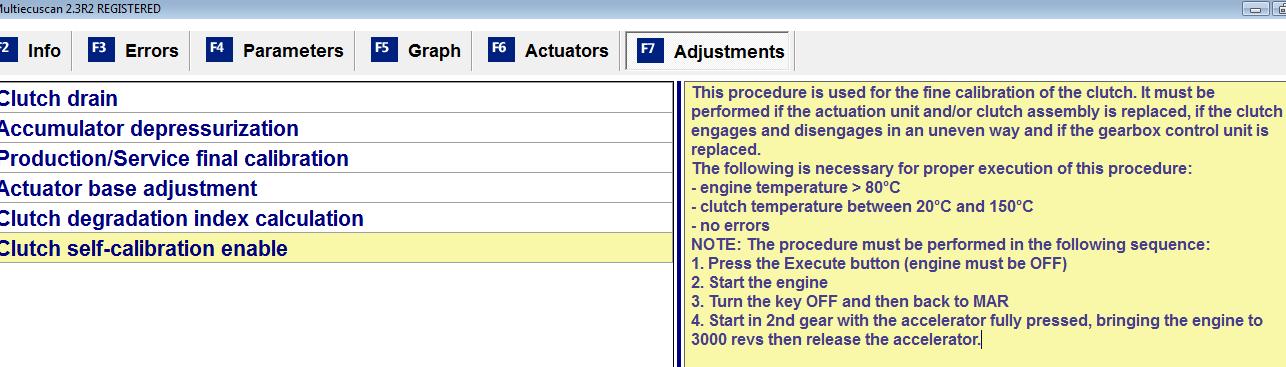

Re: 156 GTA Selespeed Clutch degradation Index/Self Calibrat
The clutch calibration is carried out according to the instructions in the right frame.
Only after the termination of the proceedings acknowledgment arrives for the implementation
Selespeed GTA.jpg (94.43 KiB) Viewed 6346 times
