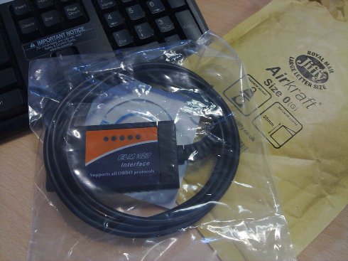

I have the same cable, ordered it as this:
http://cgi.ebay.co.uk/ELM-327-USB-1-4a- ... 2eb0de2e87
but I received the orange one instead, funny I plugged it into the USB only not the car and gave me a good test:)
When I plugged into the car nothing, no connection. Am I missing something?
I have the 2007 Bravo 1.9 JTD 16V. I may be selecting the wrong interface from the program? Any help is much appreciated it as I already messaged the seller (UK Seller) and told him that his cable is a fake and should be ashamed as itw as advertised as original. I am about to return it but would like to give this another go.
I have also purchased the Fiat convertor cables, the 3 yello green and red cables.
Should I head over to http://www.ftdichip.com/Drivers/VCP.htm an download the latest drivers? All I want is to get the car readings and reset the engine error code for the EGR Valve.
Should I leave the COM POrt speed to 9600 or bring it to 38400? So do I connect the ELM cable into the yellow cable then into the port or simply bang i into the car port without the adaptor cables? After which I connected the USB to laptop, switch car electrics on then fire up FiatECU do the test and try and make a connection?

Please check the following thread:
viewtopic.php?f=5&t=1493
The problem with your interface seems to be the same.

Hi mate, I did look at that pretty extensively but I can't find any links to products that work without messing around, from what I saw there are different ones. I don't have a solder or something to test the ohms and not sure I want to mess opening the device up, besides I can post it back and I can get something else that does work. Don't mind paying more if it works properly.

If you want an ELM327 that will definitely work with FES, look at one of these:
http://cgi.ebay.co.uk/ws/eBayISAPI.dll? ... 0612878622
