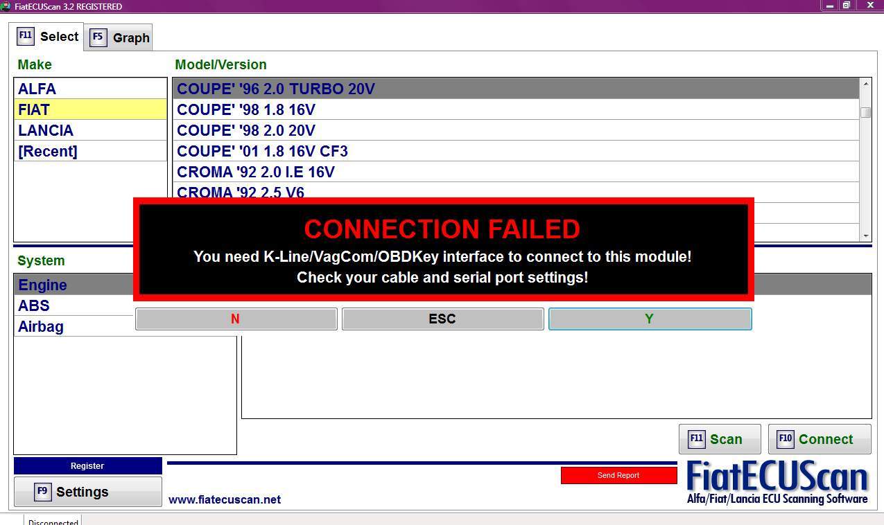

Same here, no connection.
I Have Fiat Coupe 2.0 20V Turbo -98
Fiat Ecu Scan says that I need K-Line/Vagcomm/Odbkey to connect this module...
So, can I then get connection with this one? as this is Vagcomm?:
http://cgi.ebay.com.sg/DIAGNOSTIC-CABLE ... 2116wt_937
I have now this one and it works fine with Fiat Stilo 1.2 16V -03 and Citroen C2 1.4 VTR -03:
http://cgi.ebay.com.sg/AUTO-SCANNER-OBD ... 2313wt_905
EDIT: When I change at the Multiecuscan settings to Vagcom/KKL, I will get No response from ECU message.
I am not sure does my scanner support KKL as does not say anywhere, should I buy the Vagcom scanner?

- Screen shot about the error
- No connection to Fiat Coupe 20vt.jpg (110.33 KiB) Viewed 7378 times

@ Ismo
I think that web link for VAG COM 409.1 showen above should work with Fiat Coupe 2.0 20V Turbo '98.
Looks OK!
Looks OK!

alfa156sarajevo wrote:@ Ismo
I think that web link for VAG COM 409.1 showen above should work with Fiat Coupe 2.0 20V Turbo '98.![]()
Looks OK!
Thanks, I'll buy that!
Ismo
