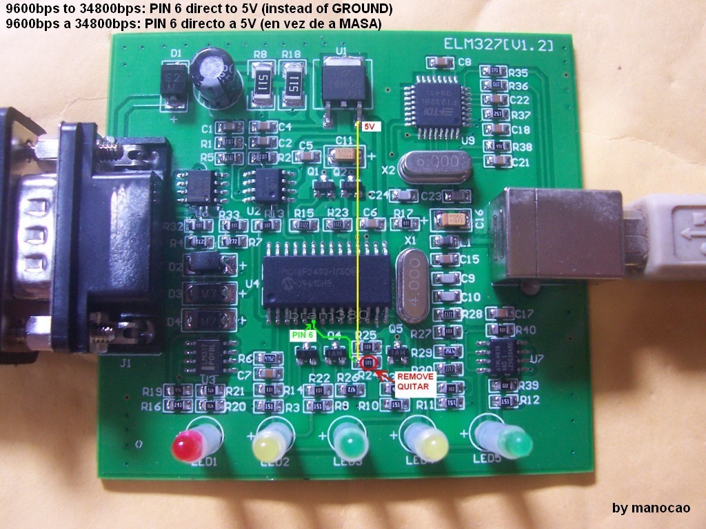

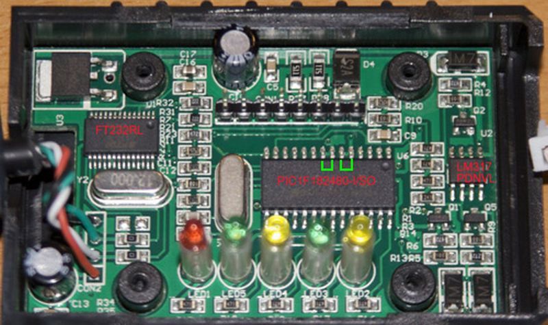

Hello, you can made your ELM327 1.2 metal (1.5a fake clone) or plastic 1.3 from 9600bps to 34800bps. See pictures :)

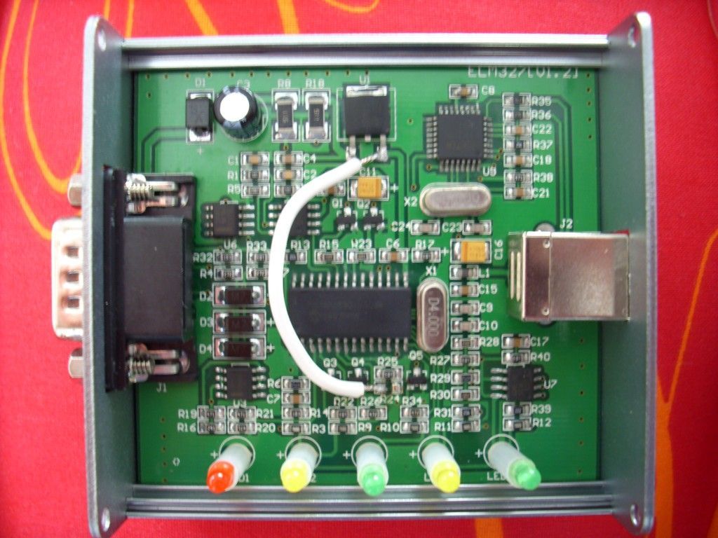

i don't get it....
what should i do?
i probably have one like first picture...do i have to solder a cable like 3rd picture?

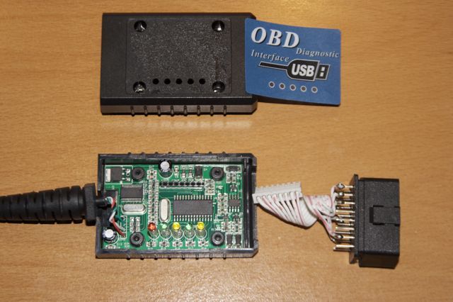

I edit the post. In first post is ELM327 1.2 (1.5 fake version). Now, here is the plastic ELM interface.

No, no connect pin 6 from OBD connector. Pin 6 from Microchip to 5v. and remove/unsolder resistor R24 from sheme. Is this :) When this manipulation try to connect with 34800 boud. :)
