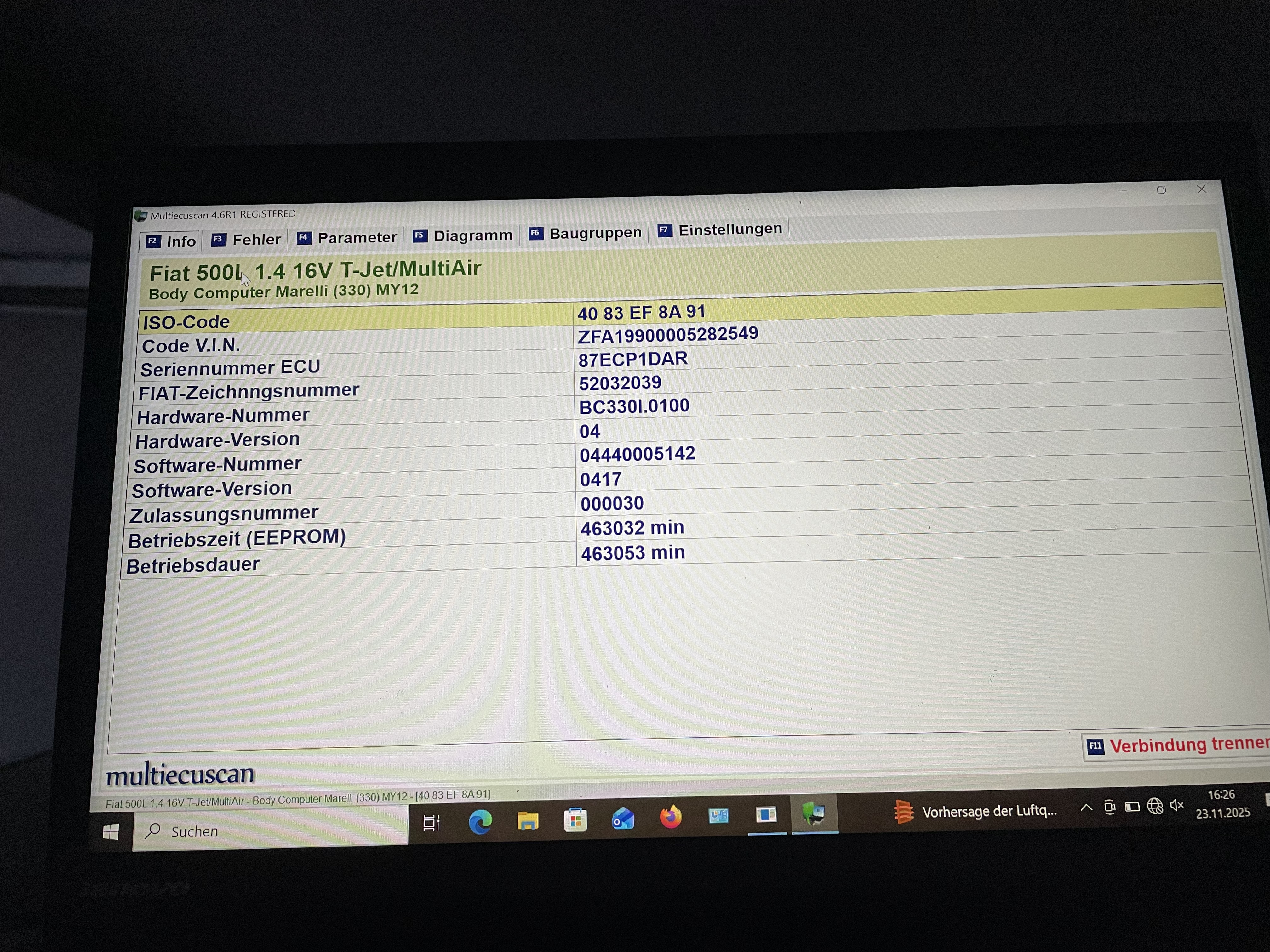

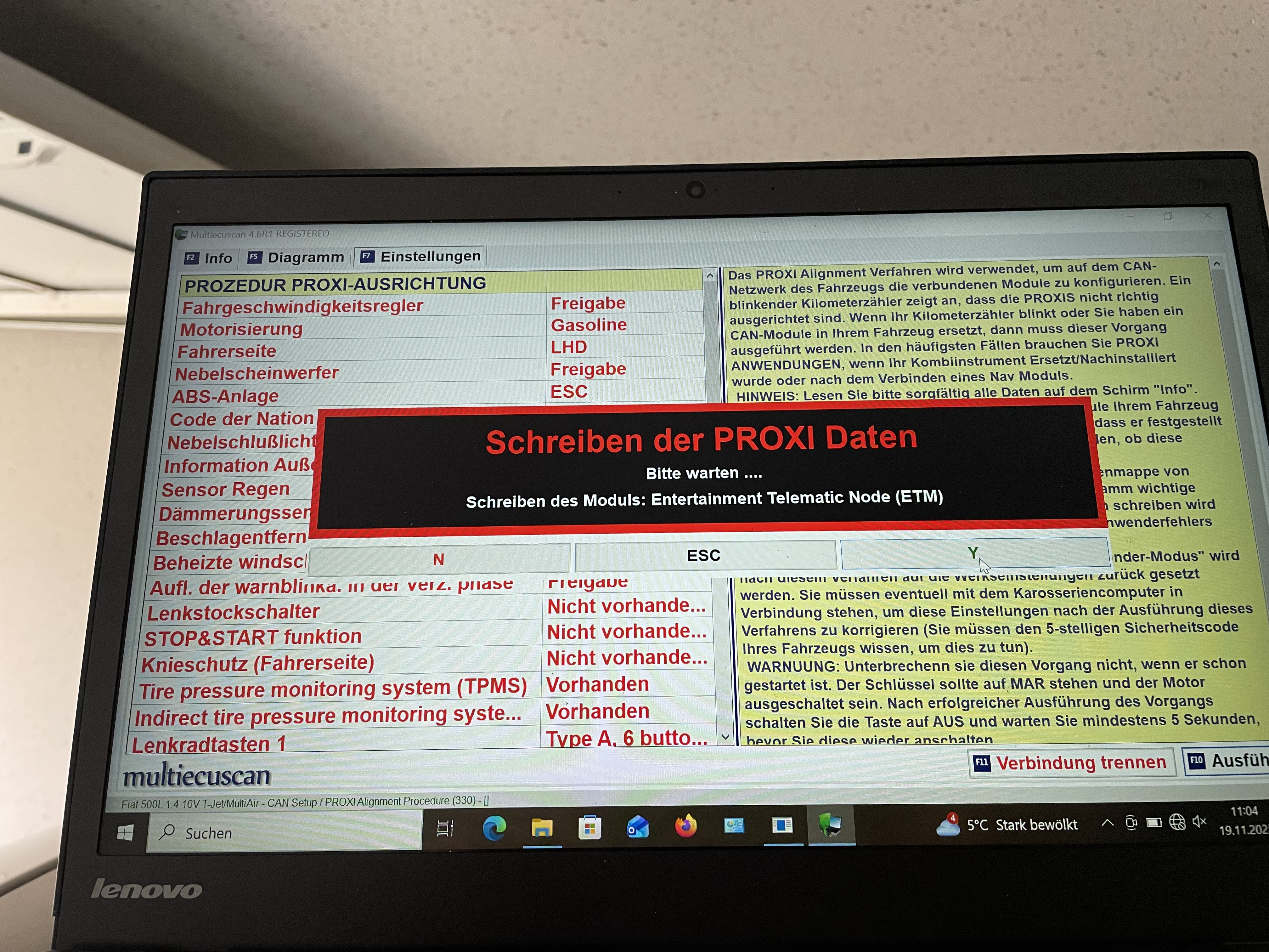

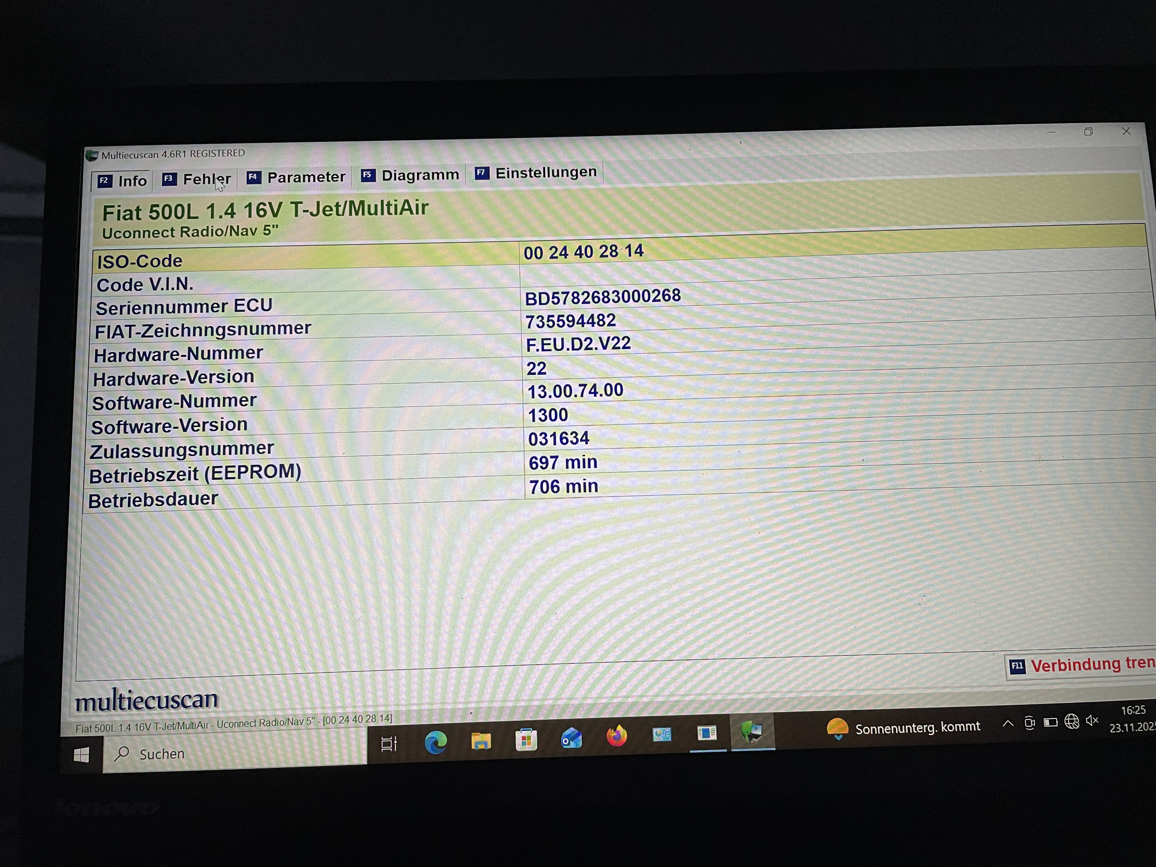

Good evening, yes, unfortunately. The proxy isn't working. The radio isn't registered with the vehicle. I'll try to insert the pictures here.
wauzzz
Posts: 6
Joined: 22 Nov 2025, 18:07
Location: Germany
Re: Uconnect 5 (Fiat 330 VP2 NAV ECE) flashing odometer
Post by wauzzz »

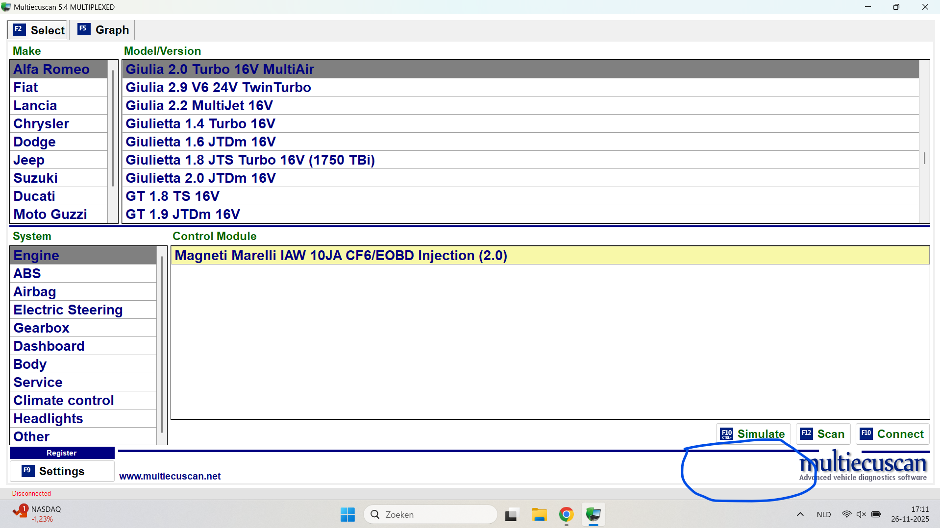

After a failed proxy you will see a button here: (see attached file)
Can you upload what you see then?
aangepast multiecuscan .png (197.2 KiB) Viewed 11280 times

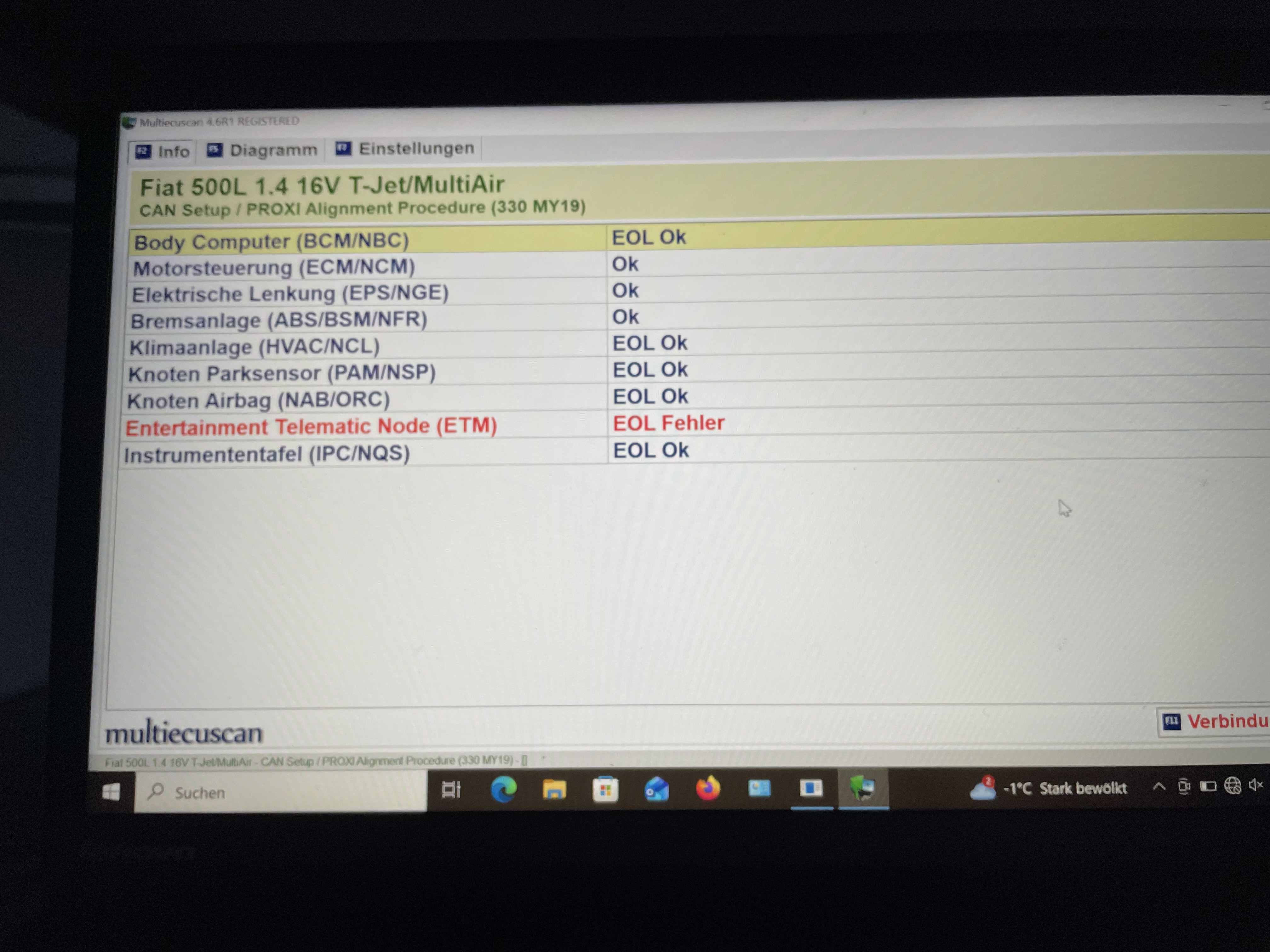

I will perform the proxy alignment again, and if there is a notification with my MES version, I will post it here.
wauzzz
Posts: 6
Location: Germany
Post by wauzzz »
@ abarthmultijet
I think I know what you mean, the report. I completely overlooked it. I'm adding it now. Sorry I have so little experience.
Report1.pdf
(466.28 KiB) Downloaded 404 times

Change Byte 123 from 01 to 11
And let me know how it went. :)
wauzzz
Posts: 6
Location: Germany
Post by wauzzz »
abarthmultijet wrote: 27 Nov 2025, 19:13 Change Byte 123 from 01 to 11
Hartelijk dank abarthmultijet!
Dat was precies de juiste weg. Groeten aan de provincie Noord-Brabant.
