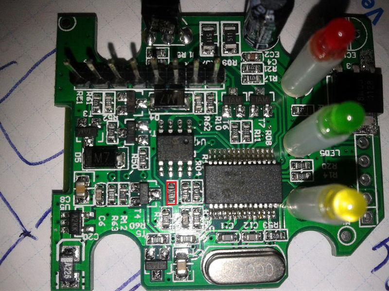

Unfortunately, the images often of poor quality, you unfortunately also :-)
Your photo flash makes everything very dazzle
But when I look at the board, I can see I should have found the resistor.
And I marked the red
Should remove this resistor and also work with your ELM Multiecuscan
20130219_161056 markiert.jpg (102.74 KiB) Viewed 6837 times
