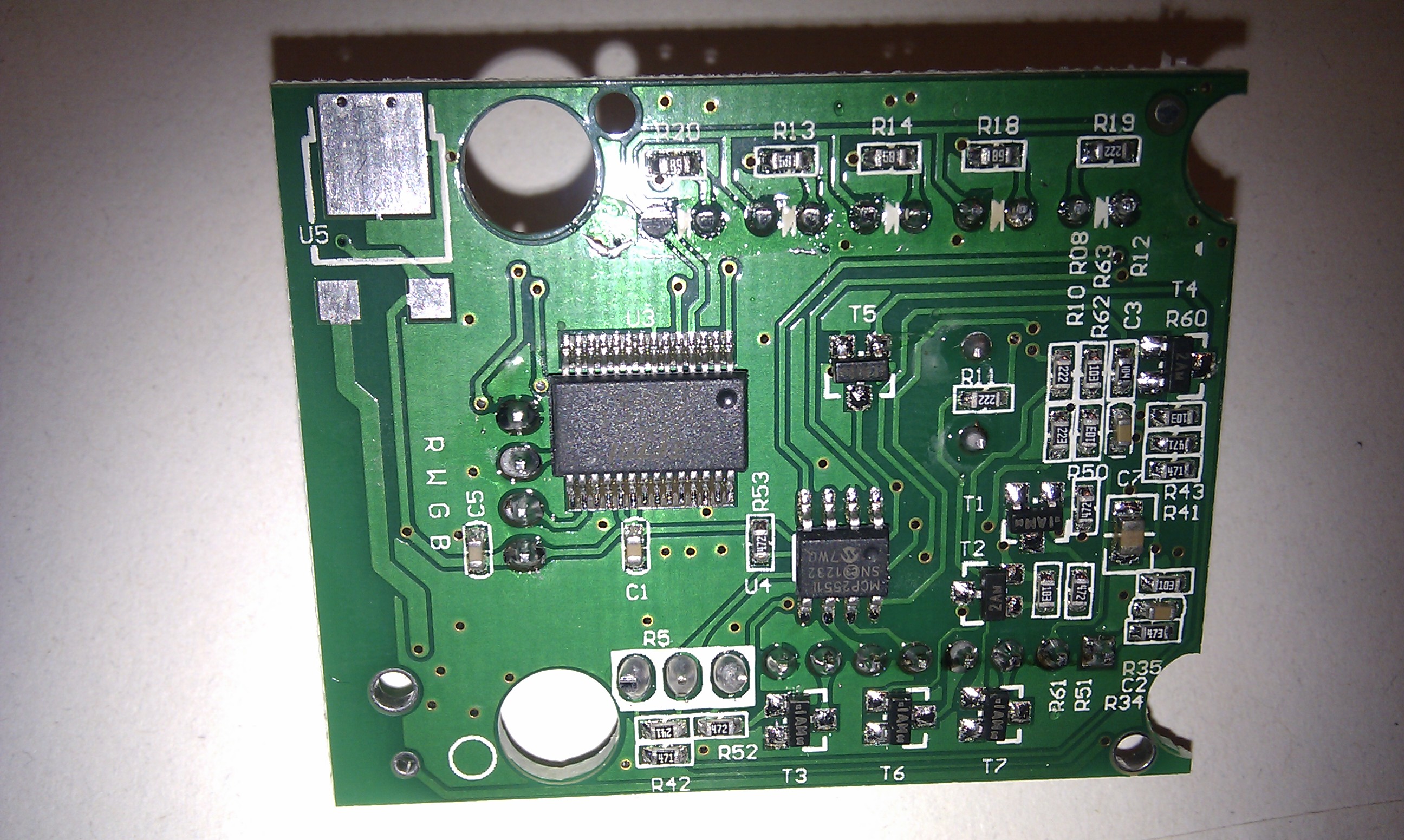

sprint750 wrote:Hello,
Another cheap 'Chinese clone', from eBay (UK seller, not china or HK), received 3 days ago.
It was sold as ELM 327 1.4 'with a genuine ELM chip'. :?
(For my personal information, I would really like to recognize a genuine ELM chip from a fake one)
Actually everything is working well FES wise, which makes me think it is actually an genuine ELM1.4
- NO communication problems, all ECU are recognized.(Airbag and steering not tested, pins 1-7-9 not soldered yet)
- NO problem to get access to service reset.
- NO installation problem. Just the drivers for FTDI USB to install.
On the last pic we can see the 100 Ohm resistors (R25/R26) for CAN H/L lines with associated capacitor (C14/C15)
Same combo shown by members in the last posts.
Hope it can help you to find the correct interface
Best regards
Sébastien

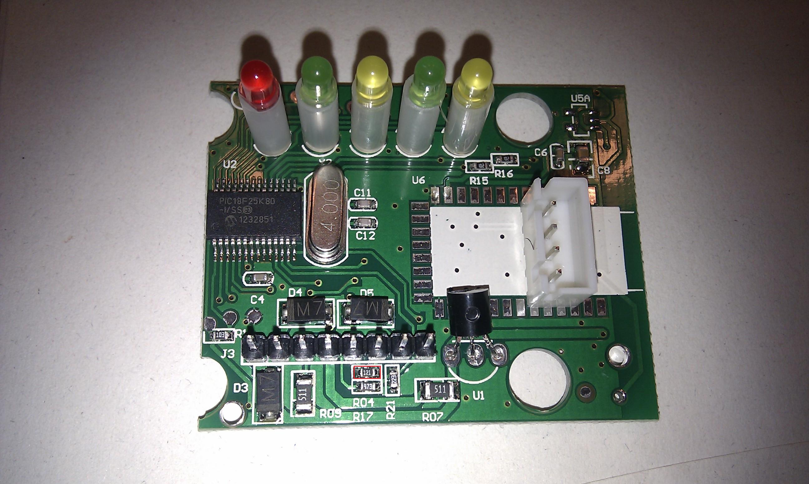

after scrolling through the previous 47 pages I did not find any user having exactly the same layout as I have bought now. It is similar to the one posted by "Franky" on page 27 (viewtopic.php?f=5&t=1493&start=260#p10022). My ELM is labelled "Autodia E327".
Can one of the pros check the layout and state if a resistor has to be removed at all?
If yes, would that be the "r04" like shown in the following posting?
viewtopic.php?f=5&t=1493&start=280#p10449
Thank you for your help!
Mark
Hello Mark
Yes, this is the relevant resistor (R04)
remove this resistance and your ELM CAN bus capable
I have to once again marked in red
IMAG0191 markiert.jpg (432.82 KiB) Viewed 10323 times

Thanks Alfaeddy!
After un-soldering the marked resistor my ELM works perfectly :D
gladly markw :D
