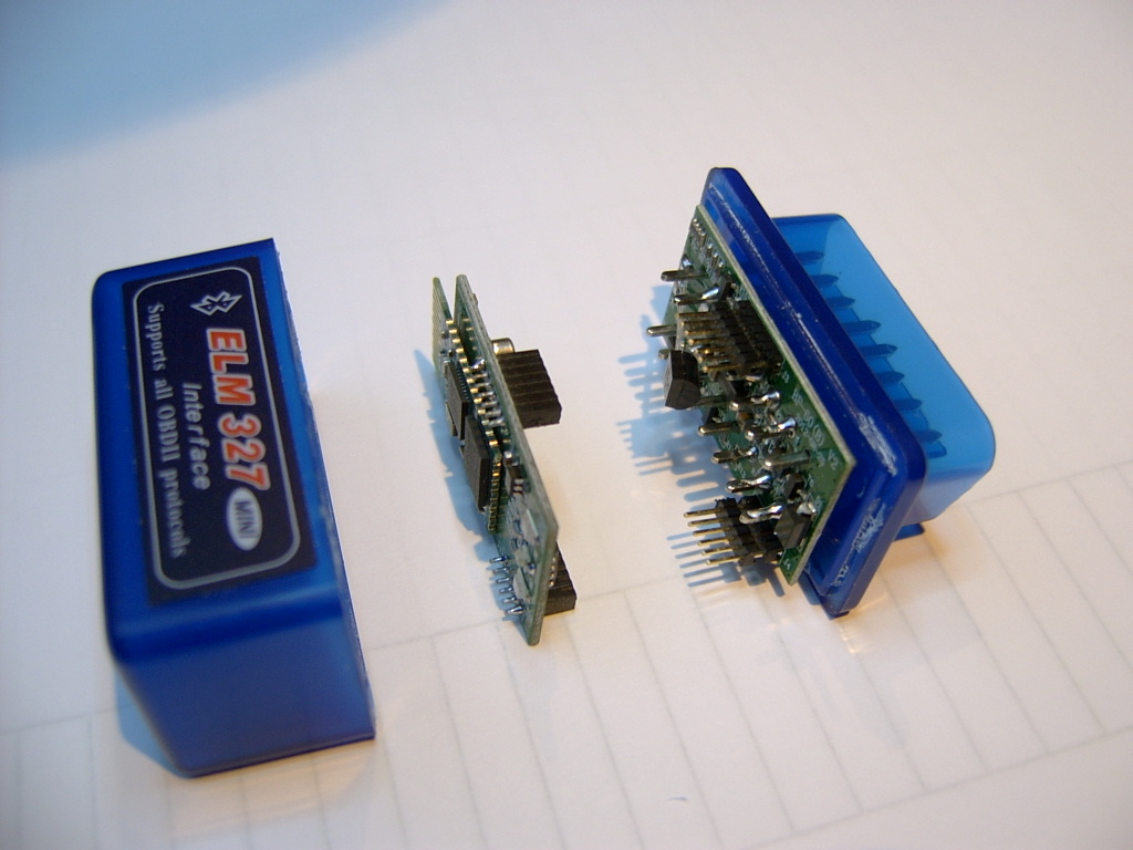

Hello Stapy
To get to your CAN controllers you need to open the ELM and remove on the lower PCB resistor R2 (121).
Then you can to control, CAN info / setup, service access, etc..
In the picture I marked red the resistor R2.
Then add the ELM mini back together and glue the housing
To get to your bag you have the KKL interface either use the adapter 2 or open the KKL and solve the pin 7 and replace the pin 3

you are the man, i can get the air bag now, i got this error "08 - Driver squib circuit"... thx man.... another favor i want to access "air bag" and dashboard...please help me with this
thx in advance Eddy for your help, i really appreciate this help

Hello Stapy
To get to the dashboard you need to change your ELM interface as described.
Removing resistor R2
Then you should make the remaining connections.

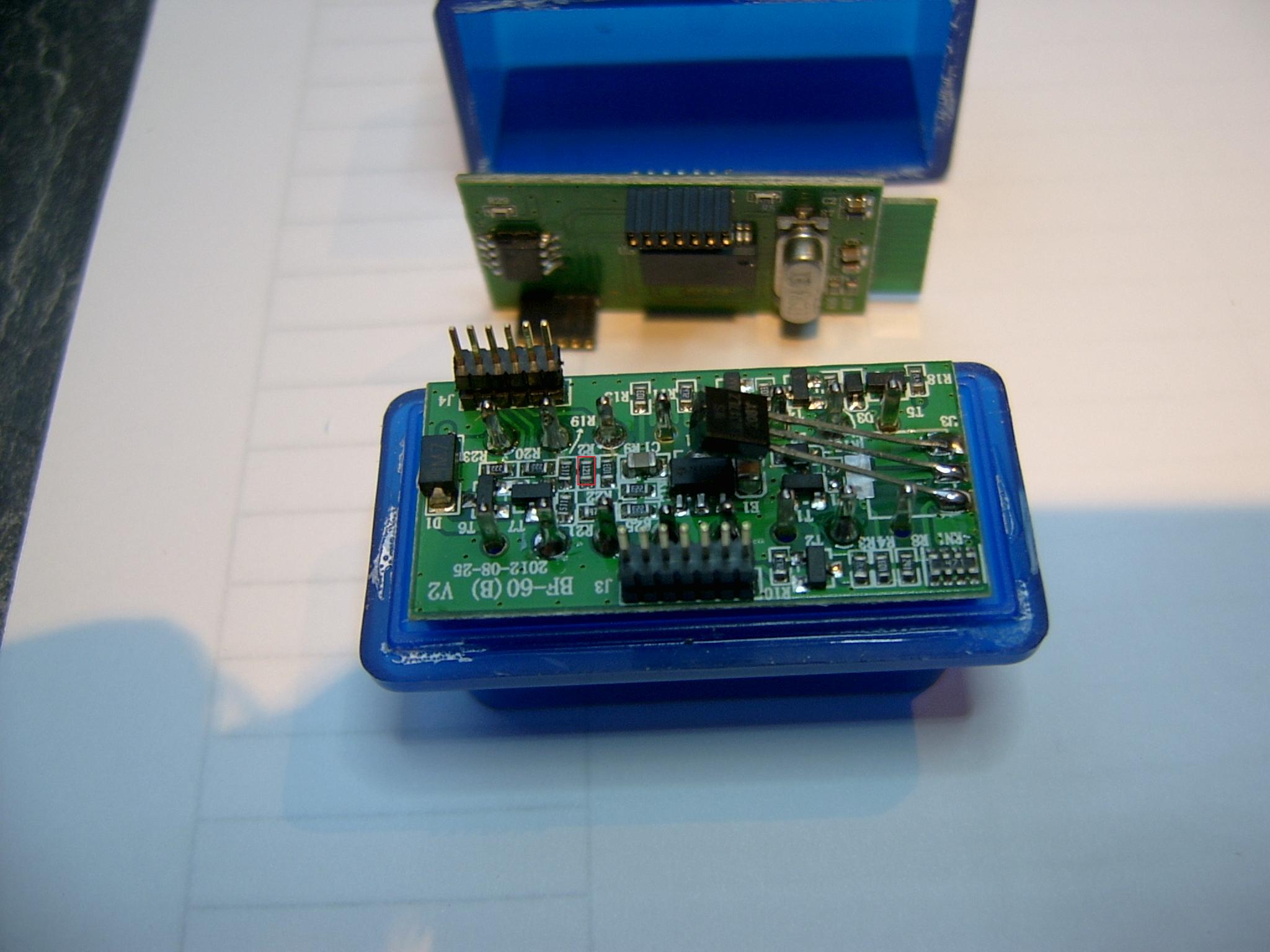

I took the plunge and remove the R04 resistor of my elm327.
The board is not like any posted on this thread.
I can access the service reset now, and the boddy, but whenever I connect the red or yellow interface, nothing gets recognized.
What can I do ?
What can I do ?
That's all right, then, for your airbag at the Alfa 147 you need a KKL interface and the red adapter
The yellow adapter you need not even needed for Mito and Giulietta.

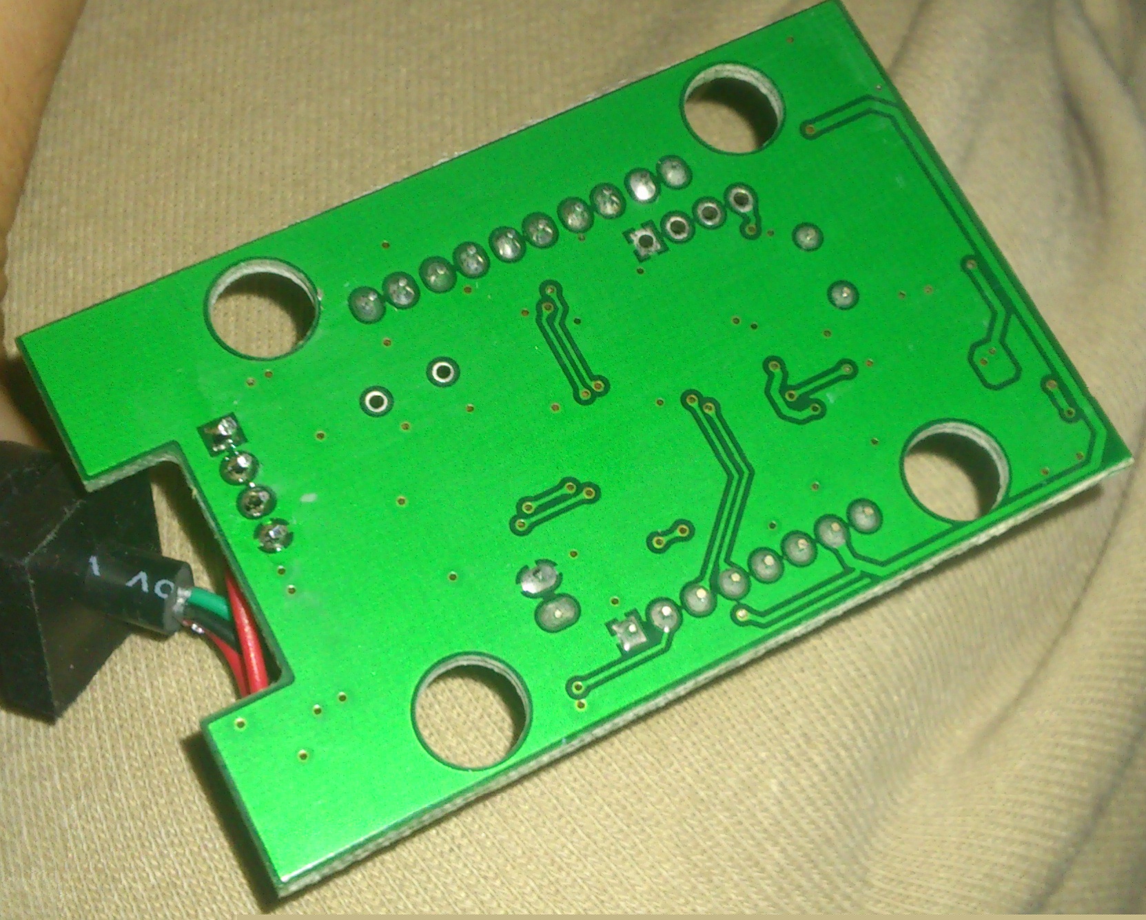

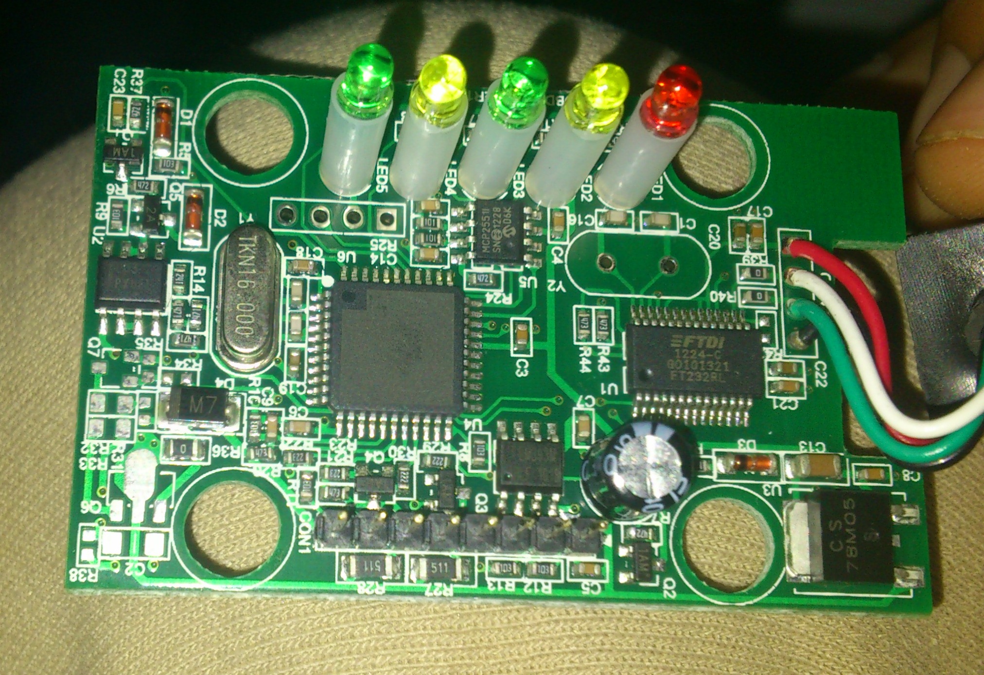

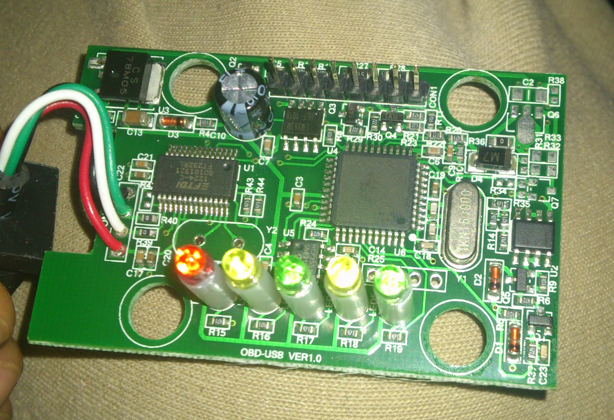

this is my elm 327
how to fix it?
how to fix it?
