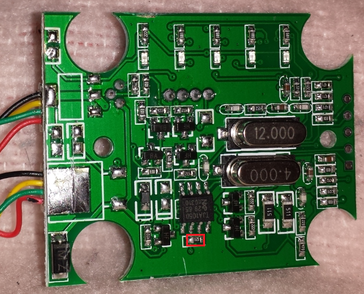

Hello Pumpingiron91
The bridge resistance I have highlighted in red frame
Who is responsible for problems with the CAN bus protocol
But even for CAN bus problems for other read error, this is not the problem
Hi Luca Rossi
Here also again, your board has no bridge resistor
I would ask at your first post already are
Which vehicle you would like to read?
Year of construction?
Control?
Your interface has no errors I can see
Control?

Oohh, and what's my job with this? Change it or only remove? If i remove than connect the 2 sides of each other? Last question, when i use the MES i can do everything only in the ECU, in other modules all time writes for me: elm connection failed.... if its important its a 2003 Stilo 1.2.

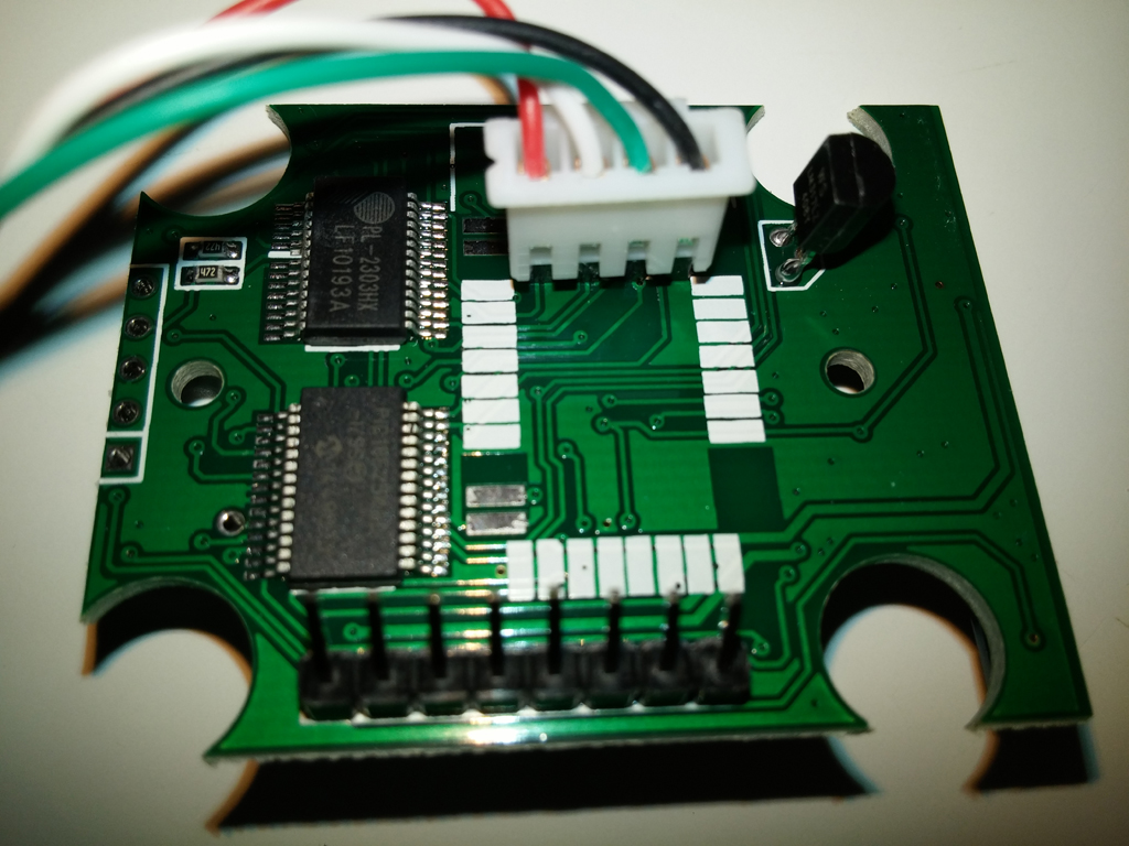

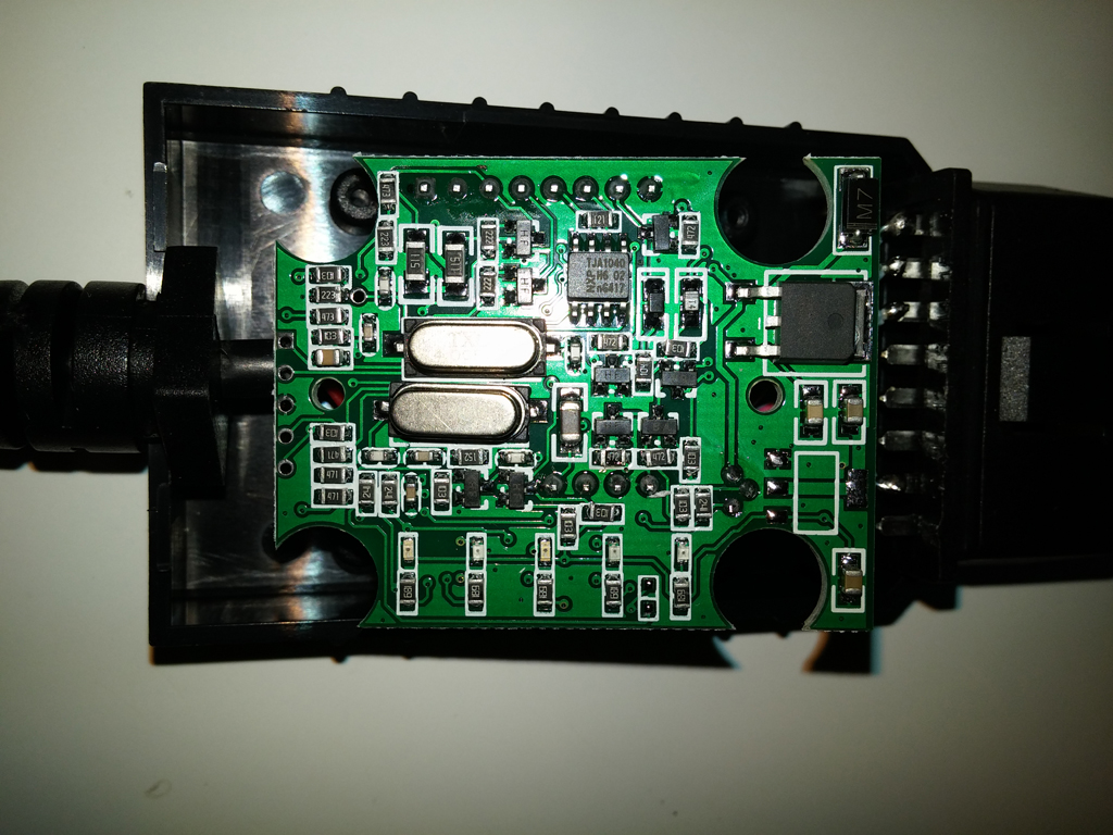

Hello!Alfaeddy wrote:Hello Tasmo
Remove the Resistor in the red Frame
and you can read the CAN Bus Protokoll
of your Car
I have a ELM327 USB with PCB like in photo.
It connect only to engine ECU, not to other ECU.
I see my interface is similiar to Tasmo's one (viewtopic.php?f=5&t=1493&start=1680),
but it has more component on the right (in my photo) that weren't on Tasmo's PCB.
How I can solve?
Thanks.
