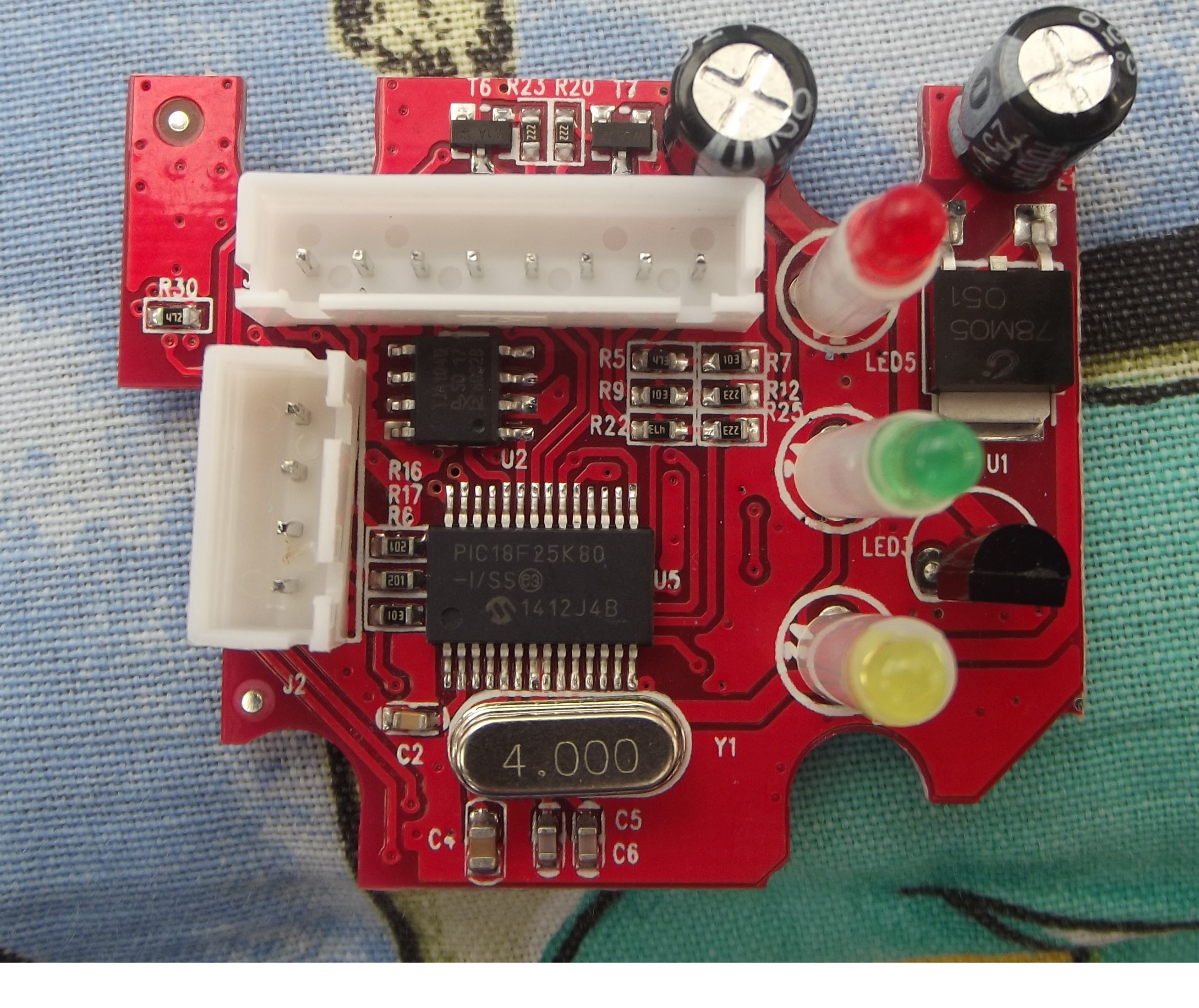

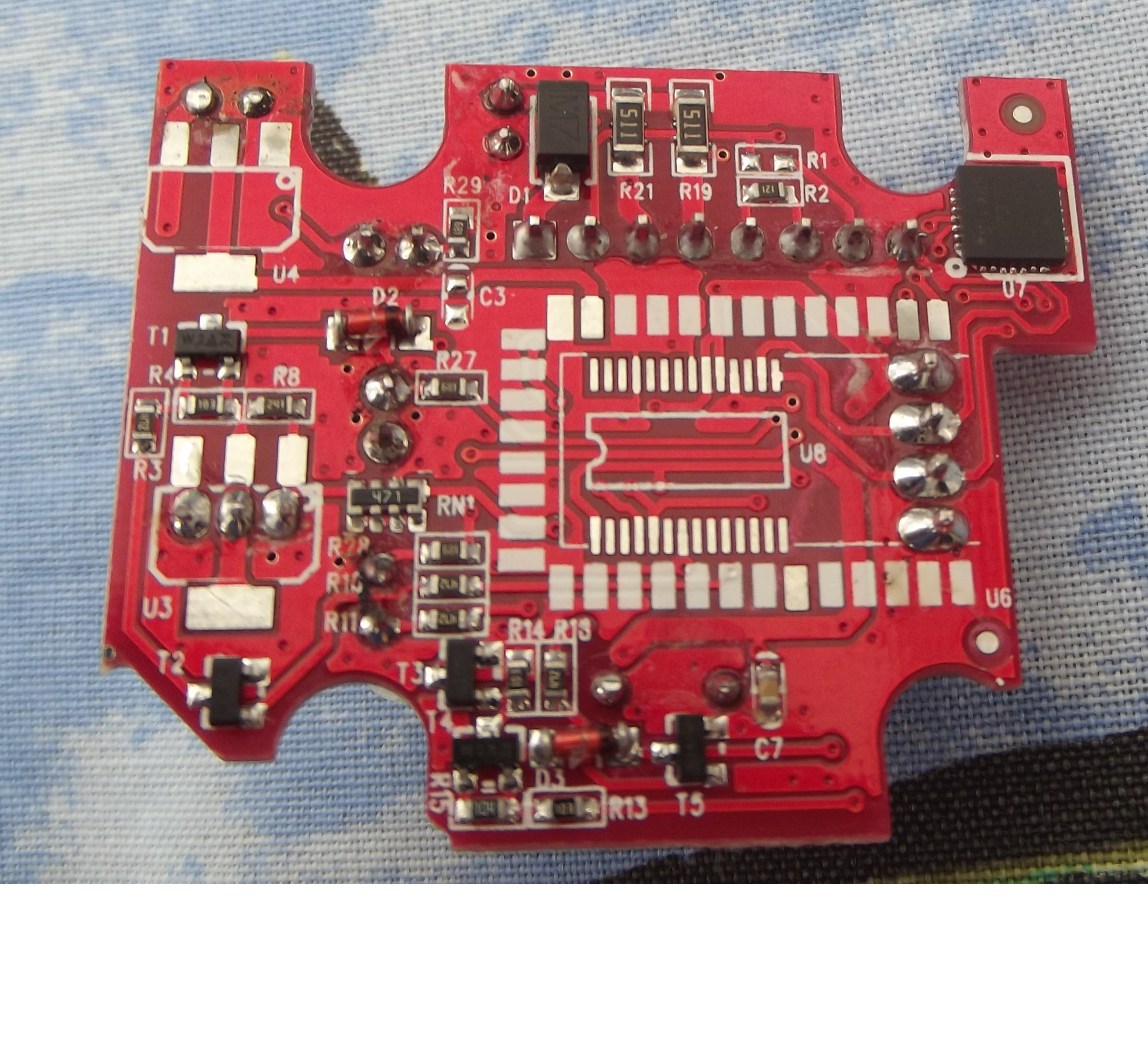

Please help me. Which is this board's resistance ?
Version 1.5a usb
Thanks.
Version 1.5a usb
Thanks.

Your interface not runs?libertyt8 wrote:Please help me. Which is this board's resistance ?
Version 1.5a usb
Thanks.

Hello libertyt8
As Walter already asked?
What does not work?
Which vehicle you would like to read?
What control?
A more detailed description can help us very much to help you.
Remove the white plug housing to please the 8pin bar
and do another picture of it

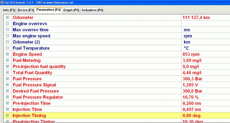

1. I can't see datas which in this photo
2.I can't see like these options " Bady, Service, Other"

hello libertyt8
Which vehicle?
And as already written, remove the white plastic base on the 8pin bar and take a picture of it
Which vehicle?
