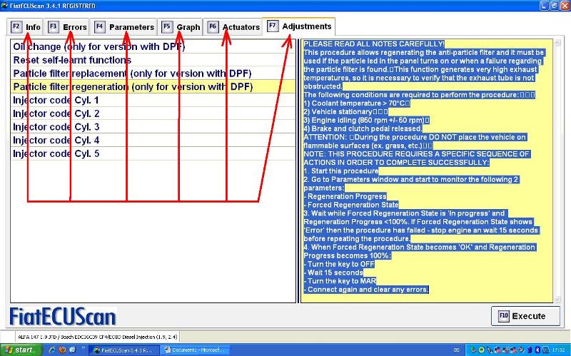

INFO - DTC - PRM - ACT - ADJ = they are all shortcuts.
INFO means information
DTC means detect trouble codes
PRM means parameters
ADJ means adjustments
and it goes on and on…
See the photo...
FES info screen - details.JPG (98.33 KiB) Viewed 3519 times

Download the software, and connect to the vehicle and module you want to cover in simulation mode (CTRL+F10).
(you don't need to have the interface cables or a software license to view everything in sim mode).
Then go to the Adjustment tab - it will show you the adjustments available on that module.
