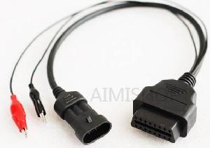

Re: What kind of hardware to buy
You still need an adapter to your access to Fiat airbag can be.
The appearance should be as shown in Fig.
The 3 pin plug into the plug for the airbag and the red and black terminals on 12 volts (red) and mass set (black)
- Fiat-Lancia-Alfa-Romeo-3-Pin-To-Obd2-Obd-Adapter.jpg (8.96 KiB) Viewed 4981 times
