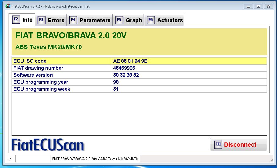

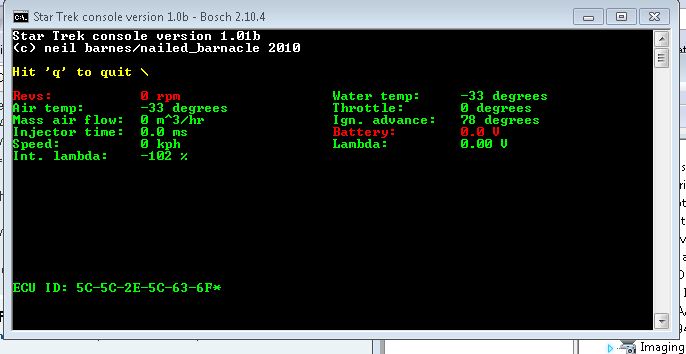

Hi Everyone, right some further information. The cables I have definitely work as I can get connected to the ECU using startrek http://www.nailed-barnacle.co.uk/coupe/ ... rtrek.html
But i want to use Fiat ECU Scan as it has more functionality, anyone have any ideas why the software wont connect? As i've mentioned in my previous post, the ABS Ecu works through Multiecuscan
Connected to ABS ecu with the cables i have with Fiat ECU Scan
Ecu conected using "star Trek" with the cables i have
