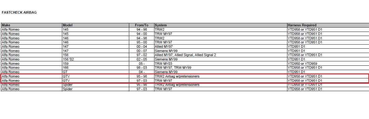

Re: Alfa GTV 2.0 16V TS 2/98 Airbag lamp
@ argtv6
@ FcnPat
I can think of yet!
Since you also sure that in your Alfa, a 97 My airbag system is installed?
Could it not be there in another TRW2 GTV Airbag system is installed.?
And on this you can not get a connection with FES.
Please check the settings and perform a scan
Airbag GTV.jpg (77.72 KiB) Viewed 5922 times
Post by argtv6 »
Hi Eddy,
this seems to be the most probable reason and I'll try and confirm this tomorrow.
In the meantime I'll post a feature request for the TRW2 airbag with pretensioners.
Thanks again.
Ralph
