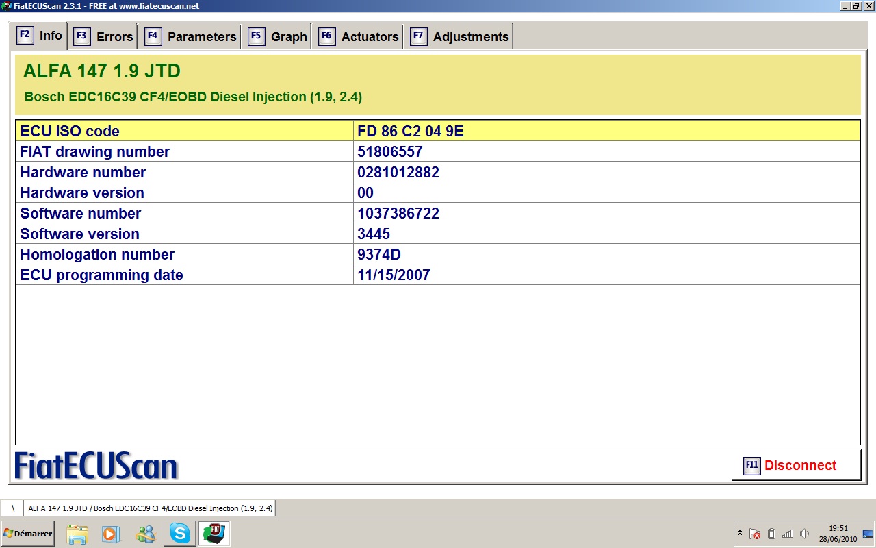

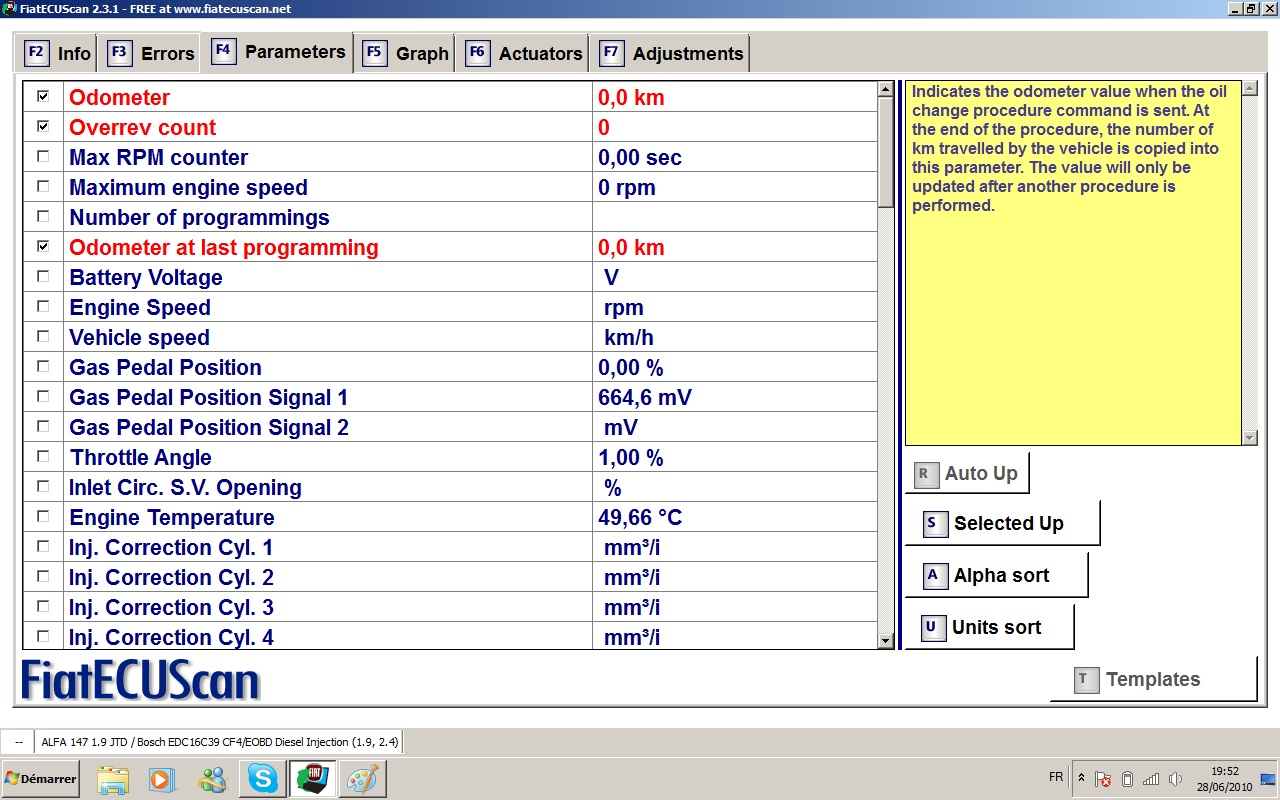

HI i have the same problem :cry: i can't read odometer and other parameters.
Sans titfggtgtgtgfffre.jpg (307.43 KiB) Viewed 6887 times
Sans titre.jpg (190.03 KiB) Viewed 6888 times
