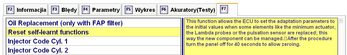

Maybe this way?
BAS

Is it possible after choosing the point "reset self learnt functions" to select the part that i have changed (e.g. the EGR or throttle). I´m a little bit angry to select this menu point whithout knowing what happens afterwards.
I´m right that the ignition must be cut of for 40 sec. after starting the procedure to zeroing the new parameters of the changed part ? :?:
