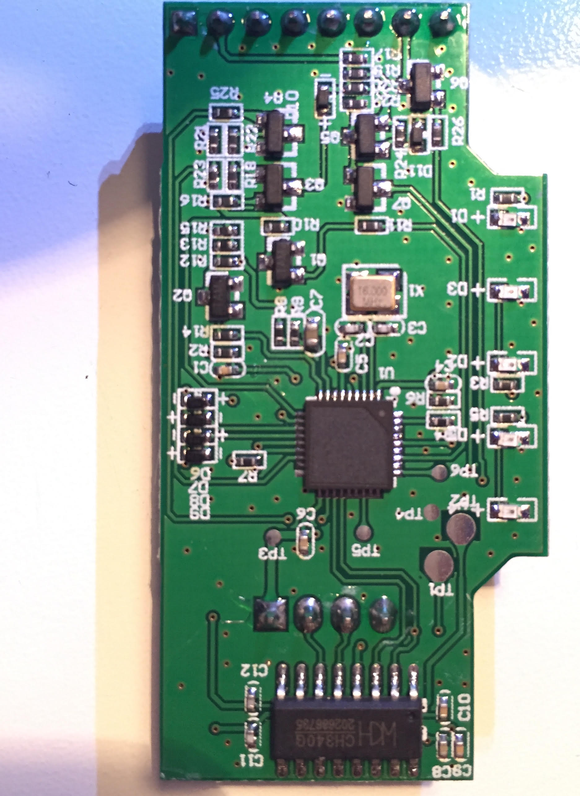

Hola!
I am trying to access to body in a alfa 147 1.6 twinspark 2004. I have an Elm327 wifi interface and can't find the famous 121ohms resistor I am supposed to remove.
Resistance between pins 6 and 14 is 50kohms (according to my multimeter).
Board is so so tiny! :?

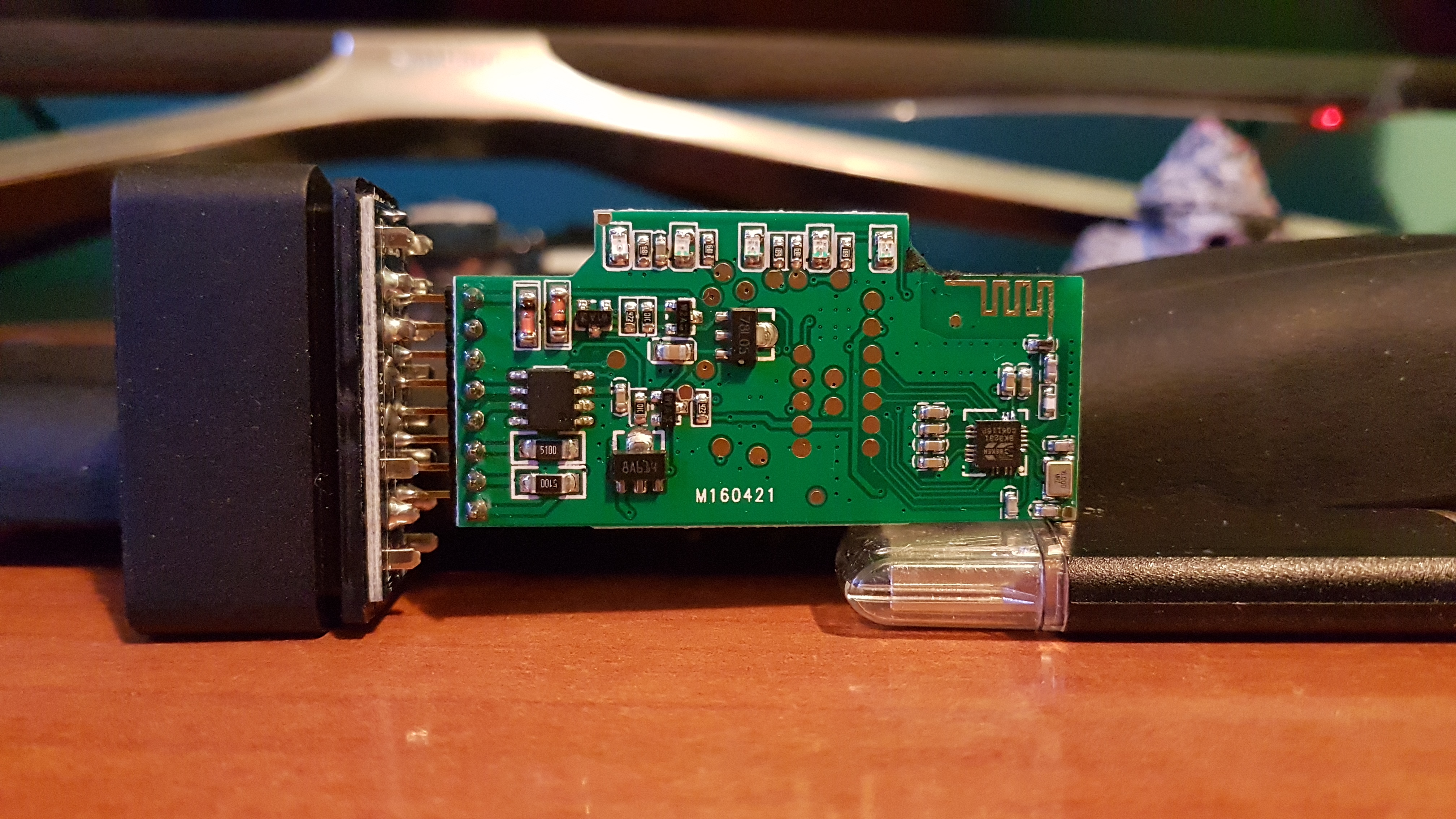

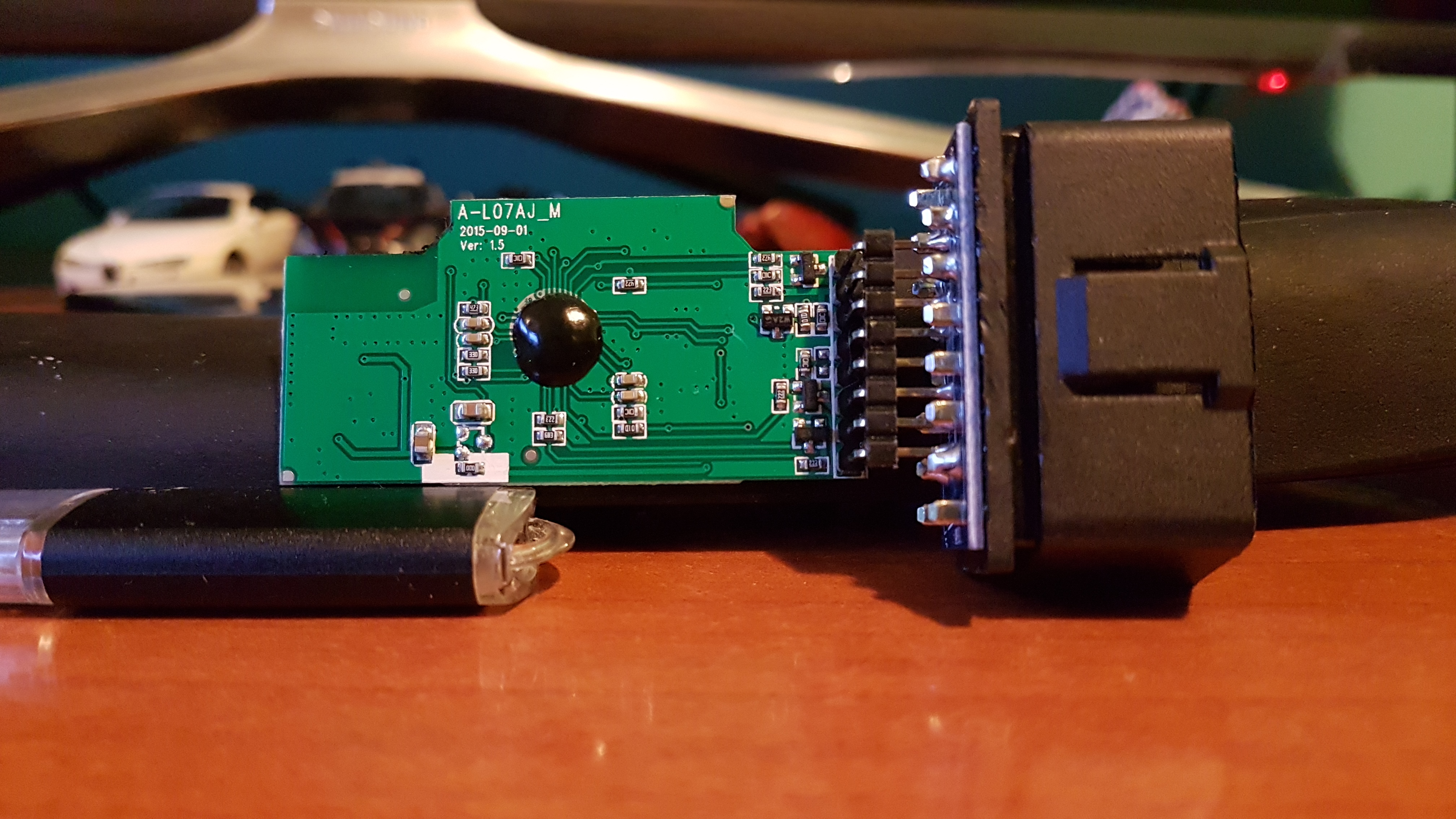

Post by rtfw61v2 »

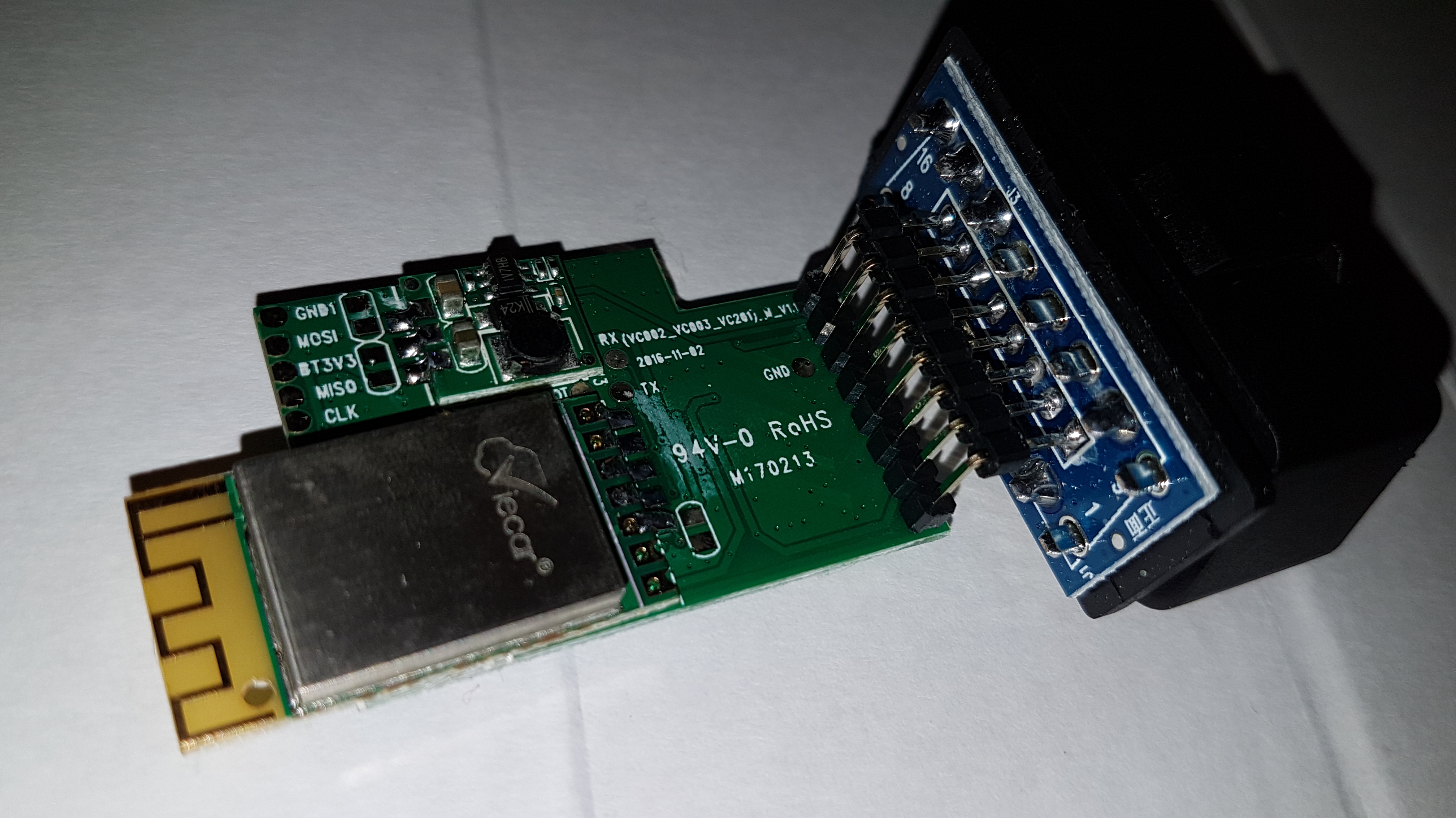

Hi guys, i have just bought this elm327 clone from aliexpress, obviously cannot works with my Alfa Romeo 147 1.6 TS 16v. There are some inscriptions on the card "A-L07AJ_M", "M160421" and "M160413". I read that it was enough to remove some resistance to make it work properly. Can someone help me?

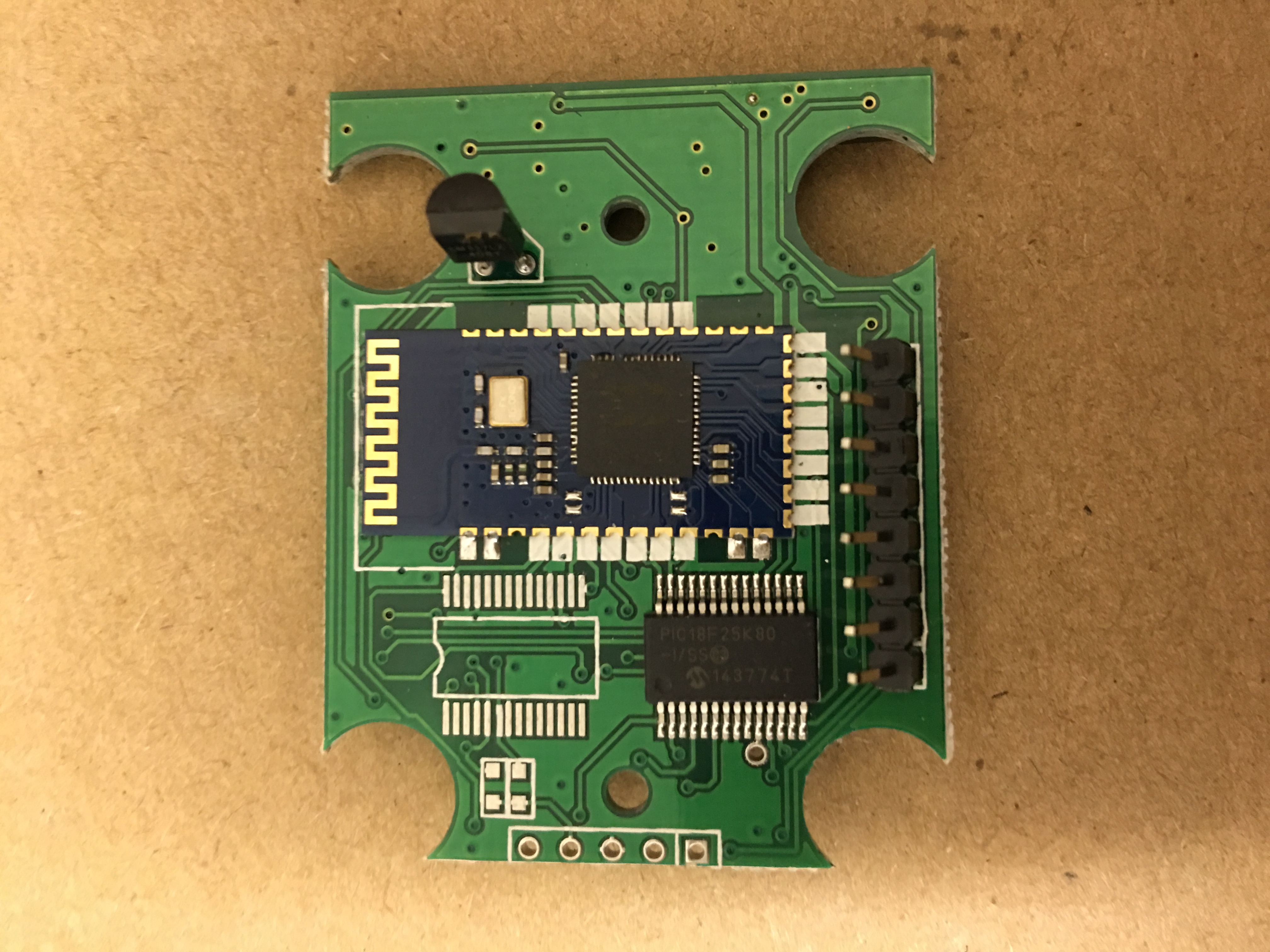

Post by PatrickH »

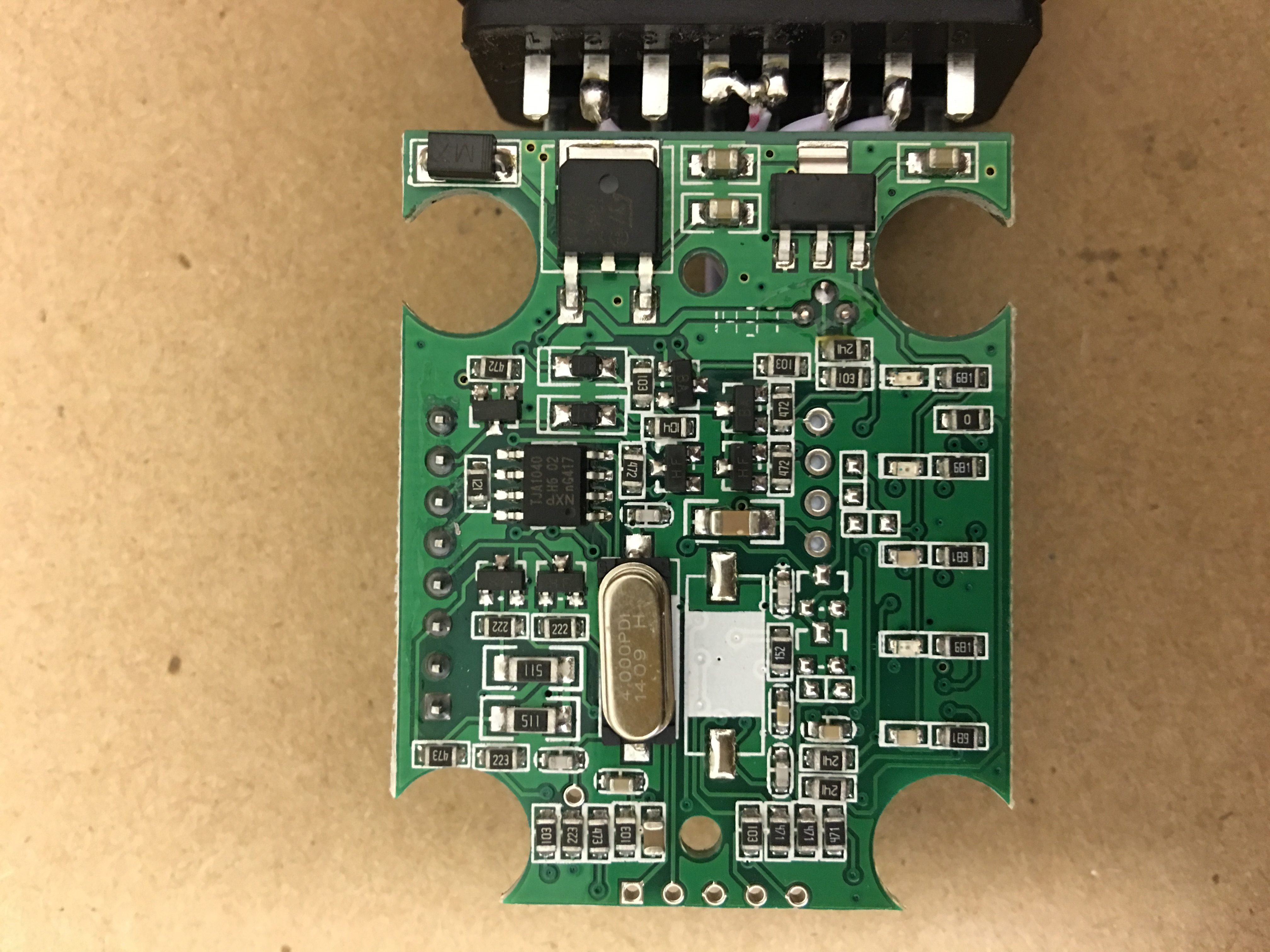

[attachment=0]index.jpg[/attachment]
Fiat Punto mk2
First registrated in 2000
1.2 8v ISO9141-2
Tryed Torque, AlfaOBD on Android and Car Scanner on Windowsphone. Car Scanner trows out a Warning "Bad ELM Clone" :o , Torque sticks in a loop trying to find "Model".
Someones got this one running?

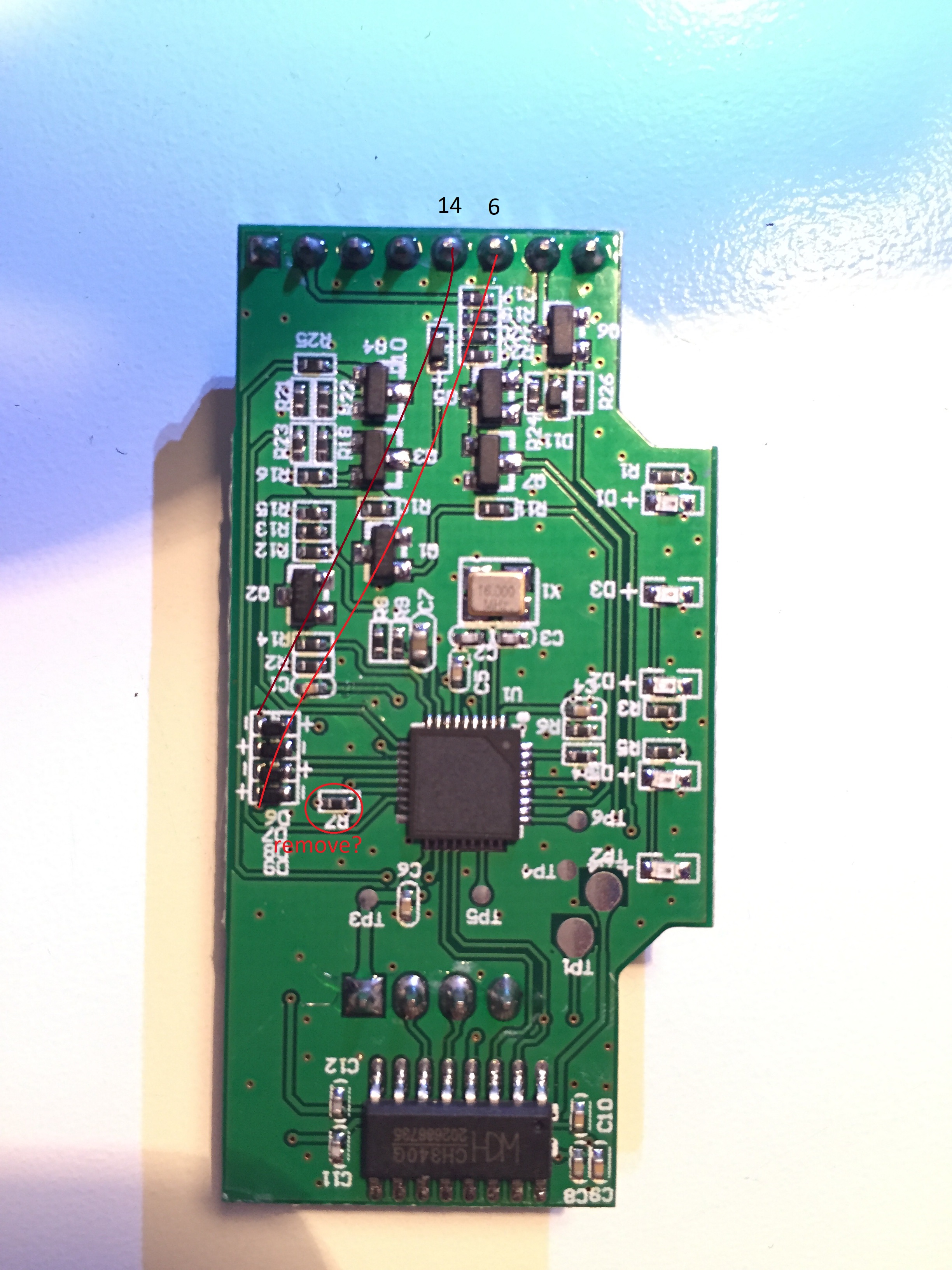

Post by Matevz251083 »
Hello All I am Matevz from Slovenia, Ljubljana. I have bought this elm, it says V1.5a but no labels inside. What resistor do I remove? It connects bosch electronics in alfa 159 but then nothing so I need to remove resistor. I havent seen such elm hire.
Thank you for your help!
Matevz251083
Joined: 13 Dec 2017, 18:24

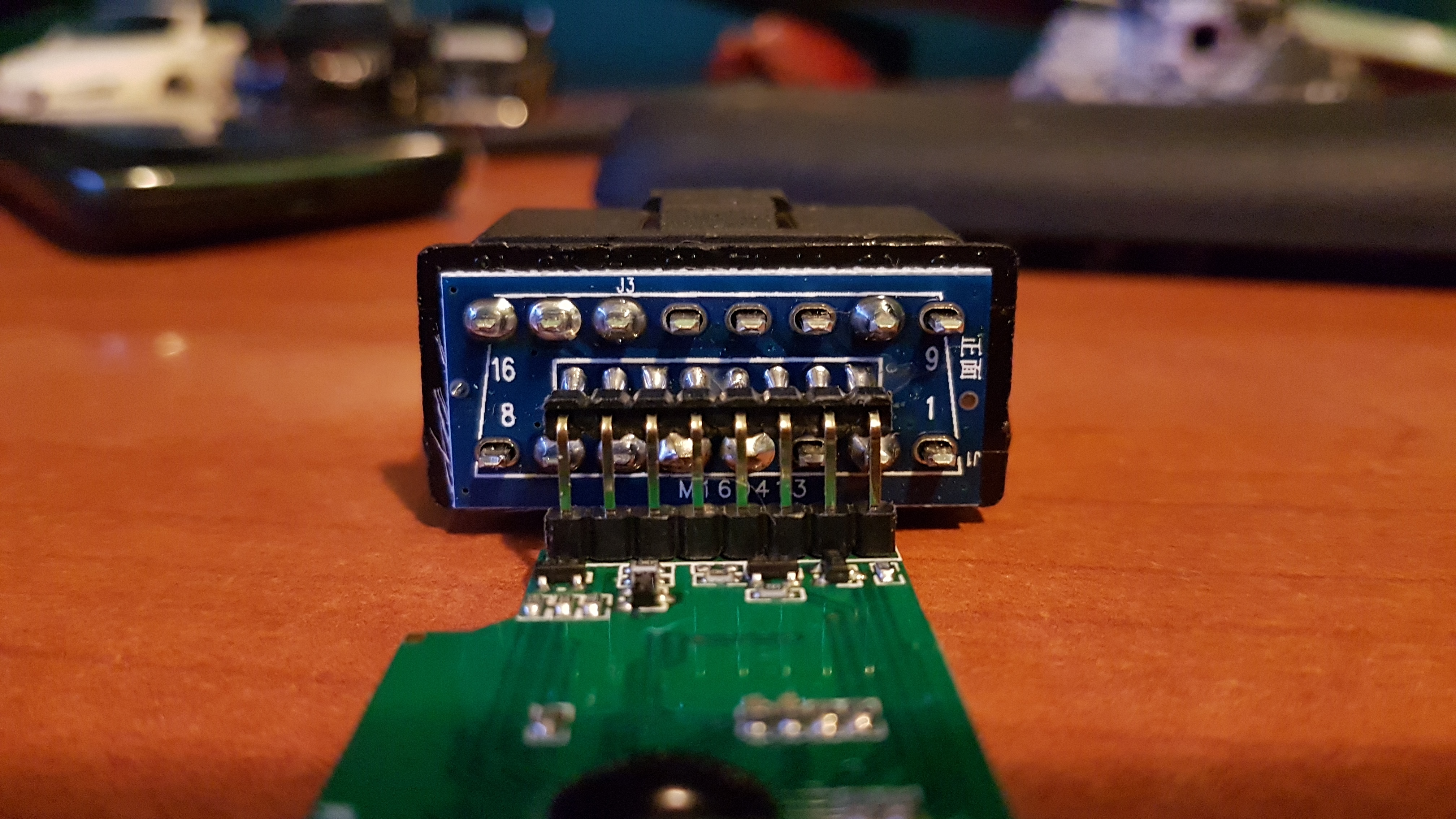

Hello me again, is this the rigt resistor to remove? pins 6 and 14 comes out where its marked and then they share this r7 resistor. Do I remove it? I think so. Thank you! Sorry for bad picture.
Matevz251083
Hello I have uploaded pictures where pin 6 and 14 goes to R07 but they didnt post them. So I think its R07 to remove. Am I right?
Tnx
Matevz251083
Well I ordered another one this time modified for alfa from german seller.You dont know what you get from china...No response hire, just i dont know would be fine...

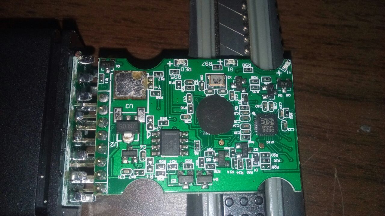

Post by Sbt74 »

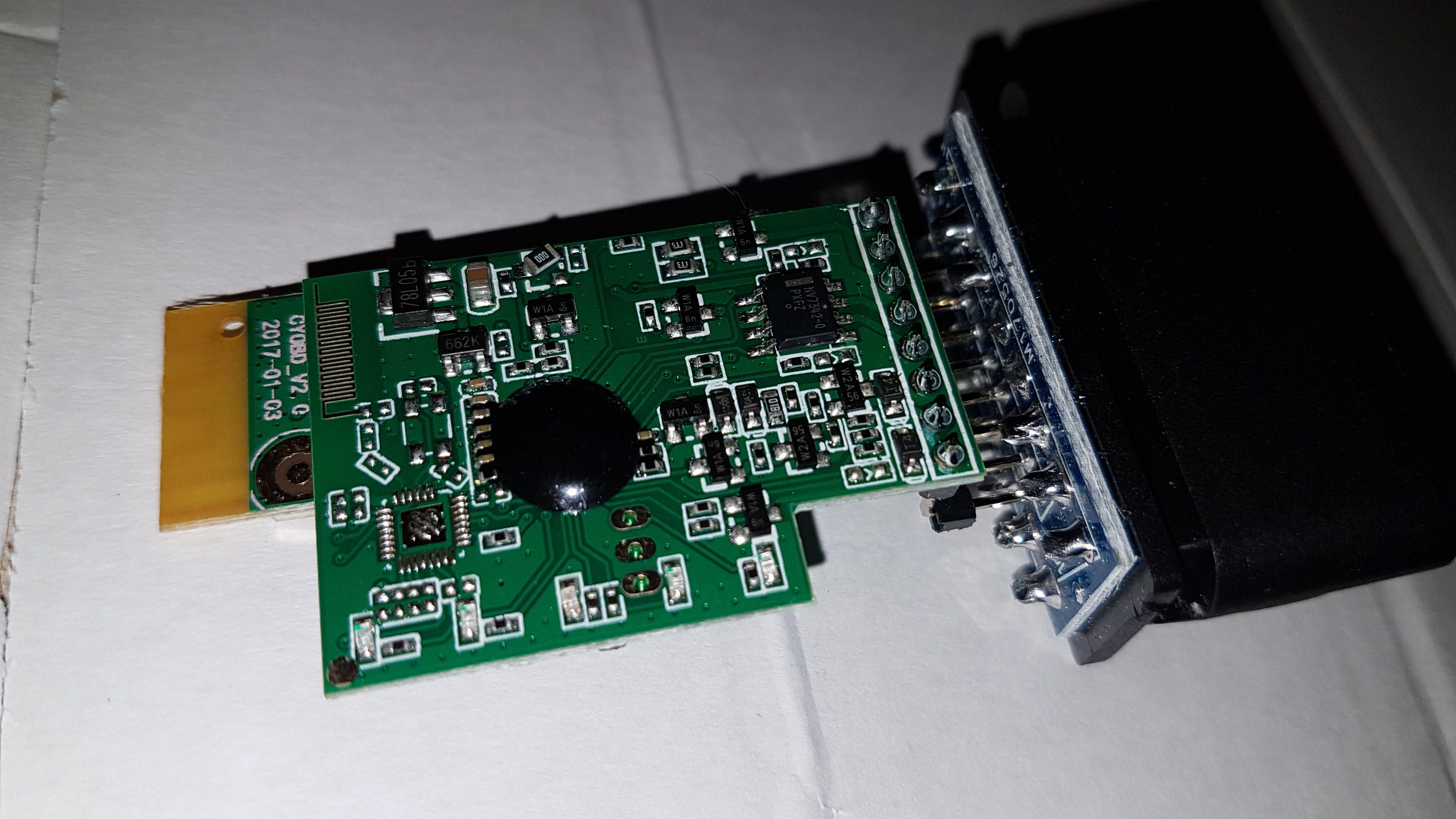

Hello to all
I am new at this forum and would like to thank you all for all the information you are puting here.
I have bought elm327 (becouse of info on this forum) but i can’t find any like mine. Can anybody help me with this one? Do i need also replace anything or remove?
Thank you
