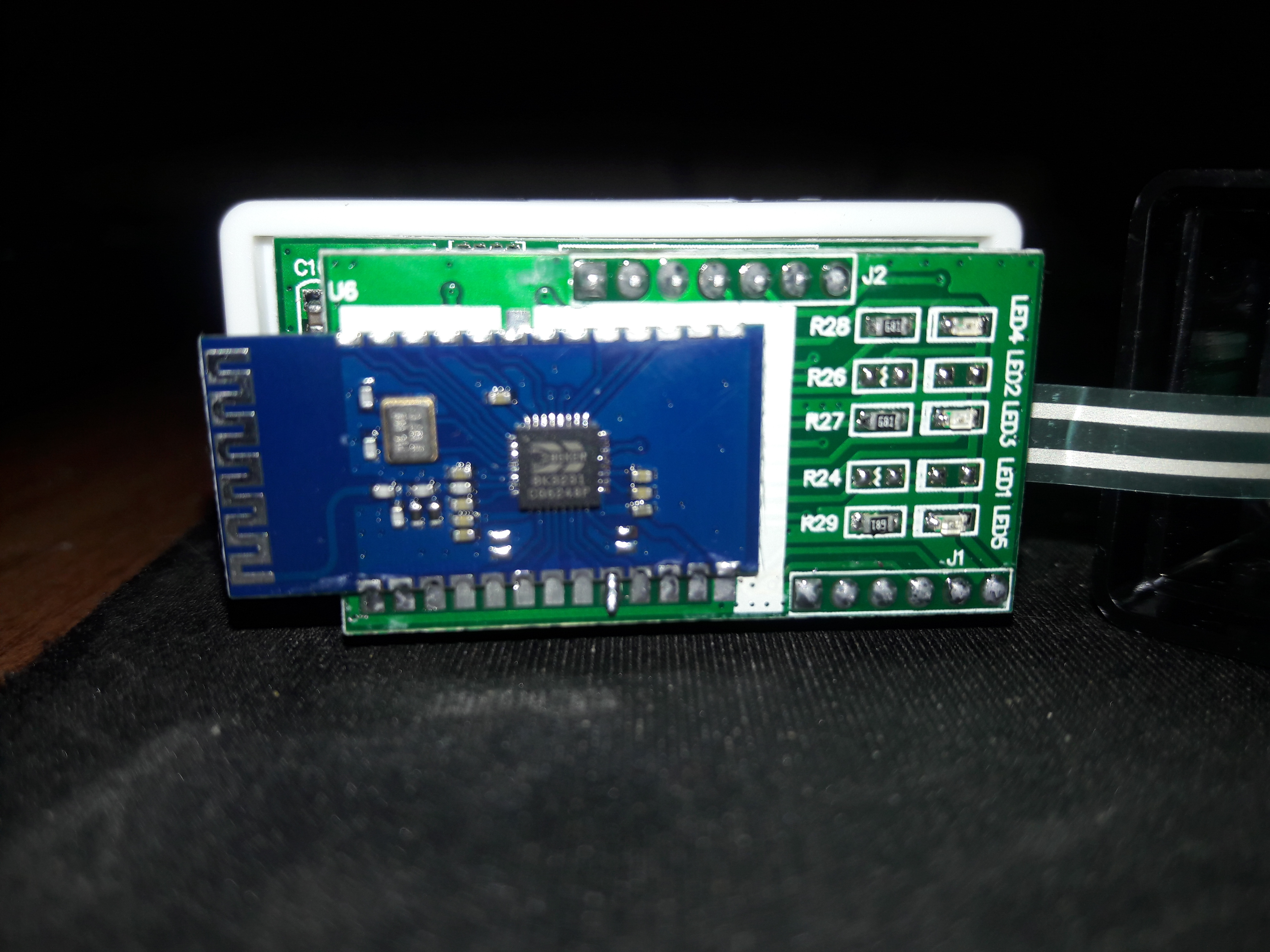

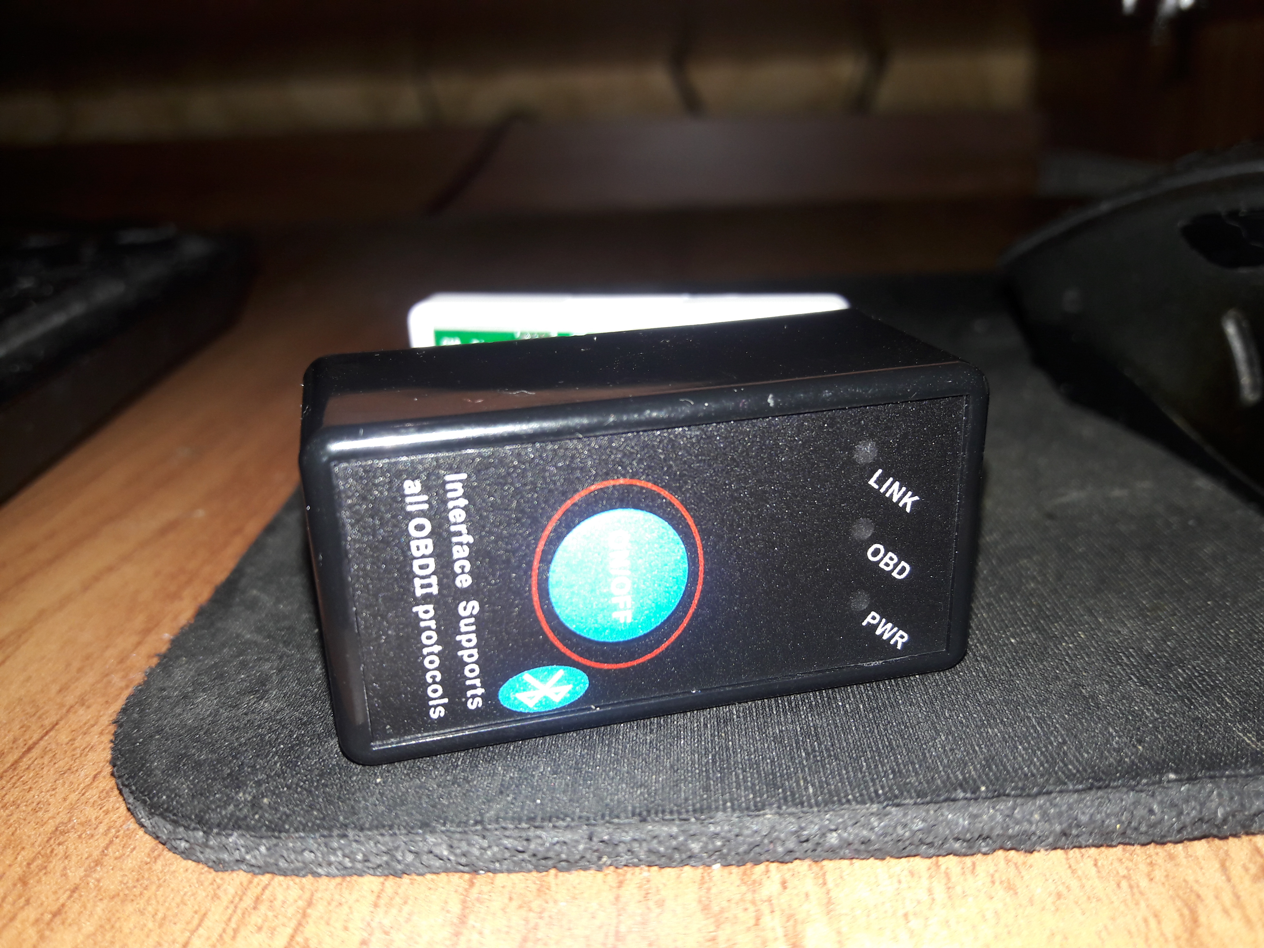

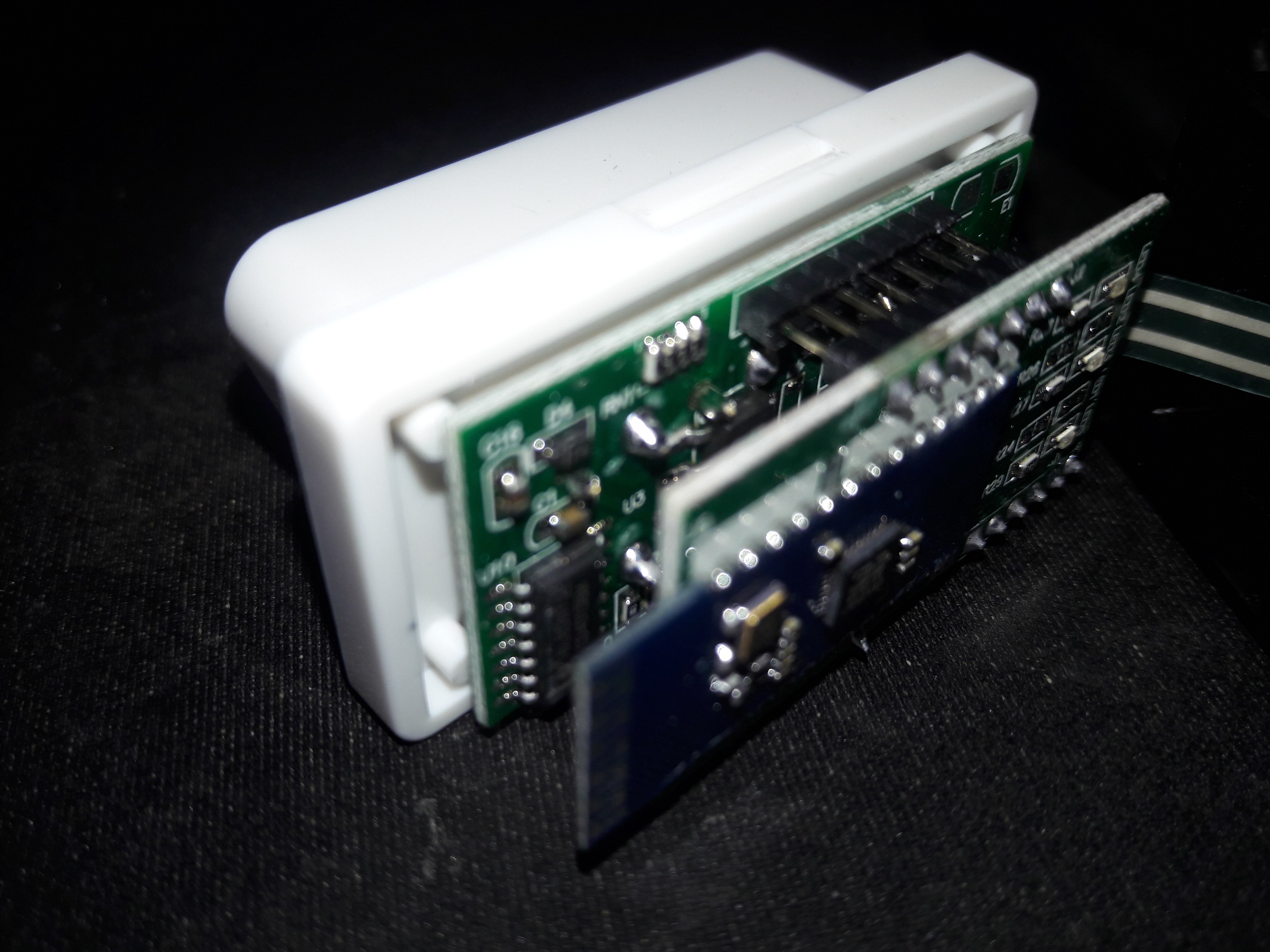

boblelie wrote:
Alfaeddy wrote:Hello Boblelie
Sorry this ELM no works with MES :(
Hi Eddy,
Thx for your feedback. sucks monkey balls though .... :(
can you recommend a elm327 clone (preferred bluetooth) that will work, or will work after some modifications?
i've ordered 3 totally different ones by now and none of them work on my alfa 159 :( .
This one
http://www.ebay.de/itm/152303739535?_tr ... EBIDX%3AIT

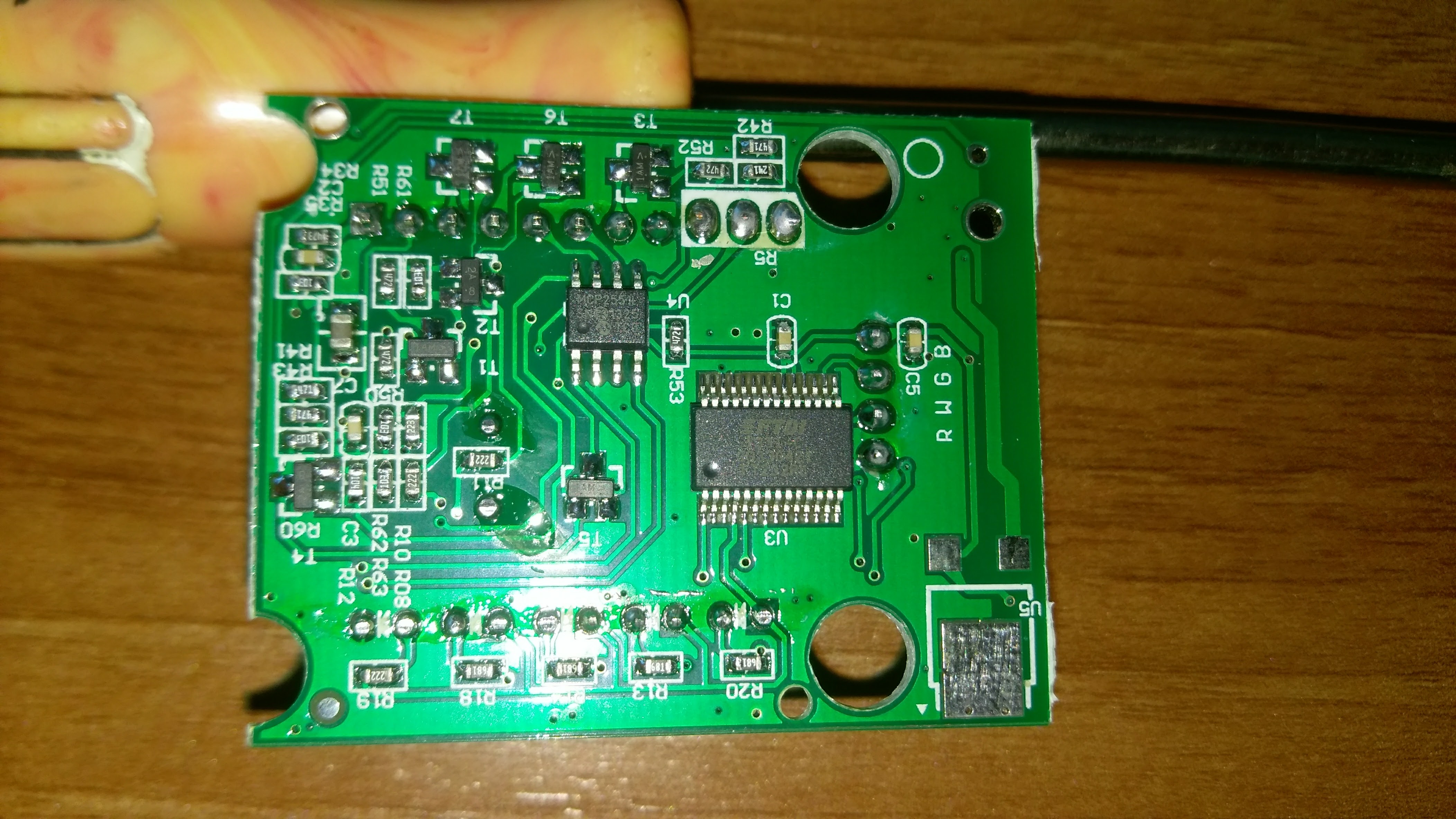

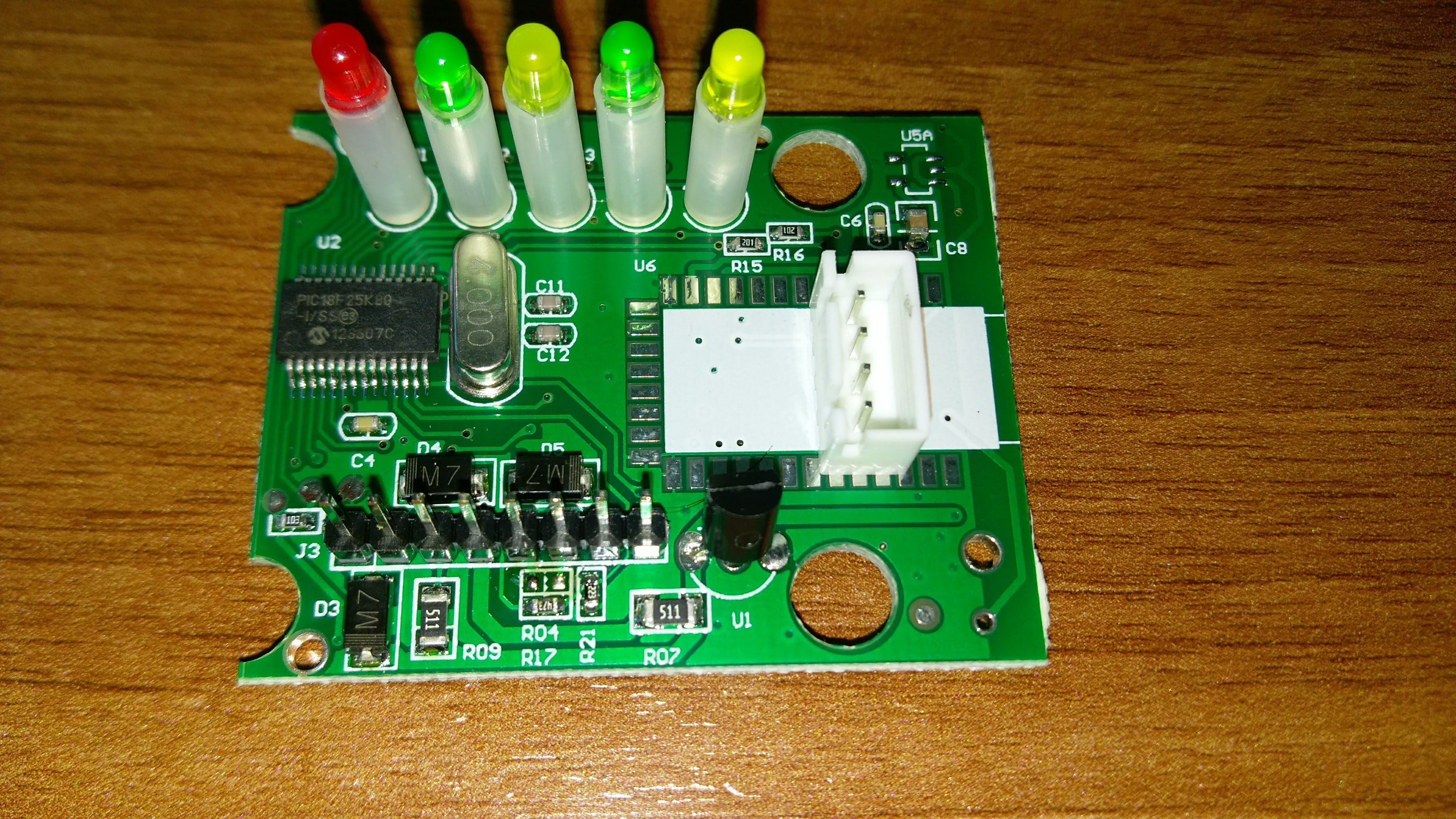

I Have an Alfa 159 and i have always connected successfully with my ELM v1.4 cable to all modules - except ABS of course - for it I use VAG-Com cable with switch.
Unfortunately I changed my laptop recently and now I cannot connect to all modules, although I use the same cable, on the same car, with the same version of FES.
Now I am able to connect only to the engine and the Gearbox ( Aisin - automatic). I am not able to connect to Body or to Service, nor Parktronic or any of the doors' ECUs.
I have opened the ELM and I see that the resistor ( R04), that usually makes this problem is not placed by the producer on the first place - that is why I had no problems with my old laptop.
The only difference now is that all USB ports on mu new laptop are 3.0 - which actually should be better, as far as I know.
I am posting some images of the interface.
Can you give me any idea what to do?
This is very strange ????
At the interface it is not.
Since it has worked with your old laptop.
The bridge resistor (R4) is not available.
What driver did you use?
Please use this,
Has your laptop only 3.0 usb
Mine also has 2.0 ports
Although I do not believe this is a problem.
Make times a screen of the interface test and set this here

bigwolfys wrote:Hello. Who can faced with elm327? car Fiat Punto 2 1.2 v8 2000 read only engine. Where it is installed this resistor?
I understand need to unsolder the top board and see what is on the bottom?
And again, to connect to your Motorecu of the Punto, no Resistor must be removed.
Since the motor is not read via CAN bus.
If it does not work, then also with other protocols not.
The resistor of the possible CAN problems is below the first board
