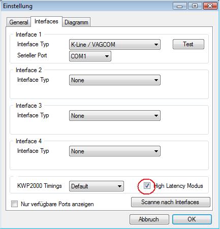

Have you ever tried it and a tick in the box marked "High latency mode" set?
What then are the values ​​when you press the test button on the interface?

Thanks for the reply! Indeed, I forgot to mention, I also played a bit with "high latency modus" and the various timings settings.
Unfortunately I don't have the equipment here with me, but what I recall from memory, Test is done at 4 or 5 different times (something at 1000ms, 400ms, 100ms...), and the response was everytime plus or minus 1ms from those tested times. Which indicates good functioning, or not?
