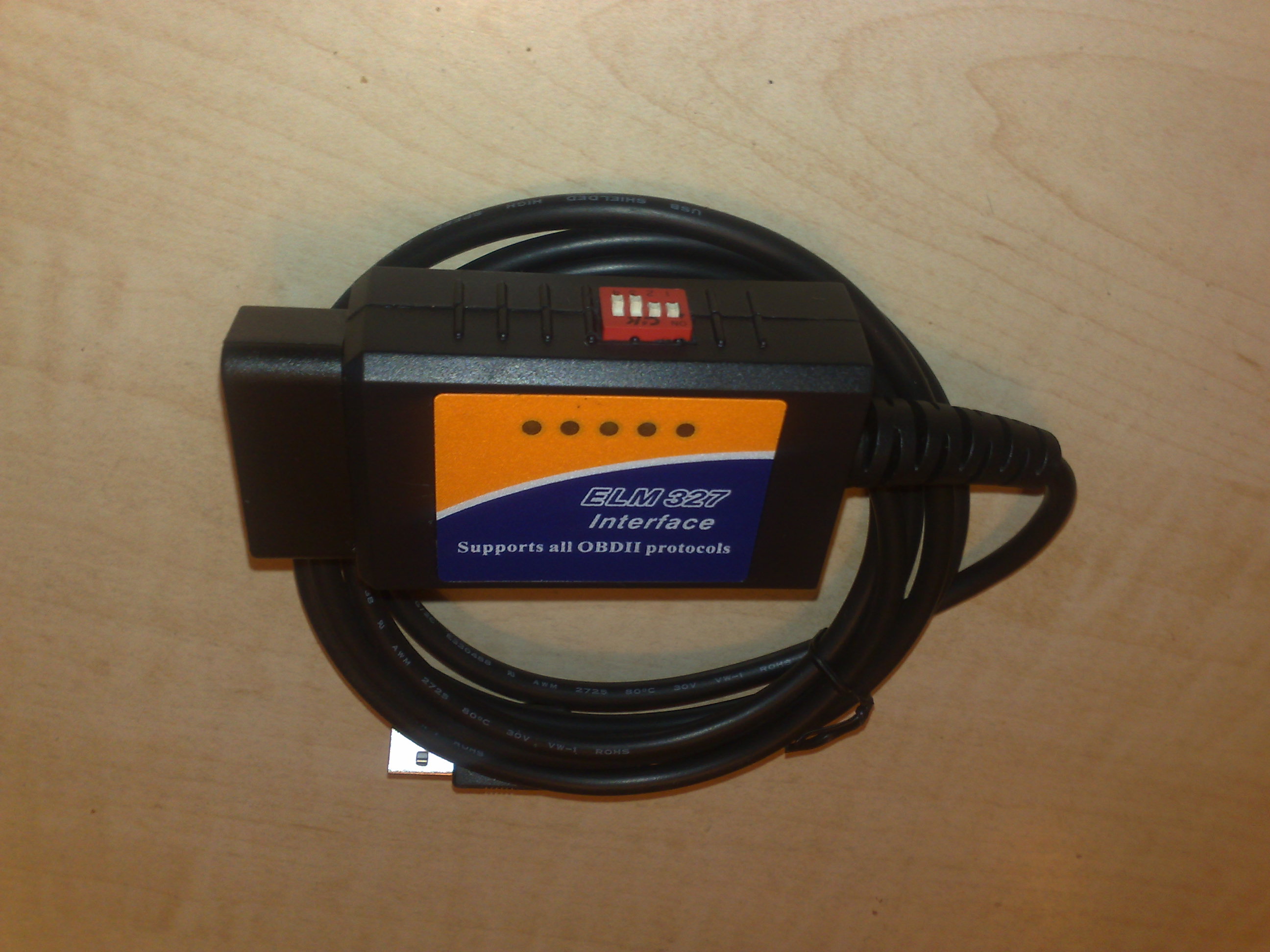

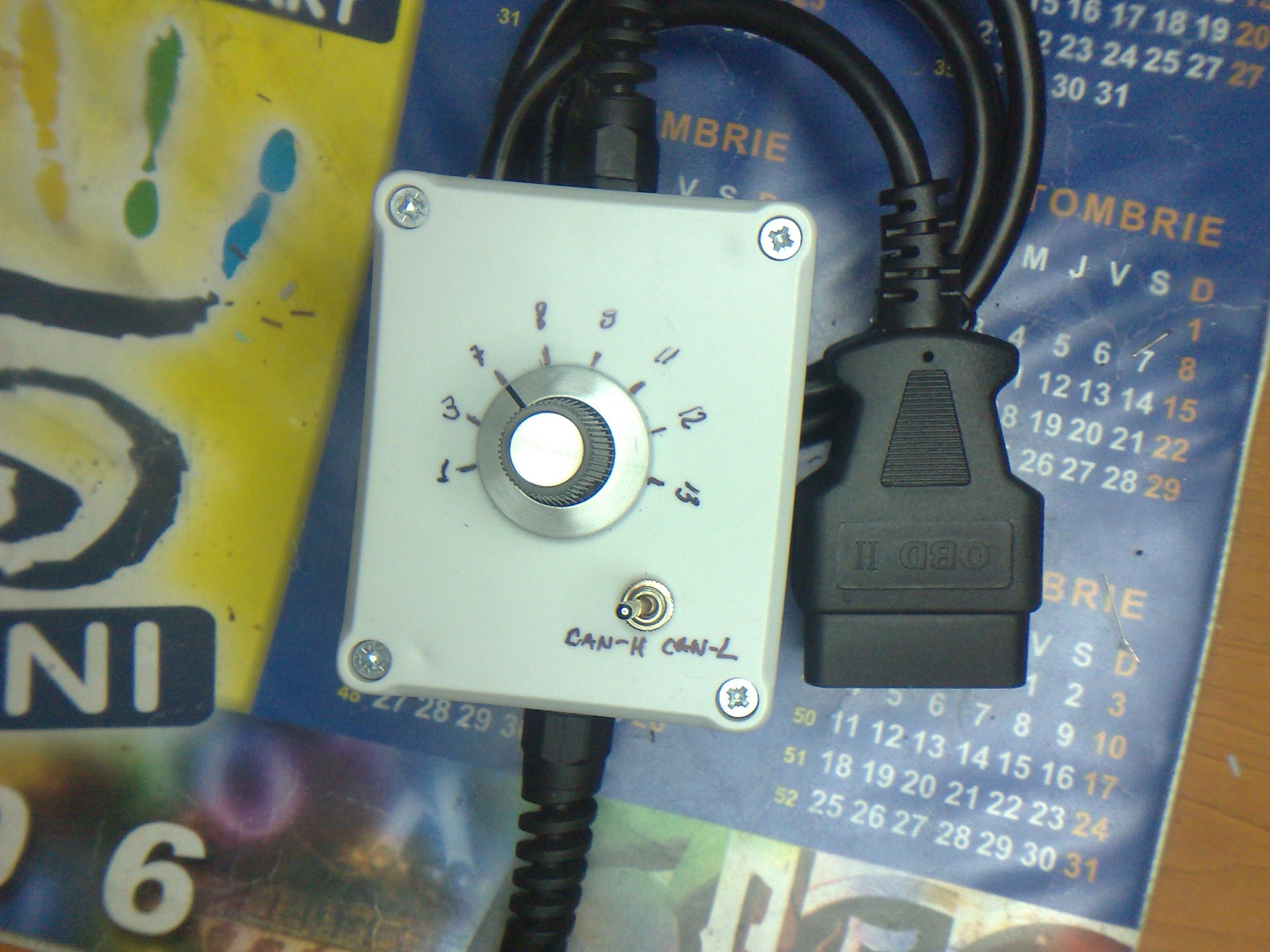

You can make this change between CAN 1 and CAN 2 using a DIP switch directlly into the interface or you can use an external adaptor
Take a look in the attashament
1. its a modified ELM327 with DIP Switch and you can switch pin 6 to pin 1 and pin 14 to pin 9
The other one it is a manual multiplexor where you can switch all k-line used in Fiat/Alfa/Lancia cars ( including the pins that are not used yet in Multiecuscan ) and a switch for CAN .
This both are made by me.
- multiplexor Fiat.jpg (676.68 KiB) Viewed 1289 times
- ELM modificat.jpg (545.99 KiB) Viewed 1289 times
