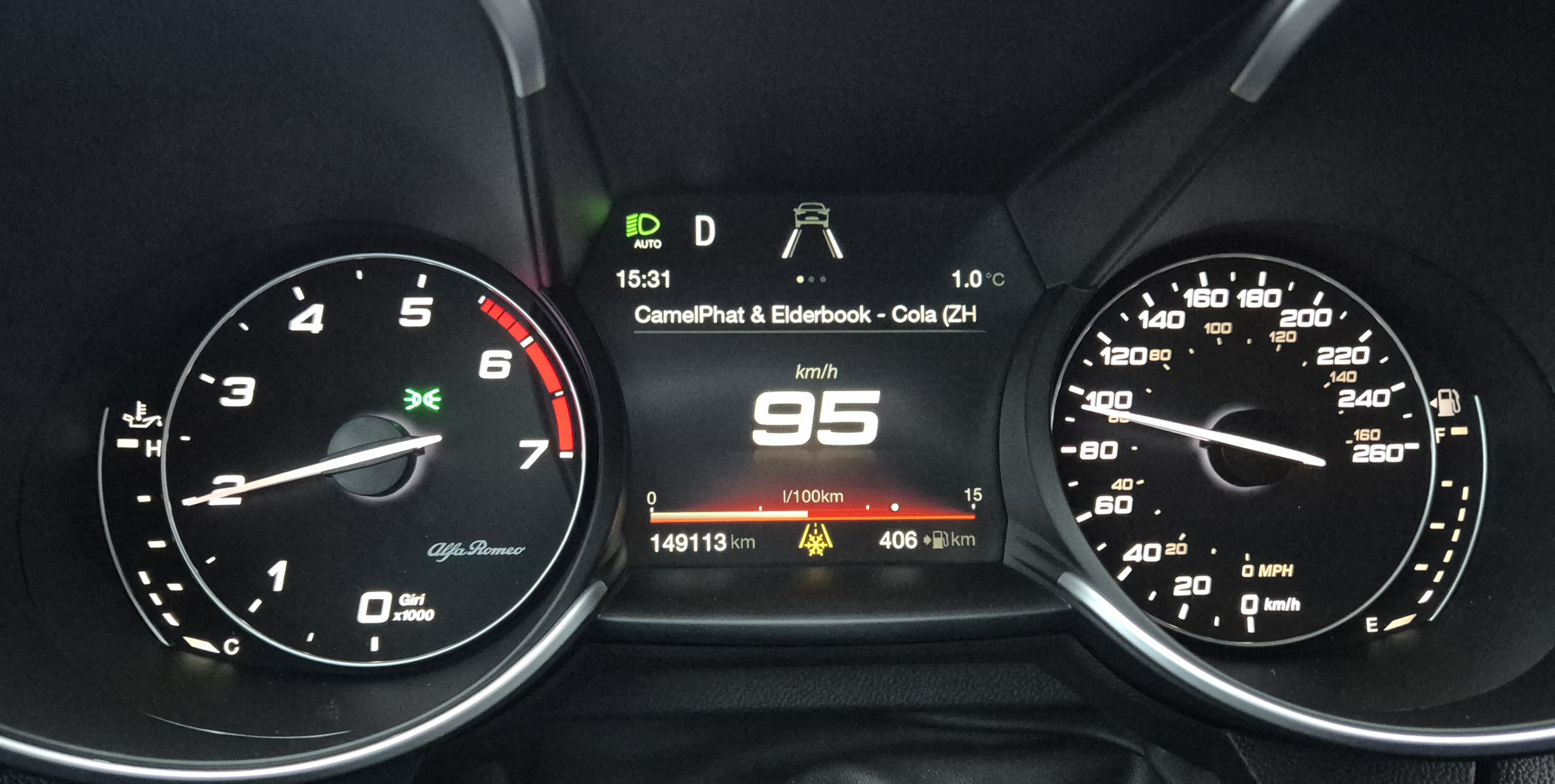

Did the same swap (3.5" to 7") to band new Cluster and same problem. But missing ACC info also. ACC works fine, but no info at screen.

Almost there: Now i see full song names but missing still acc info. Lane keep assist works (shows) fine.

is ACC working? can't see anything in proxi what should cause it not to show up.

yes. ACC works like it should. In the pictuse ACC was on also.
I have 2 Errors in Insturment panel U1736-86 and U1736-87

UPdate:
Went to local dealer and they did instrument panel update. That fixed the missing ACC info on top. All working now.
Thank you shpuncik for the proxy code before.
