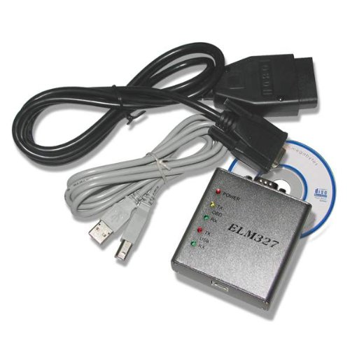

Hello! I try to connect to my Alfa 159 ECU with MES4.4 using this interface:
When connected I get "Invalid ISO code" and in the info section I can see some data about the ECU but all the numbers are shifted to the right and some junk is displayed.
https://www.dropbox.com/s/zvmlrb1lpr6csx0/MES%20reading.jpg?dl=0
Data is not read correctly as well. For every numeric value I get 4139.
If I try to read the ecu with the same interface but with another software it works and I get:
Tested device: Injection Diesel Bosch EDC16C39 CF4/EOBD (eng. 1.9/2.4)
___________________
DEVICE INFO:
Fiat drawing number: 55204661
Hardware number: 0281013138
Hardware version: 00
Software number: 1037380494
Software version: 3441
Homologation number: 93942
ISO code: FD863D0419
Programming date: 00/B5/80A4
______________________
Do you have any idea what could be the problem?
Please excuse me if it's something you've already discussed but I couldn't find something on that subject here.
Thank you!
