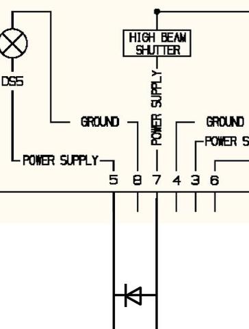

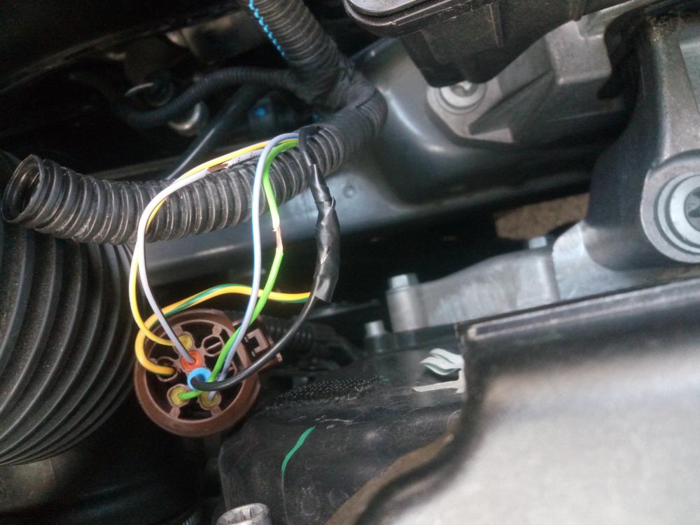

There is any modification to BC. Orginal Xenon lamps are plug&play to a car body and connector is the same. Only there is necessary to put diode STTH3002 between pin 5 and 7 according to following diagram
500x_Modifica_Xenon
500x_Modifica_Xenon
and put mass to pin 8 according to attached picture

Just one question. What is the purpose of making the ground pin8 thicker?

I don't understand your question about thicker mass.

Wiring for xenon lamp below.
