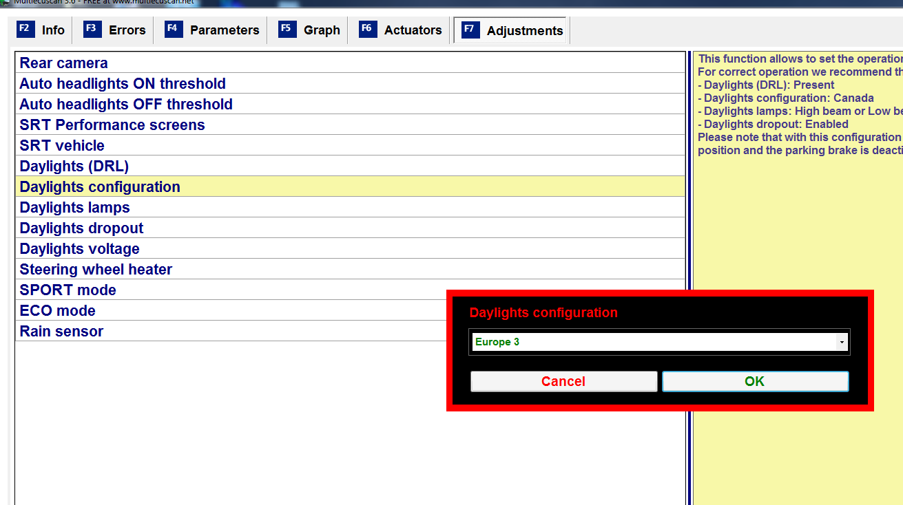

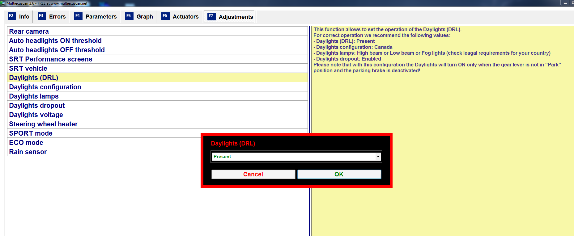

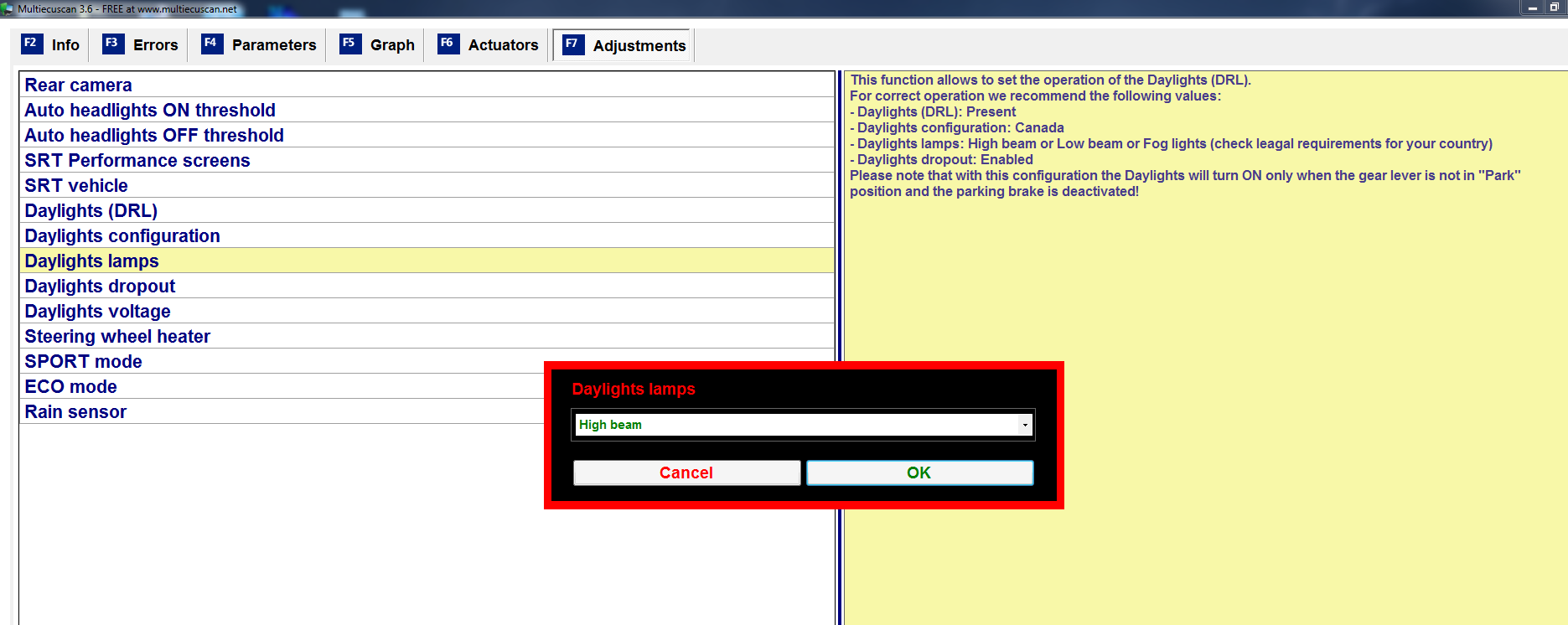

After long time looking for a proper way to configure the DRL. I'm posting the screens to follow. It will integrate with Uconnect DRL option, which means that you can swithc on/off from the Uconnect 8.4 (not sure about 4.3)
- Be sure to follow the country legislation
- drl-config-3rd.png (78.52 KiB) Viewed 11171 times
- drl-config-2nd.png (54.76 KiB) Viewed 11171 times
- drl-config-1st.png (78.32 KiB) Viewed 11171 times

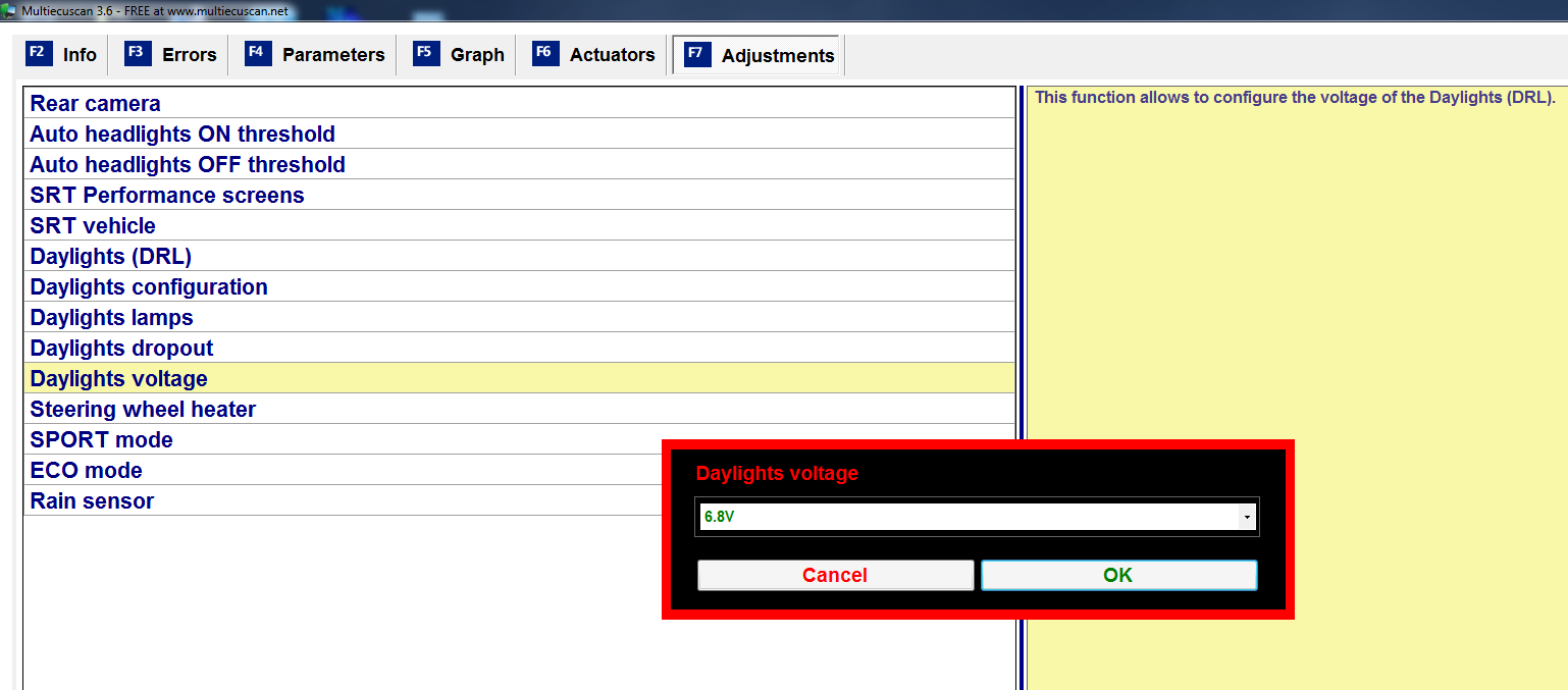

Now the voltage part..
Itapplies to cars that follow Europe standards.
- drl-config-4th.png (59.66 KiB) Viewed 11170 times

Interestingly, but for me "Europe 3" doesn't work and doesn't show up in UConnect (8.4N).
I presume, if it was in Uconnect, then I could possible be able to switch it ON, but, no matter what, I don't see DRL option with "Europe 3".
On the contrary, "Canada" forks for me fine (high beam @ 6.8v + dropout, but there are no options in UConnect).
Could it be the version of radio software which makes the difference?

That's the difference between canada and Europe 3 - Canada , as per their legislation, they can't turn the drl off and should keep on all the time.. Europe3 can shutdown and allow uconnect to manage itOn the contrary, "Canada" forks for me fine (high beam @ 6.8v + dropout, but there are no options in UConnect).

That makes sense!..haffonso wrote:That's the difference between canada and Europe 3 - Canada , as per their legislation, they can't turn the drl off and should keep on all the time.. Europe3 can shutdown and allow uconnect to manage it
Now I would like to find out why "Europe 3" isn't working in my car (and DRLs aren't shown amoung UConnect settings), although I'm having a European car, actually (and also given that Canada works for me).
haffonso, what version of UConnect radio software does your car have? Have you ever updated it? Because I did several times, after updates were made available. I'm currently running 15.09 and there's version 16.21 available also, which I haven't installed yet but thinking to do so.

euro3 you should see lighting wheb release the foot break and change from park to neutral
Re: Freemont - Configuring DRL
Euro3 just works when release the "foot breaker" and change the gear to out of P, if it doesnt show in Uconnect might also not work maybe the uconnect should have a update or if its 4.3 iguess it downst have such option.keebo wrote:That makes sense!..haffonso wrote:That's the difference between canada and Europe 3 - Canada , as per their legislation, they can't turn the drl off and should keep on all the time.. Europe3 can shutdown and allow uconnect to manage it
Well, as I was saying, for me, unfortunately, Euro3 doesn't work no matter what: no lights, no uconnect settings
Canada mode works fine (sure I need to move gear out of P and depress Brake pedal), but there's no UConnect option, as we discussed before, and I would love to have it.
I've got uconnect 8.4N, with latest radio software installed.

Hi All,
DRL works fine for me in both canada and euro 3 modes but whatever I tried, I couldn't get the unconnect option to on-off day time running lights.
any advise?
any advise?
