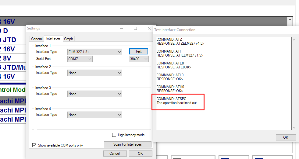

I have an error while connecting to my Punto '03 1.3 MJT with this interface (https://www.amazon.it/KKMOON-V1-5-Inter ... ords=obd+2). It is an ELM327 V1.5 and when I tried to test it I got a connection timeout on ATSPC.
The interface uses CH340 series chip and ISO 142303-4, I checked these values with ScanMaster-ELM which works and recognize the interface.
How can I solve this?

Try again with other baud settings!
But probably the V1.5 ELM will not work with MES.
For the v1.5 it is very different some work different unfortunately not

So there are not possibilities to get it working? Should I modify it or I need to wait a support into a newer version of MES?
Re: ELM V1.5 ATSPC error
No, unfortunately, no chance
Since version v1.5 is a purely Chinese variant.
This version never existed from ELM elektronics

Does u found a fix? I have the same problem
