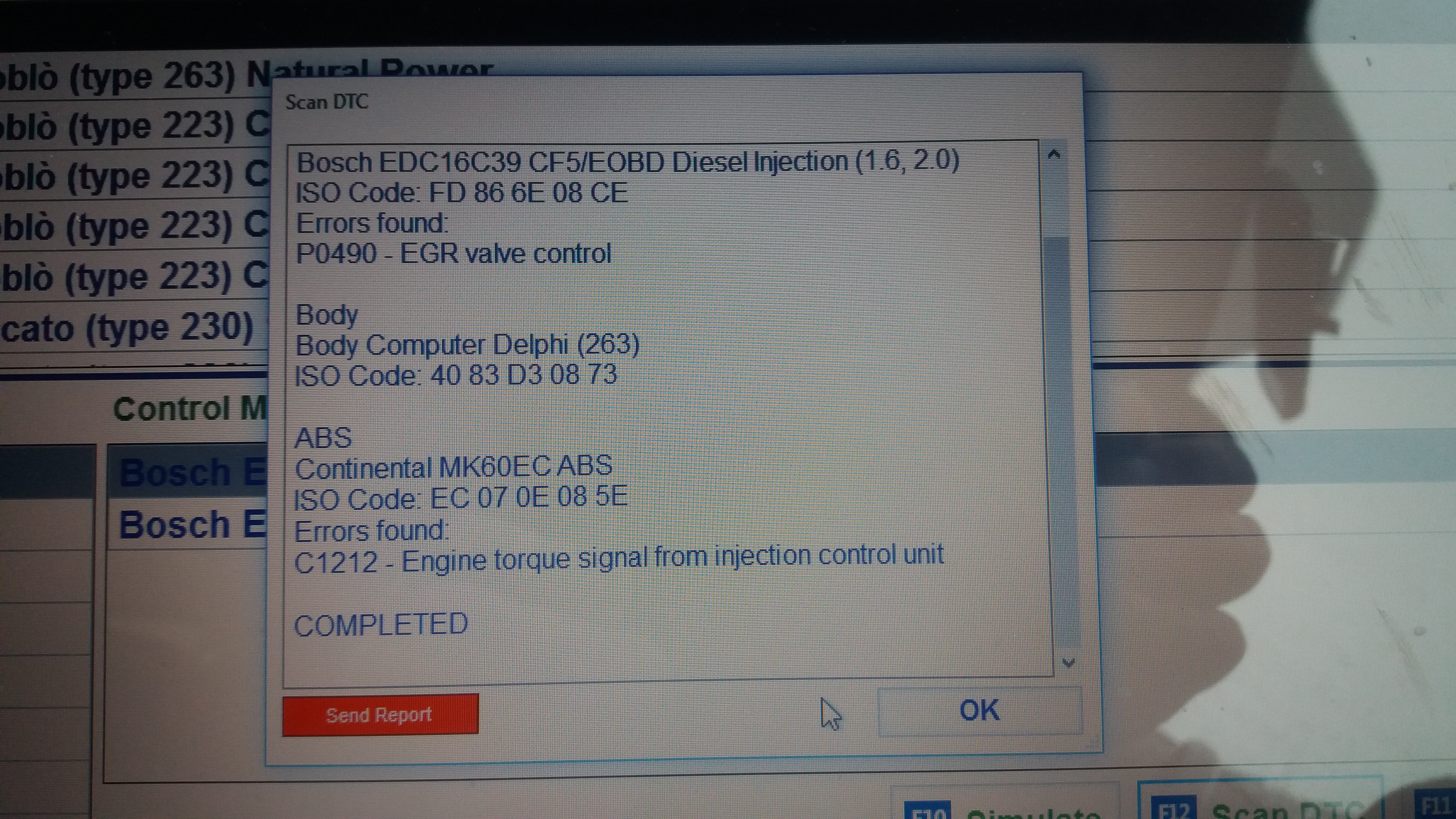

Can someone point me in the right direction to sort the following out please.

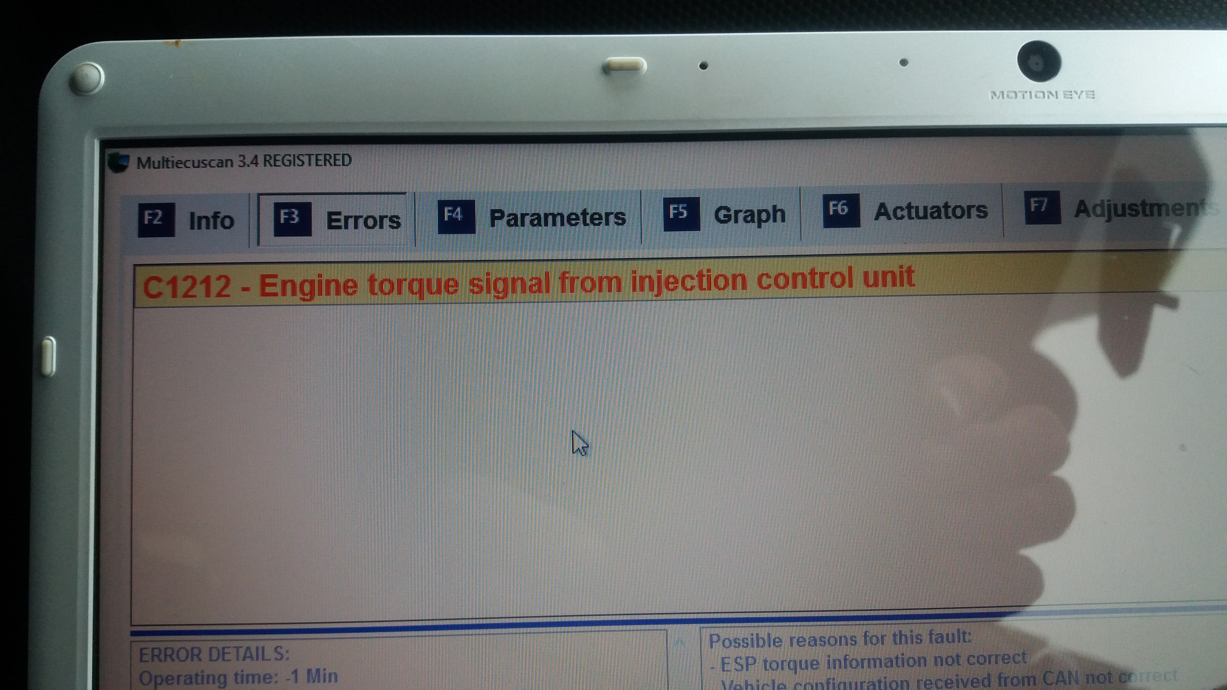

First I had an ABS light come on. This was a coil in the unit shorted to ground. A new unit is more than £1400.00 so eventually found a unit from the same vehicle from Italy. I fitted this and the ABS light is now ok but I have on the car warnings ESP fault.

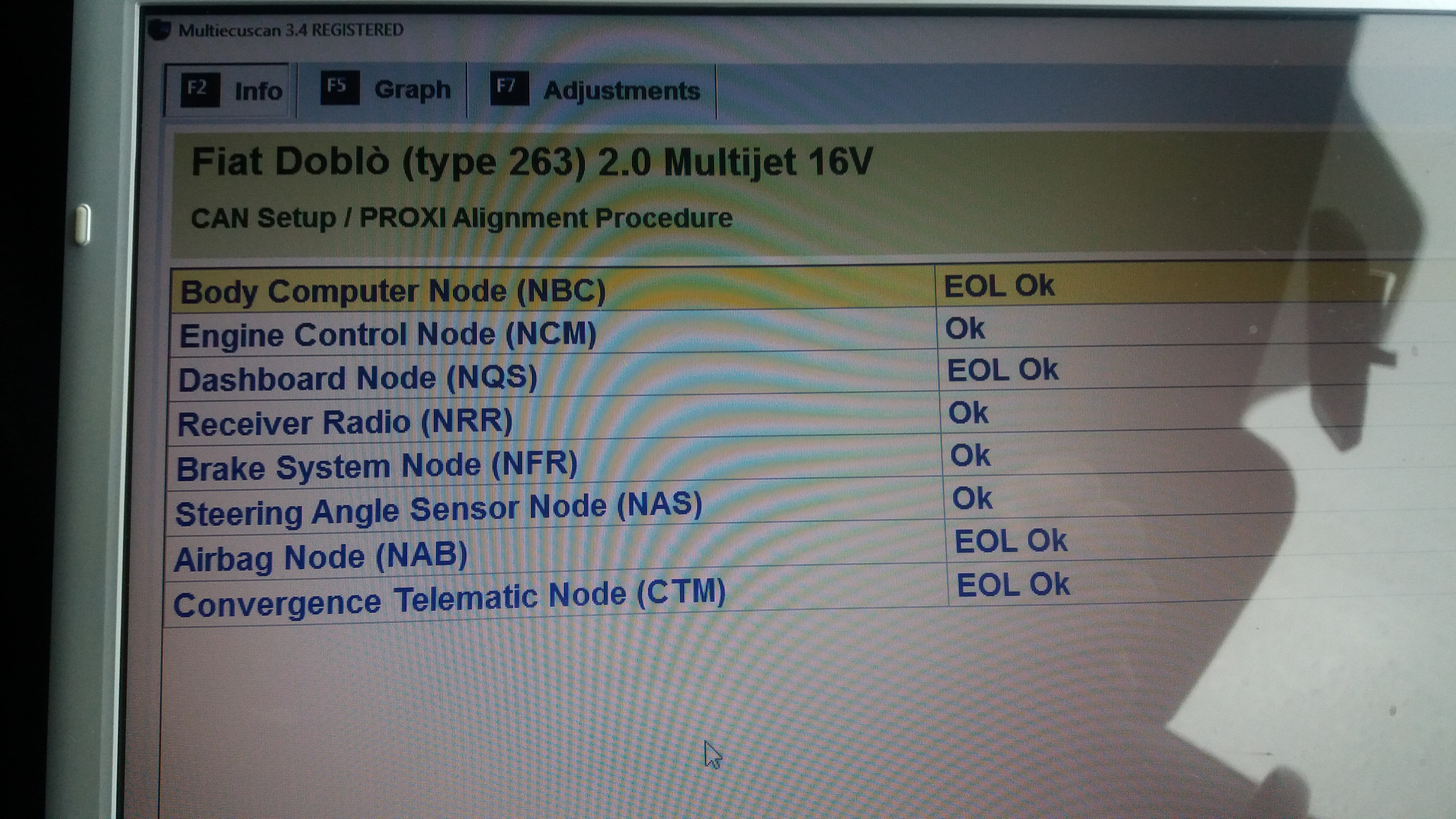

I am wondering if my car ever had ESP or if the unit I fitted does not have it. When I use Multiscan to go through the system I see nothing about ESP.
Below are my only error codes. The EGR one I have in hand as it needs a vacuume switch.
