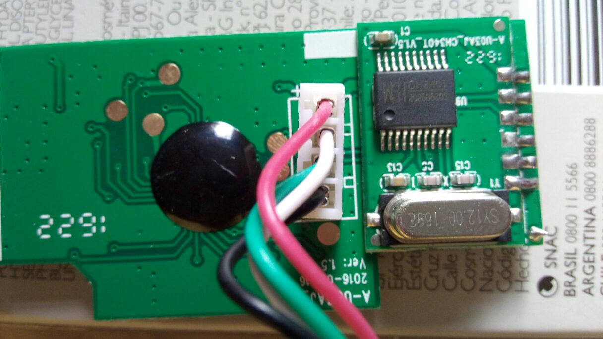

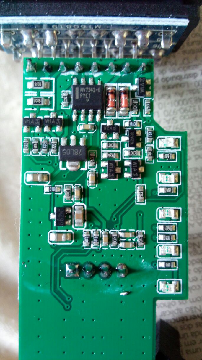

Re: FIAT STILO ELM 327 TIMEOUT
Good morning.
I would like to know which resistors would have to be removed from this board of my ELM327 cable to be able to use in the FIAT STILO 1.8 car
