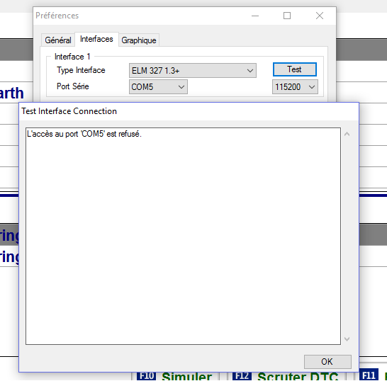

Hello !
I have download and install the good driver, and now, i have this error (in attachments)

I change the driver and I have this screen : all is OK.
But when i connect the car at the ELM327, my pc have blue screen with "Kernel Secutity Check Failure"
Complicated Mulecuscan ... :cry:
