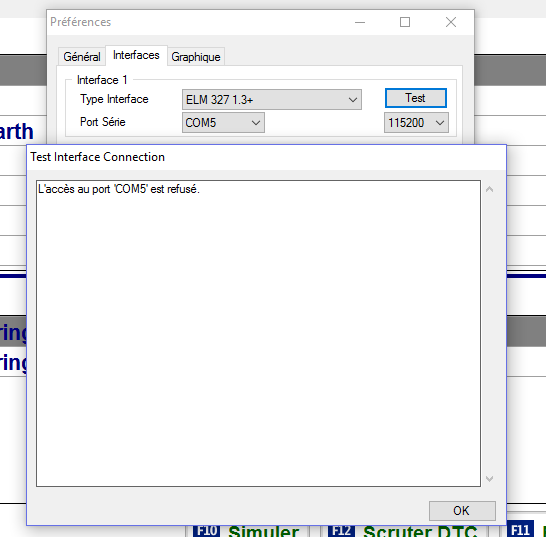

Hello !
I have download and install the good driver, and now, i have this error (in attachments)

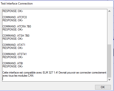

Hello !
I change the driver and I have this screen : all is OK.
But when i connect the car at the ELM327, my pc have blue screen with "Kernel Secutity Check Failure"

Hello !
It's good ! I found the good driver, and now, I can connect my car with elm327.
