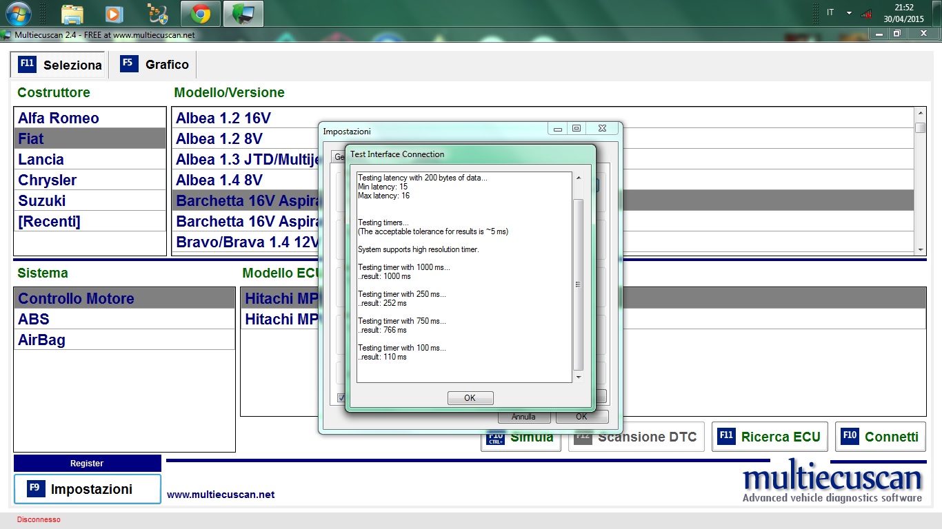

thank you for your reply, here the screenshot...
- mes.jpg (243.33 KiB) Viewed 7286 times

Hello Salvo
the Latency
min. + max. is too high
Open on the laptop the
Control Panel / Device Manager / Comport / Preferences / Advanced
and change there the Latency Time to 1 (previously 16)
Then try again to test
The Latency min. + max. should be below 10 ms.

Hello Eddy!
In this way finally I'am connected to the ecu!
thank you very much!
