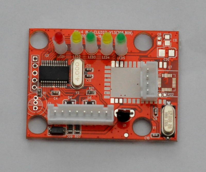

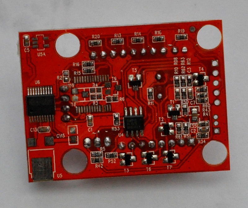

I bought an ELM327 USB V1.5a interface. I want an MES 2.4 registered my service interval reset Fiat Punto Evo 1.3 Multijet. If I test MES output is all ok .. If I want to connect, I can only check the engine. What am I doing wrong? Please help

- Back ELM.jpg (216.89 KiB) Viewed 3845 times
- Front ELM.jpg (197.76 KiB) Viewed 3845 times

Hai everybody,
I fixed the problem with the interface. I removed the resistor and everything works without a problem.
Thanks for the help and all the pictures i found on this forum.

Hi Richard
This board we have been here many times and I have the bridge resistor also highlighted several times.
You have to just browse many pages
