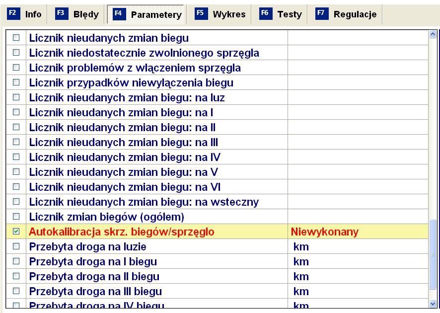

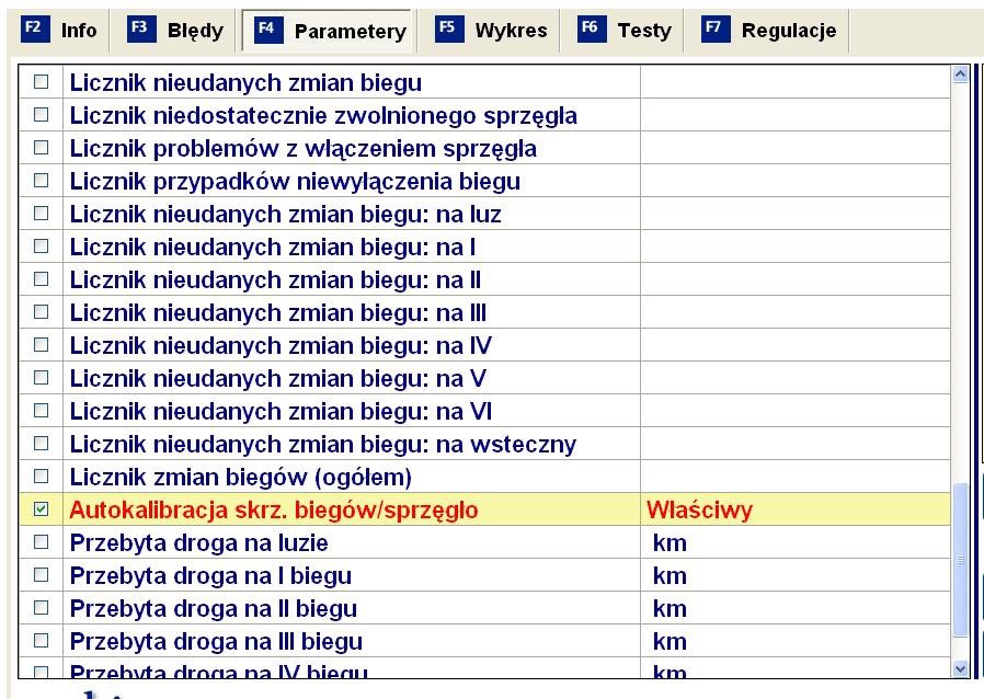

Fiat 500 after calibration gearbox remembers the settings to turn off the ignition.
after the calibration information is positive
no calibration after removing the key

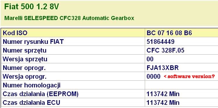

Panel info
Panel info
